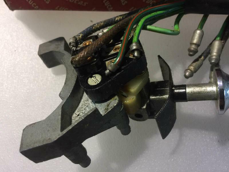

No sign of a plastic ring at all. It had two plastic arms that I think were activated by a finger-like projection on the steering column. Only part of one arm remains.
old turn switch.jpg (129.49 KiB) Viewed 2583 times
Re: Turn signal switch

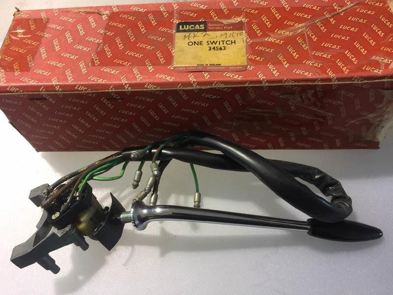

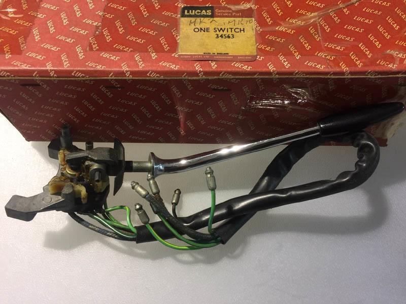

That is the older type mechanism AKA ~ C25255 or 34563. That plastic spring mechanism usually breaks requiring a new one to be riveted in. Lucas used to make repair kits with the plastic spring & 2 rivets. I have no idea if they were self cancelling. If they were they had a clamping ring on the column with a protruding "finger" for cancelling.
I believe this is that mechanism.
Repair kit.

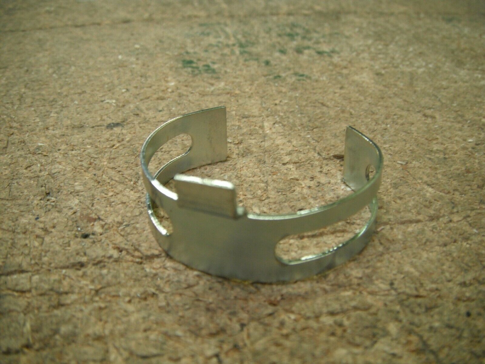

Indicator Cancel bracket
Indicator cancel bracket.jpg (210.32 KiB) Viewed 2574 times

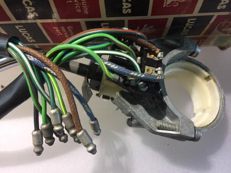

Rob ~ You have a late car. What mechanism do you have?
This is what I have & is my NOS spare. My original shows some wear but I only located this NOS unit after my car was finished. I was delighted because sun exposed plastic parts become brittle & break.

Glyn Ruck wrote: Fri Mar 27, 2020 2:25 pm Rob ~ You have a late car. What mechanism do you have?
I don't have a picture of mine but I am pretty sure without taking the cowling off that mine is the same as in your photo Glyn.
I'm pretty sure you are right Rob. Please don't go to the trouble of removing the cowling.
