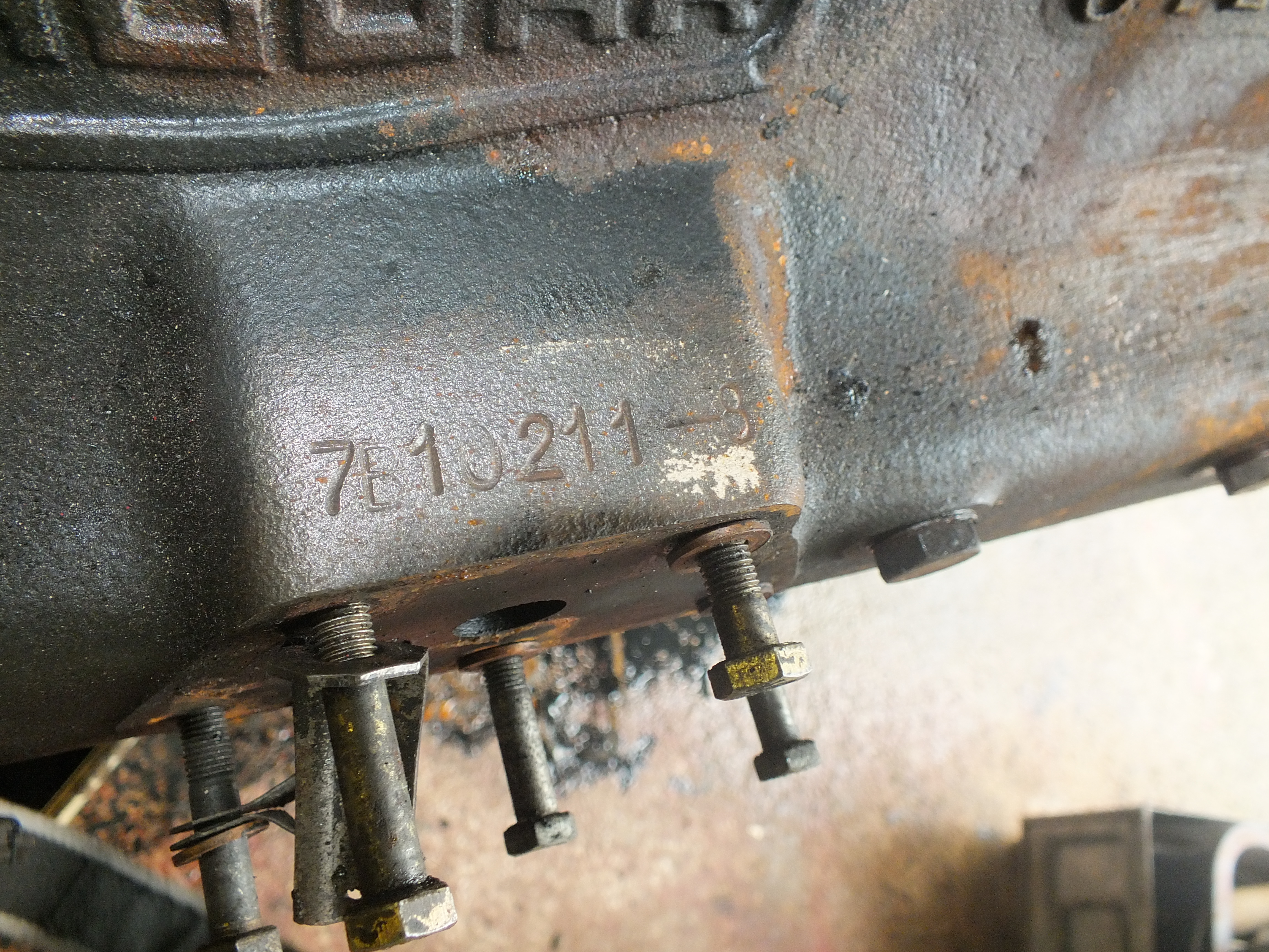

The S Type engine was certainly prefixed with 7B. The engine number is often on early cars stamped twice on the engine. On the head behind the front valley but heads can be changed and the second place is on the side of the block above the oil filter housing. (see photo). My 1967 does not have the engine number on the head.
Engine number 7B 56487-9 Should relate to a 1965 S Type. 7B was just for the S Type engine. The final suffix -9 donates it is a 9:1 compression ratio which would suggest it is a LHD American export vehicle but if you gave me the chassis number I might be able to pin it down more.

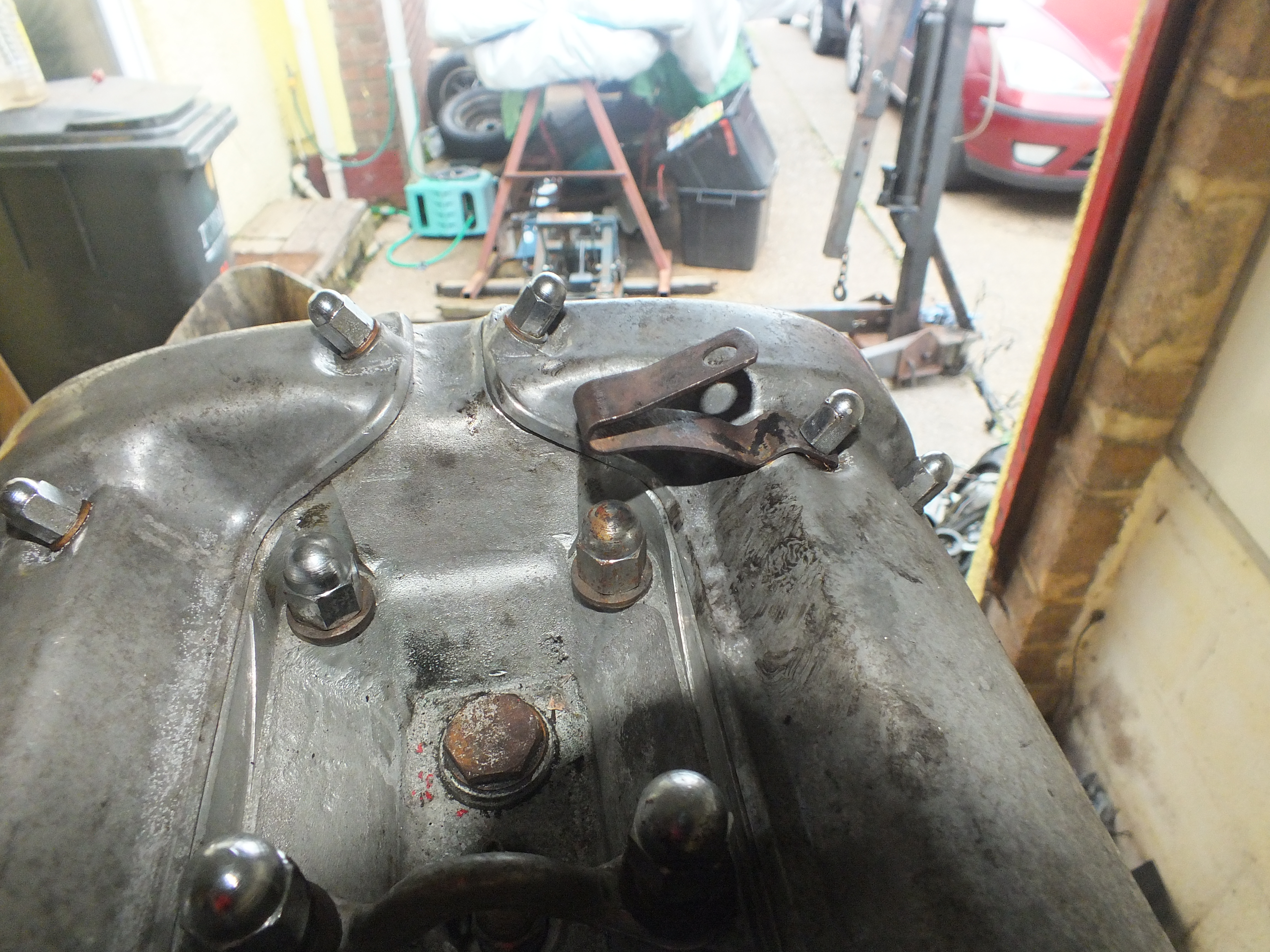

An engine with 7D would relate to a 4.2 engine from a Mk10 or 420G. To check what CC your block is look on the right side of the engine just behind the distributor and it will be embossed on the block either 3 1/2 litre. 3.8 litre or 4.2 litre. (see photo).
The VIN plate can be changed to read what ever numbers you want as they are readily available to buy, stamp and rivet on to the bulkhead in place of the original. I am not sure a 4.2 head would fit on the 3.8 block as the water ways might not line up. The 4.2 had a different inlet manifold with triple carbs.
The best way to check your numbers are correct would be to apply for an Heritage Certificate from Jaguar Heritage. https://www.jaguarheritage.com/archive- ... tificates/ This will give you all the original numbers, colours and first owner in some cases or at least where it was distributed.
