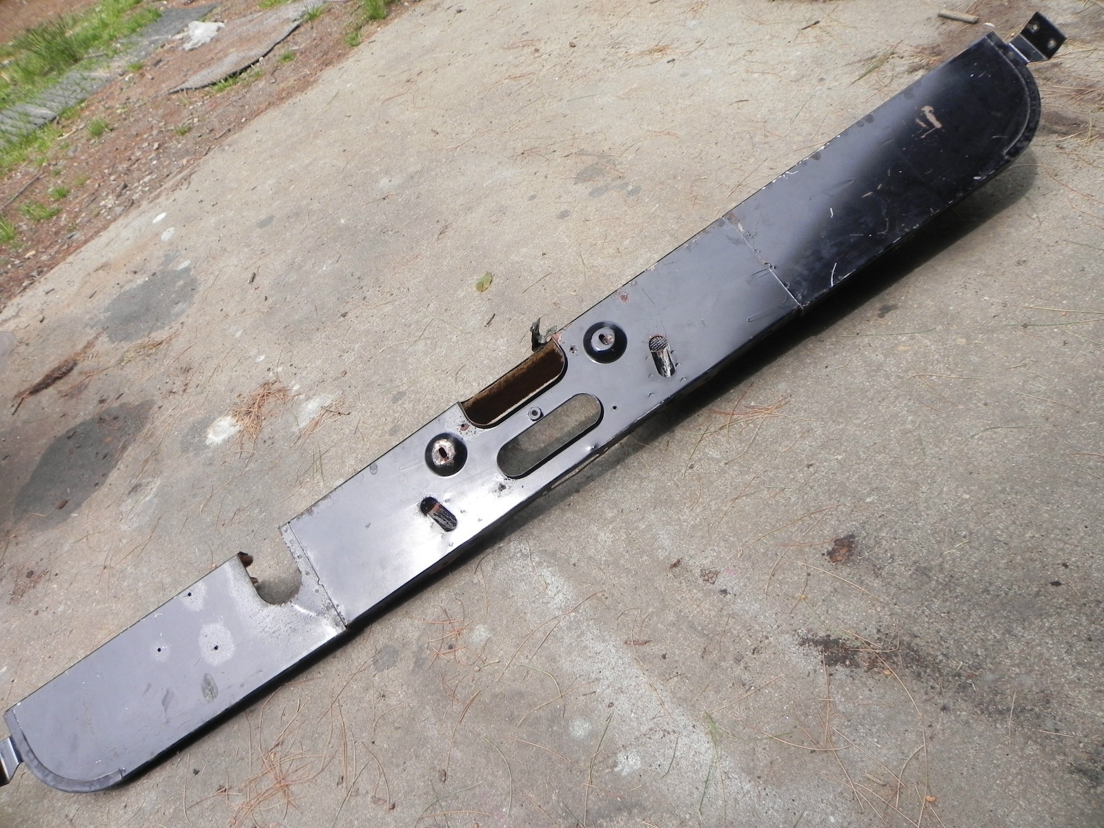

It has not been mentioned but on my radio there are two thumb screws which are on the parcel shelf either side of the metal grill which screw into the metal frame the radio sits on. The screw holes for these thumb nuts can be seen in the photos already shown. If you remove these thumb nuts it allows the front wooden radio panel to be removed with the radio still attached. The thumb screws are the same as those that hold the fuse/gauge panel in place.

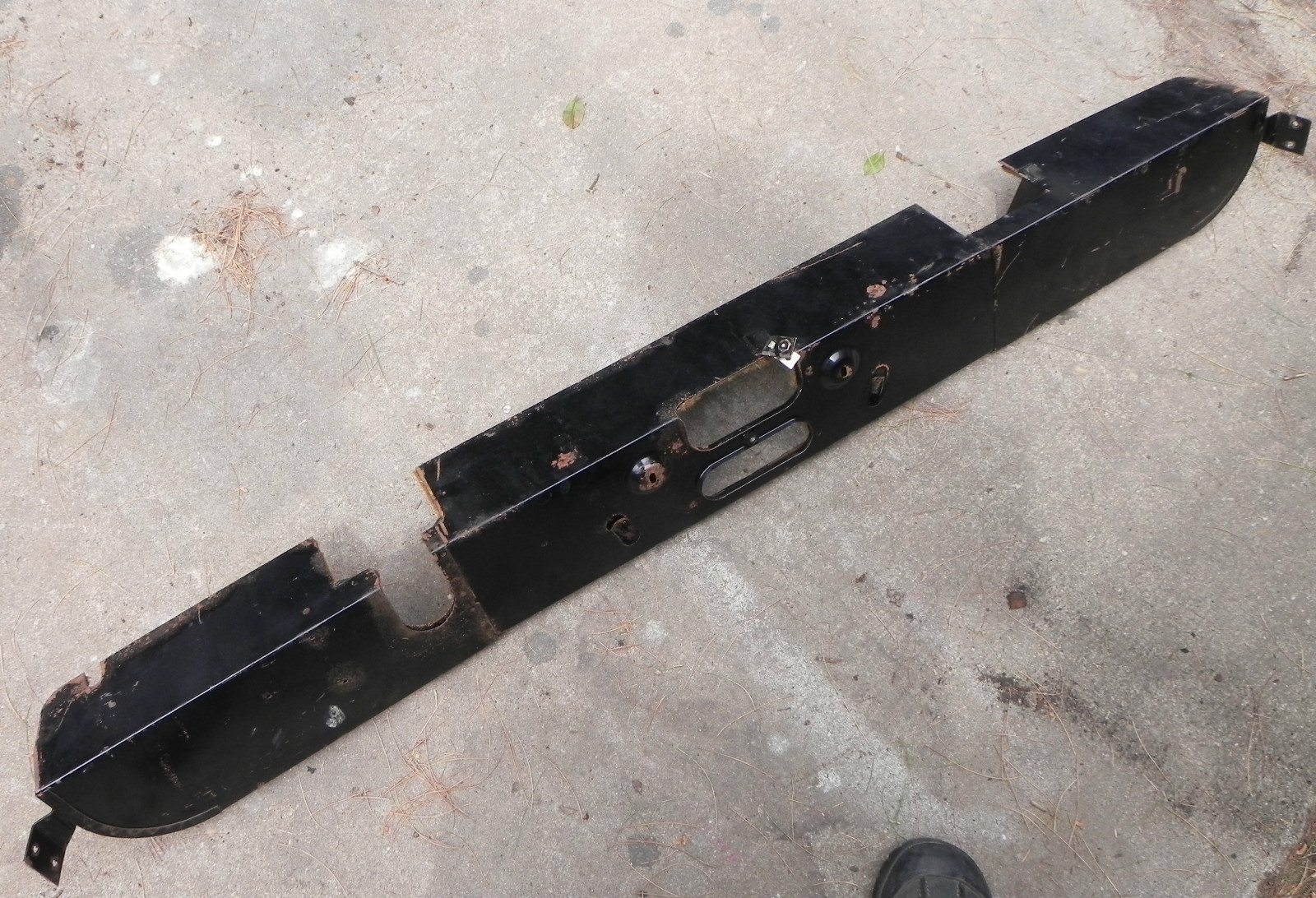

if you look at the picture of the radio brackets, there is a center threaded "ear" on each bracket top.
Do those ears line up with the thumb screws you are referring to?
my car does not have them and there are no signs or holes.
maybe it was a later improvement?
Re: Jaguar S Type MOD 1965 bought June 2018
Yes those threaded holes line up with the thumb screws. Under the parcel shelf carpet either side of the chrome grill there are two dimples which the heads of the thumb nuts fit into. These then screw down into the two threaded holes on top of the radio bracket to hold it in place. Attached are a couple of photos showing my thumb nuts in place.

my carpet is glued in that area, no signs of anything going through it! however I do remember the dimples were there when I removed the console and parcel shelf, but there were no thumb screws. I just didn't know what the dimples and the holes were for.

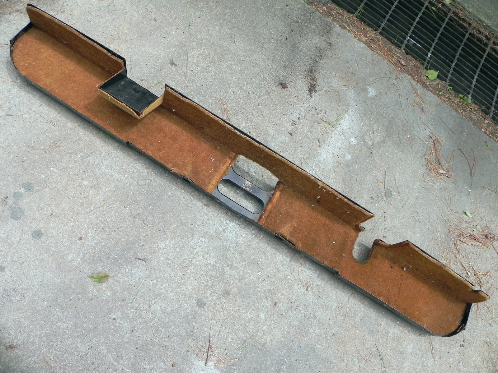

All 3 of my cars (2 donors) have the same parcel shelf as Rob's (all 1965/66 era) ~ with the 2 thumbscrews.
The chrome vent over the radio is held down by 4 plastic rivets (some clear, some black dependent on year) that push into drillings & trap the carpet. It is intended that you pop off the chrome vent & raise the carpet for access. Heater vent control cables also run there.
Many restorers erroneously screw down the vent cover with self tapping screws. Others place the vent tabs under the carpet. Both wrong!
