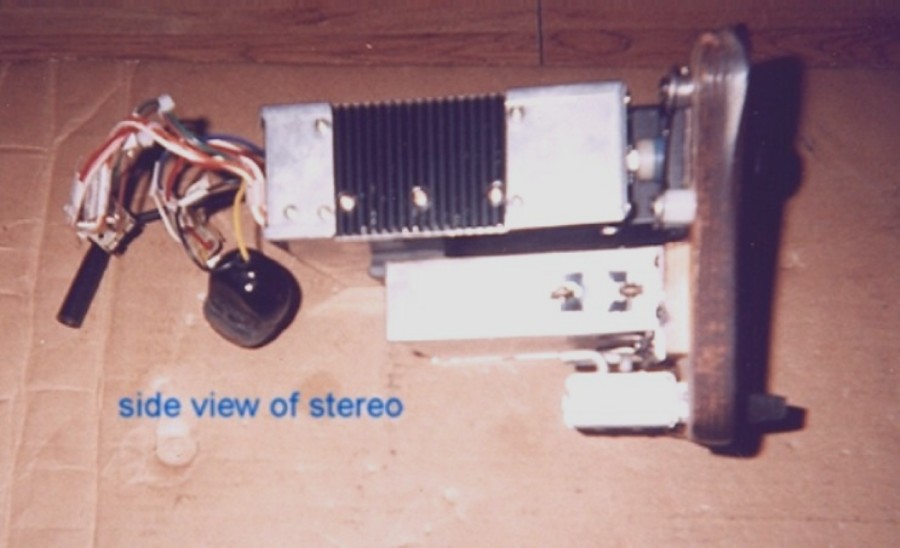

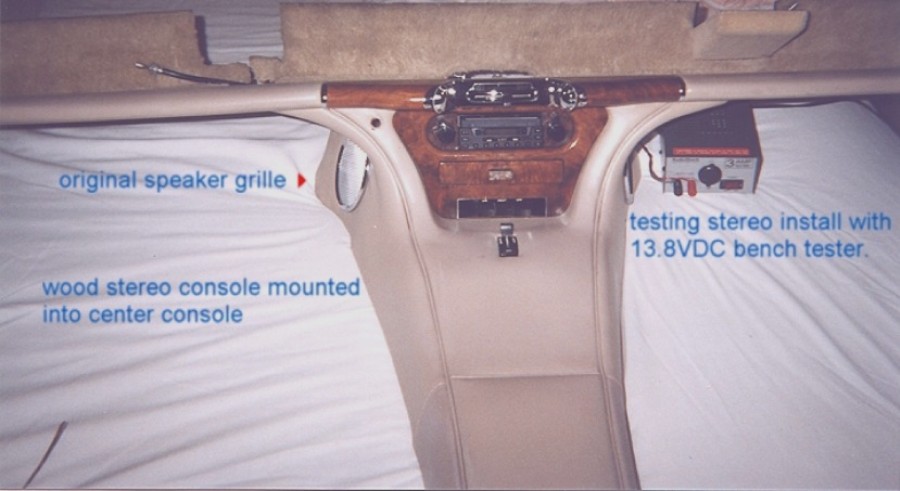

I replaced my original AM radio by removing the entire center console complete with the parcel shelf attached, because I wanted to add new speakers and baffles to each side of the center console, and this required moving / remounting the rear seat's air vent on-off Valve further to the rear.
as it came from the factory, the Valve is smack in the way of a second speaker, so it required careful surgery but I did it.
I installed the am-fm-cassette radio from my 1984 XJ-6 which I had replaced with a 1986 unit. Yes I
still play cassettes, don't like CDs.

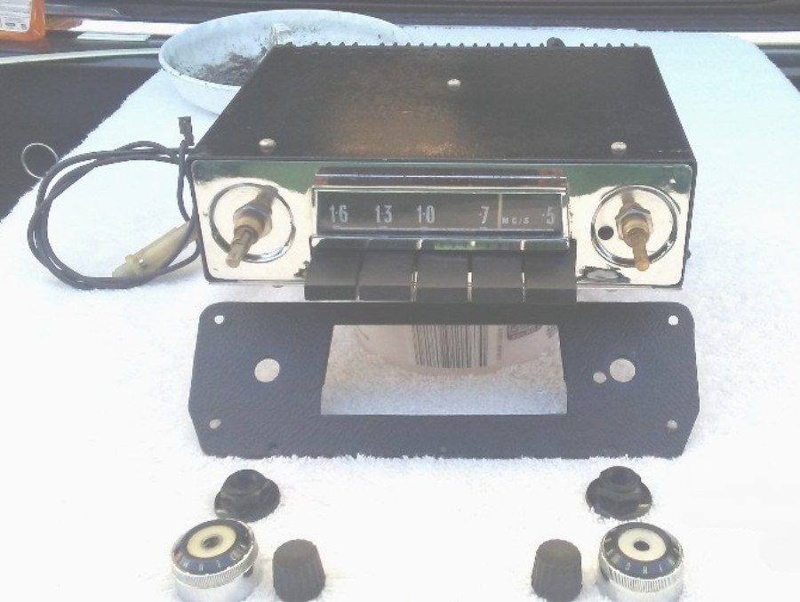

I went the originality route with a brand NOS LW/MW radio & powered hidden antenna. 1 speaker.
