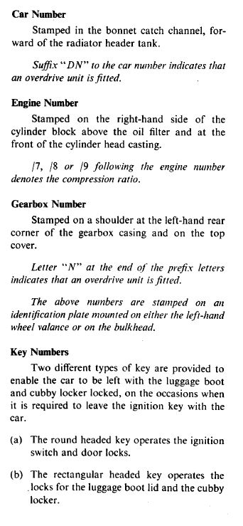

Nothing tells you whether the gearbox is Moss or Jaguar other than it's stamped number on the box & Plate on the firewall. The DN suffix ~ if my reading is correct tells you it has Overdrive fitted ~ DN = DeNormanville. (as in Laycock DeNormanville) As in P 1B xxxxx DN

The attachment will tell you where to fond all of the numbers and what they mean.
Where to Find the Numbers.doc
Where to find the numbers
(27 KiB) Downloaded 309 times

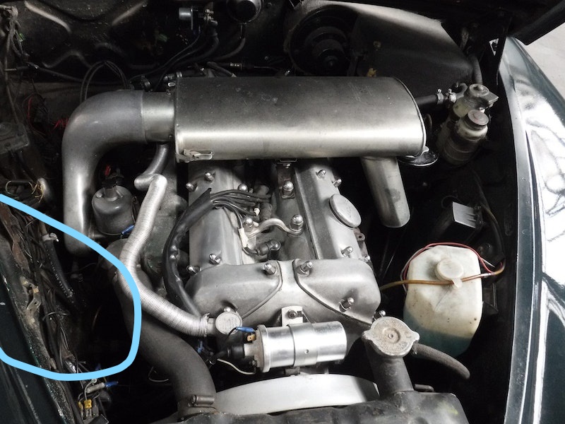

Other question, here are some receptacles missing on the left side, somes are on the other side, but the Fuel filter(?)/Receptacle is missing, no ?
The battery has been moved to the trunk/boot (I guess to avoid the heat ?)
Pce manquante moteur .jpg (777.2 KiB) Viewed 1983 times

Normally the clutch and brake fluid reservoirs are on the same side as the carburettors in a RHD car. I am not sure about a LHD car but the small metal bar on the left is normally what the reservoirs hang on.
The previous owner might have put an in line fuel filter in place of the glass bowl filter possibly to remove the filter and possibility of leaking fuel in the engine bay.
LHD 3.8s numbers should be between 67000 and 80500. 1966 cars should be between 77000 and 87000 approximately.

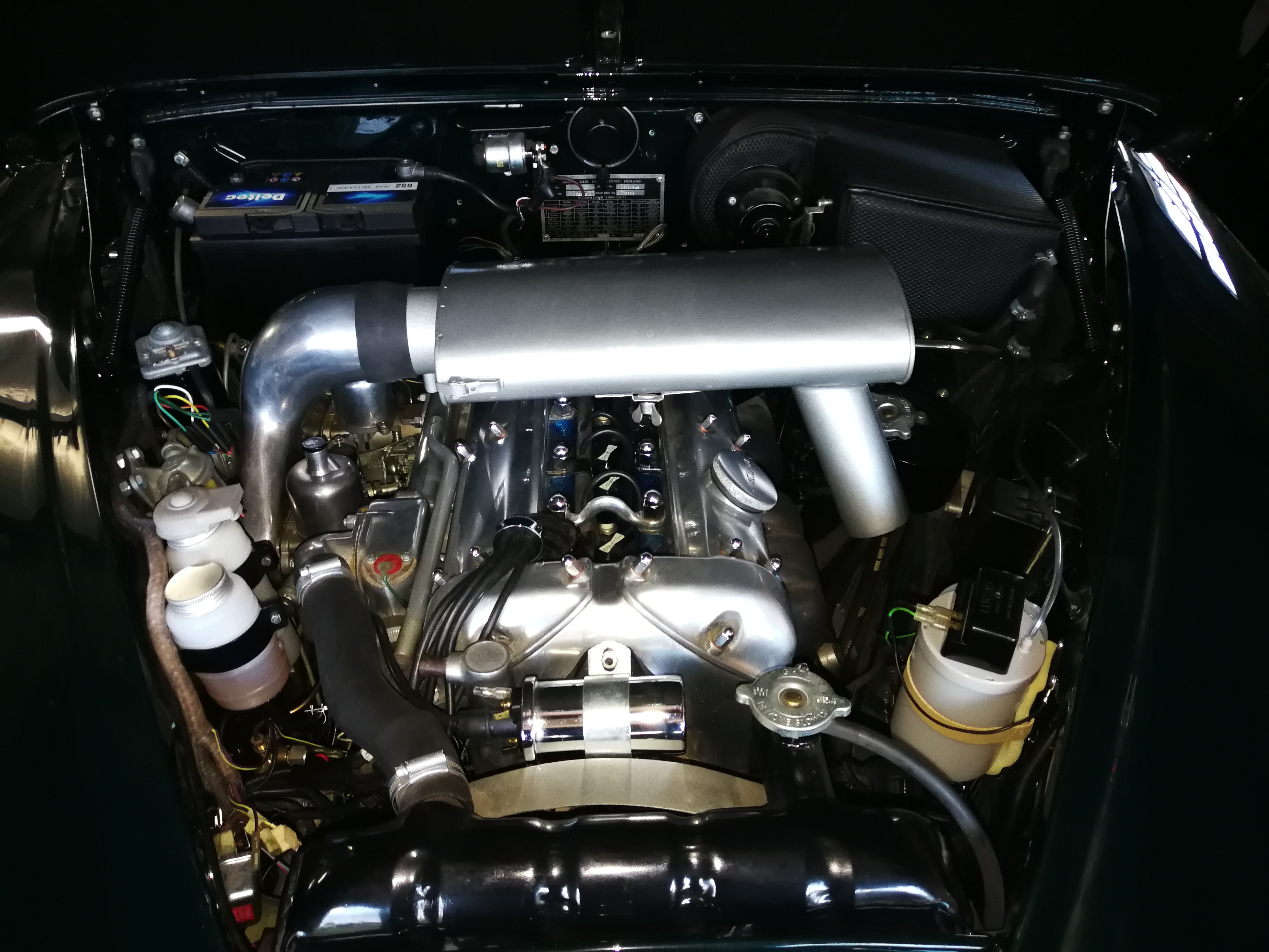

This is the lay out of my engine bay of my 1968 RHD 3.4s automatic as it was stock. I have since altered a couple of things.
