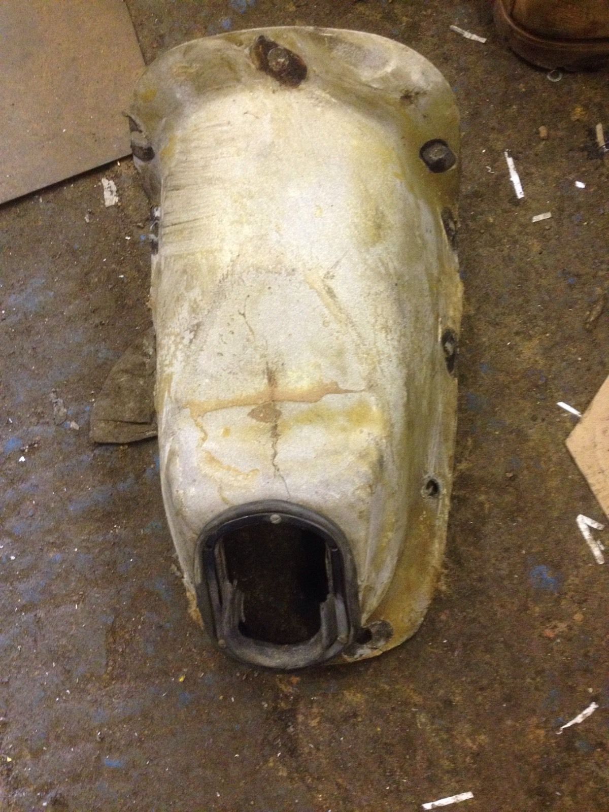

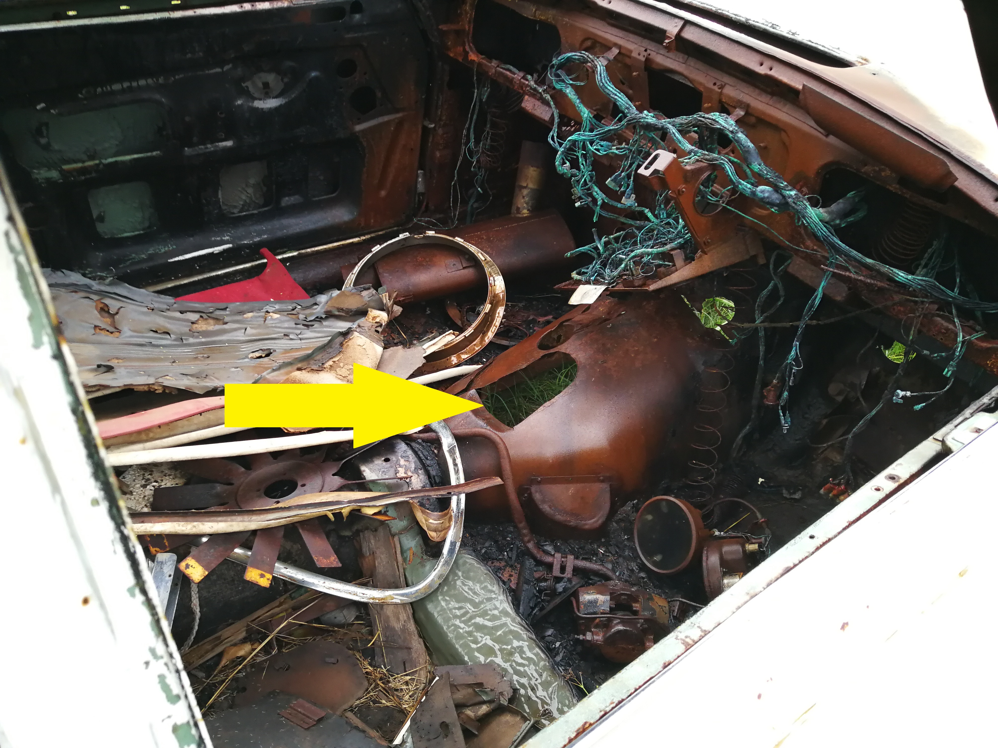

Many BW automatic cars have been converted to Manual OD (DN) because its quite easy but never looks right. They have a wider tunnel for the Auto but you can cut a hole in it for the gear lever & while it is wrong it's covered by the console. The pedals are easy to change to give you a clutch. This was one of my donors that got caught n a brush fire lying on the ground ~ what a mess. Fortunately I had all the bits I wanted from it but a nice set of instruments got destroyed.Fredomusicman wrote: ↑Sun Nov 06, 2022 8:16 am Hi,
For the first one (BRG): I still not have the VIN, but he says it's BW and should be DN. Yeah clear.. May be it was also a 3.4L ? And went from RHD to LHD ? Not clear at all... Engine number is 7B65046-8. I found nothing on Saloon.collectordata or XKdata. But 7B for S, 5 digits for 3.8L and 8 for compression, but from/for which car ?![]()
Like this.
This is what a Manual should have.
