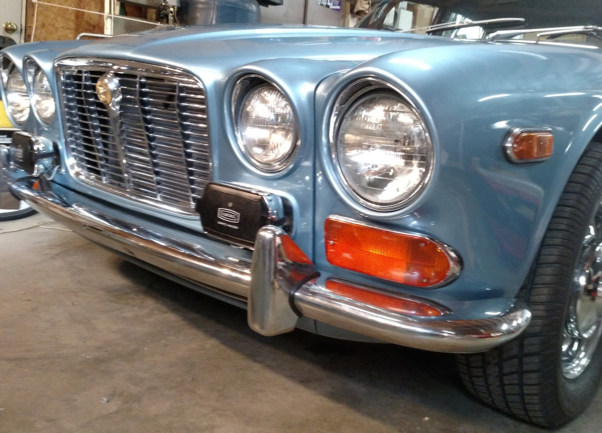

This is my Series 1 if it's any help. Sorry but unable to rotate the side on photo.
- IMG_20200117_125159.jpg (3.99 MiB) Viewed 4959 times
- IMG_20200117_125206.jpg (3.34 MiB) Viewed 4960 times
Re: Rear Bumper over rider.
OK — thank you — so they're obviously XJ Series 1. How annoying. I've got some other ones buried deep in the shed which came with the car (except those bumpers are clearly not actually from my car as there's no radiator-grill dip in the front one!) which I will dig out after winter when all the garden furniture is out of the shed again. Are over-riders easy to swap?! From memory the over-riders on the 'spare' bumpers are closer to what they should be.

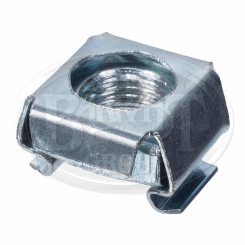

The original bumper over riders & side brackets came fitted with captive/caged nuts that look like this. Jaguar calls them "grip nuts" in the parts catalogue. You can see their P/N's in the tables I posted earlier in this thread. As Rob says the damn things rust into a single blob behind the over rider webs. I cut out my over rider webs, cleaned everything up properly. Fitted new plated grip nuts, Rewelded the webs & then sent the over riders for re-chroming. They are a PIA!
