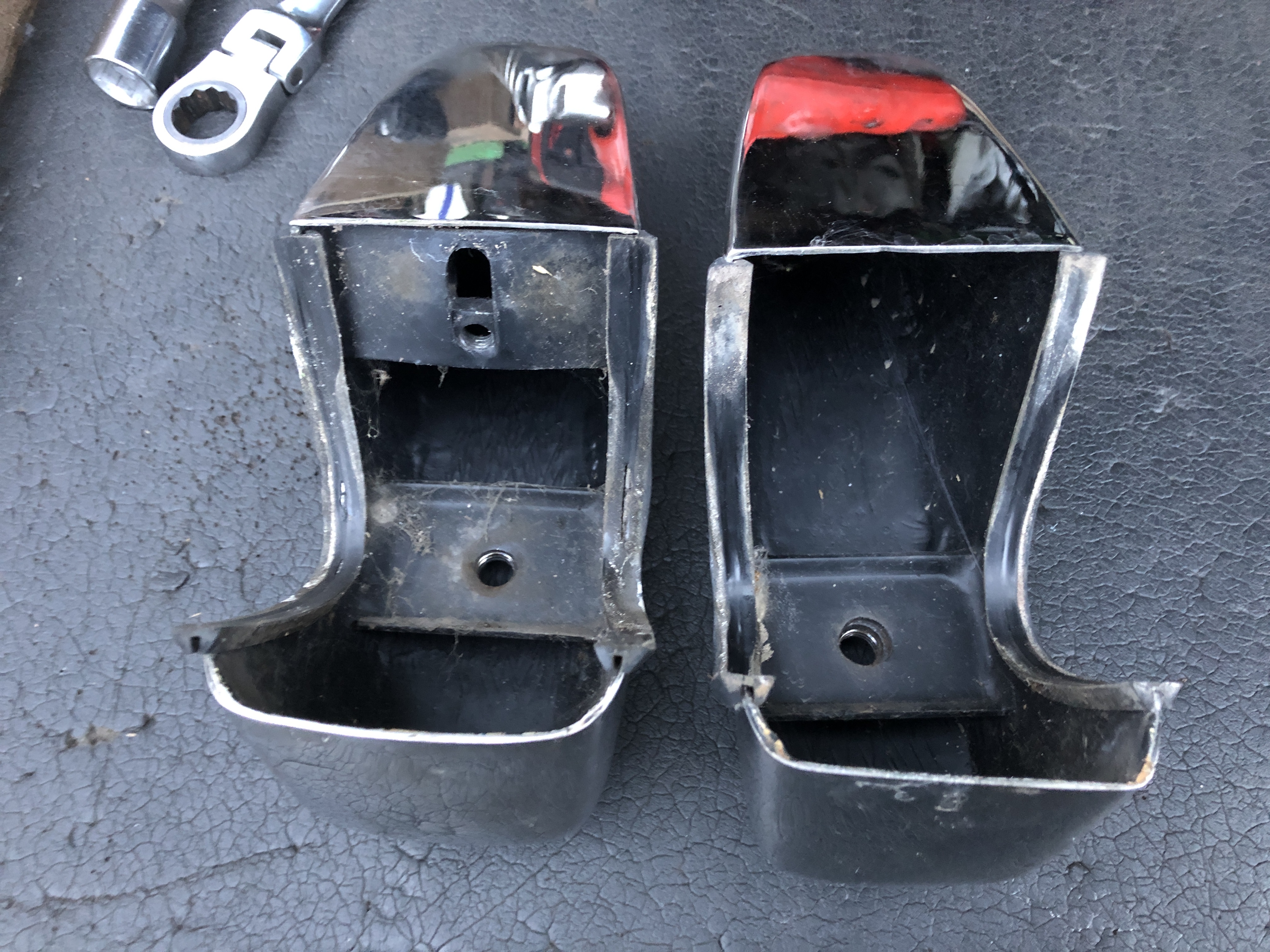

Rob. I will try to have a look tomorrow in the other garage, I was given a box of old bits & pieces with my S Type I believe there are over riders in there but not sure if front or rear. The rear will have two holes in going by your thread.

That's right Dave the rear over rider has two bolts holding it in place.
In the picture the left one is for the rear and the right one is for the front.
Thanks for looking and lets hope you have one spare rear and not a box full of fronts.

Hi Rob, I have found a rear over rider in a box of S Type parts it's intact rusty inside but is sound the cut off bolt removed from the bumper is loose in the bracket. I have an email address for you at Blueyonder.co.uk is that still live, if so I will send some photo's through and not jamb up this thread up anymore. If it will do the job I think Hermes is the cheapest way for me to send it to you in Devon.

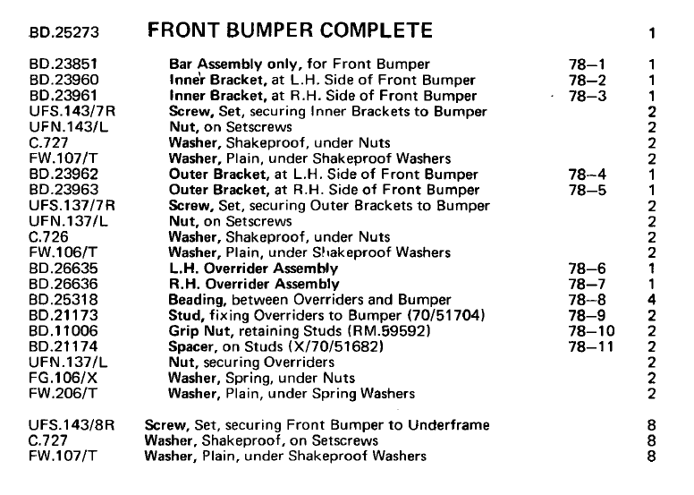

Rob, I noticed your over riders a long while back but decided to let sleeping & happy dogs lie. I'm here to try & help & not to criticise people's cars.
Just be careful. There are LHS & RHS over riders for both back & front. i.e. 4 different over riders on the car with different part numbers.

Understood Rob. If you try & swap LHS for RHS etc. they don't fit properly & sit at the wrong angle.

Rob. I didn't realise until reading Glyn's reply that there are four different over riders for front & back. Are the part numbers on the over rider or do you just do a comparison when fitting to the bumper for best fit when secondhand.

Dave. I rechromed my over riders twice due to defects (dirt) in the chrome. I cut out & re welded the webs to clean up & replace the rusted caged nuts with new & plated. There are no part numbers anywhere. Fit by comparison. Correct setback & direction forwards & rearwards.
