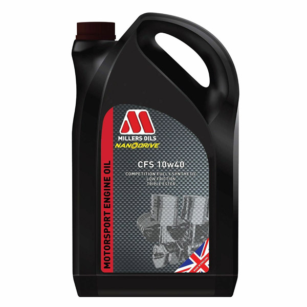

Hi folks.
I thought I would report back on this thread with my experience of using Millers 10W40 full synthetic engine oil since May 2020. Following the recommendations in this thread - and the fact that the oil specifications in the user manual/chassis plate don't specify anything higher than a 40 weight oil - I had to try it out for myself to see if a 10W40 would give me sufficient oil pressure.
On the way home from the service and oil fill, with a new filter, oil pressure just reached 40psi at 3,000rpm. Although I haven't used the car much this year, whenever it has got really hot - after heat soak - pressure does not quite reach 40psi at 3,000rpm. That said, oil pressure did not get worse over the six months I ran the car in 2020. And the engine is no noisier. But the low oil pressure worries me!
Millers are quite a respected brand in the UK and produce a wide range of oils. Here are the specs for the one I used: https://www.millersoils.co.uk/wp-conten ... 0w40-3.pdf. Note that this particular oil doesn't have any manufacturer approvals, but Millers produce plenty of other oils that do.
My conclusion is that, for whatever reason, a 40 weight oil is not sufficient to give my engine decent oil pressure. The reasons may be:
1. It gets very hot under the bonnet, particularly during heat soak, maybe because of modern fuel or maybe for some other reason(s). Coolant temperature on the gauge sits at more or less 70C, so the coolant circuit would seems to be okay.
This earlier post details what happened in 2018 when I used a mineral 20W50 which, according to the analysis at the time, fell out of grade after 500 miles in my car: http://jagstyperegister.com/forum_new/v ... 3430#p3430. Apparently the most likely reason for this is that the oil got too hot.
2. The engine was rebuilt in 2014 with a remanufactured standard oil pump. It's done 9,300 miles since then. Not sure whether this might be underperforming.
3. I'm fairly happy that the gauge is accurate. It is a new one with matching sensor from Caerbont Instruments: https://www.smiths-instruments.co.uk/jaguar. And the oil analysis in 2018 seems to suggest it tells the truth.
4. Ignition. Well, it is a possibility that the ignition is too far retarded at some points in the rev range, I guess. I am using a 123 Distributor and none of the 16 curves really get that close to the original distributor curve. Maybe I need to invest in one of the latest versions that allow you to set the curve you want.
So, my thinking is that in future, for my particular car, I will stick with a synthetic, but choose one of a higher weight - 10W50 or 10W60. It seems a cheaper/easier option that pulling the engine apart!
I'd appreciate any comments and observations.
