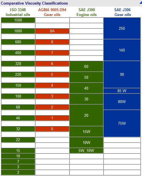

Different viscosity classifications apply to different product applications. See below. e.g. An SAE 90 gear oil is of similar viscosity to an SAE 50 engine oil.
Comparative VG.JPG (62.96 KiB) Viewed 4205 times
