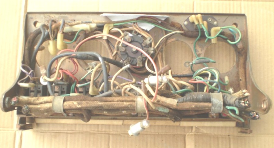

I have 2 salvaged Center panels, one from 1964 and one from 1966, and my own car from 1965.
Neither has any Resistor at the headlights switch. This must be a LATE (1967-1968) addition?
What I do notice in the 1966 salvaged panel that I do not have in my car, or in the 1964 salvaged panel, is an inline fuseholder at the top
of the panel and I have no clue what it is for.
See picture below of the 1966 salvage panel wiring and you will see the fuseholder, you can also see the Headlights switch (this one is a Fog Lites switch), there is no Resistor.

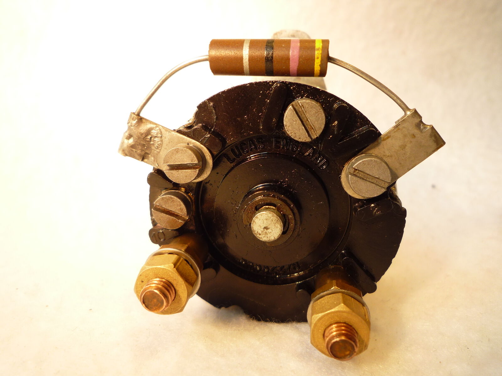

Yes I have the resistor on mine which is a three position light switch 67/68 car.
OK I will just through this one out there. How do you check if the resistor is functioning correctly. I have a multimeter to check the voltages and a power wand to put power in to the resistor but what readings am I looking for to check it is working correctly?
Re: Shifter Quadrant / Nacelle Light
Assuming all else is equal, I wonder what happens if you remove the resistor?

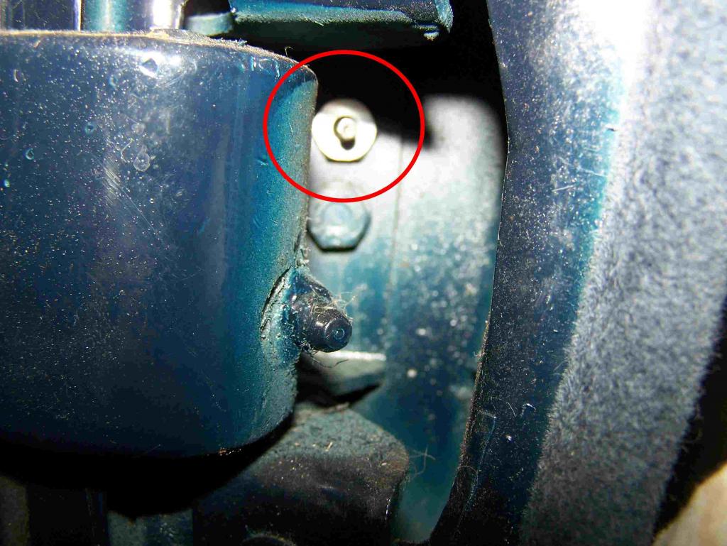

Alan ~ the front courtesy light switches are in the lower front door hinge. I will try & find you a pic.
EDIT: Here we go ~ old internet pic.

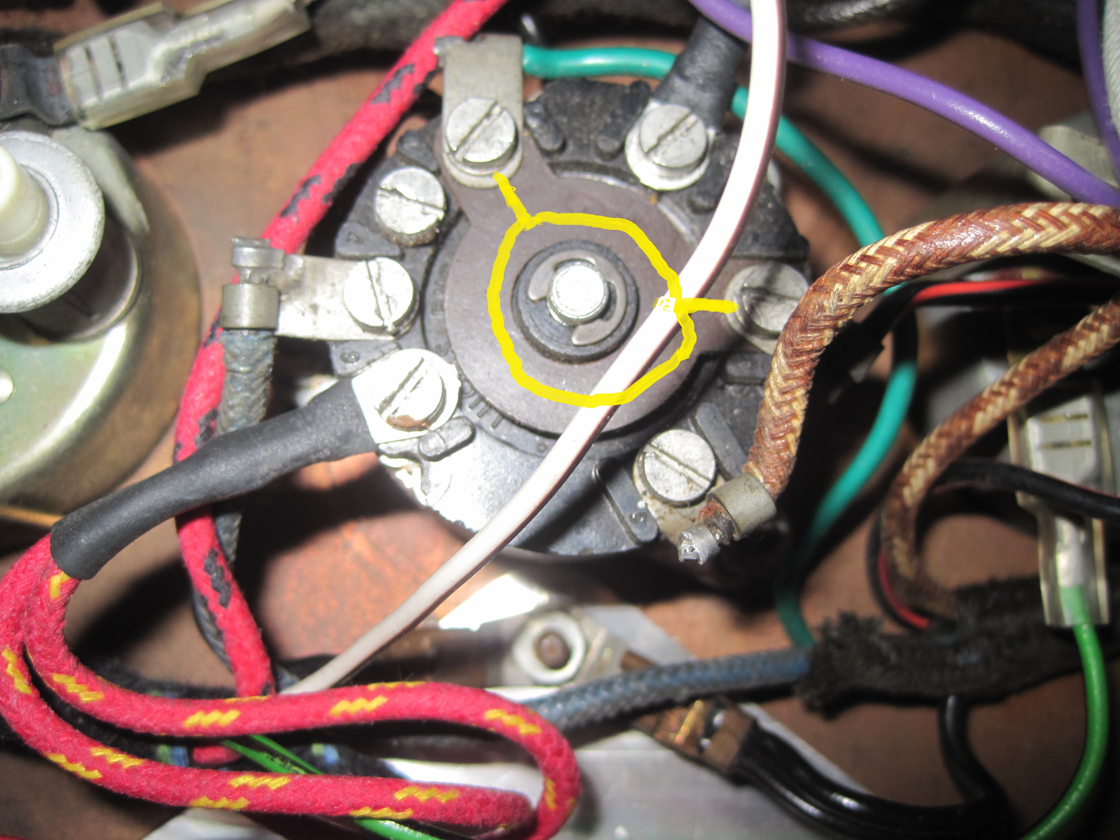

Jose ~ the resistor is in your picture shown above. You just don't recognise it. Same as Alan's
Flat disc with 2 tabs. These light switches have had resistors back to the 50's
s type light switch 004.JPG (1.89 MiB) Viewed 3215 times
Glyn I see no resistor. ohh you mean that flat plate is the resistor? I was looking for a RESISTOR like in your picture
