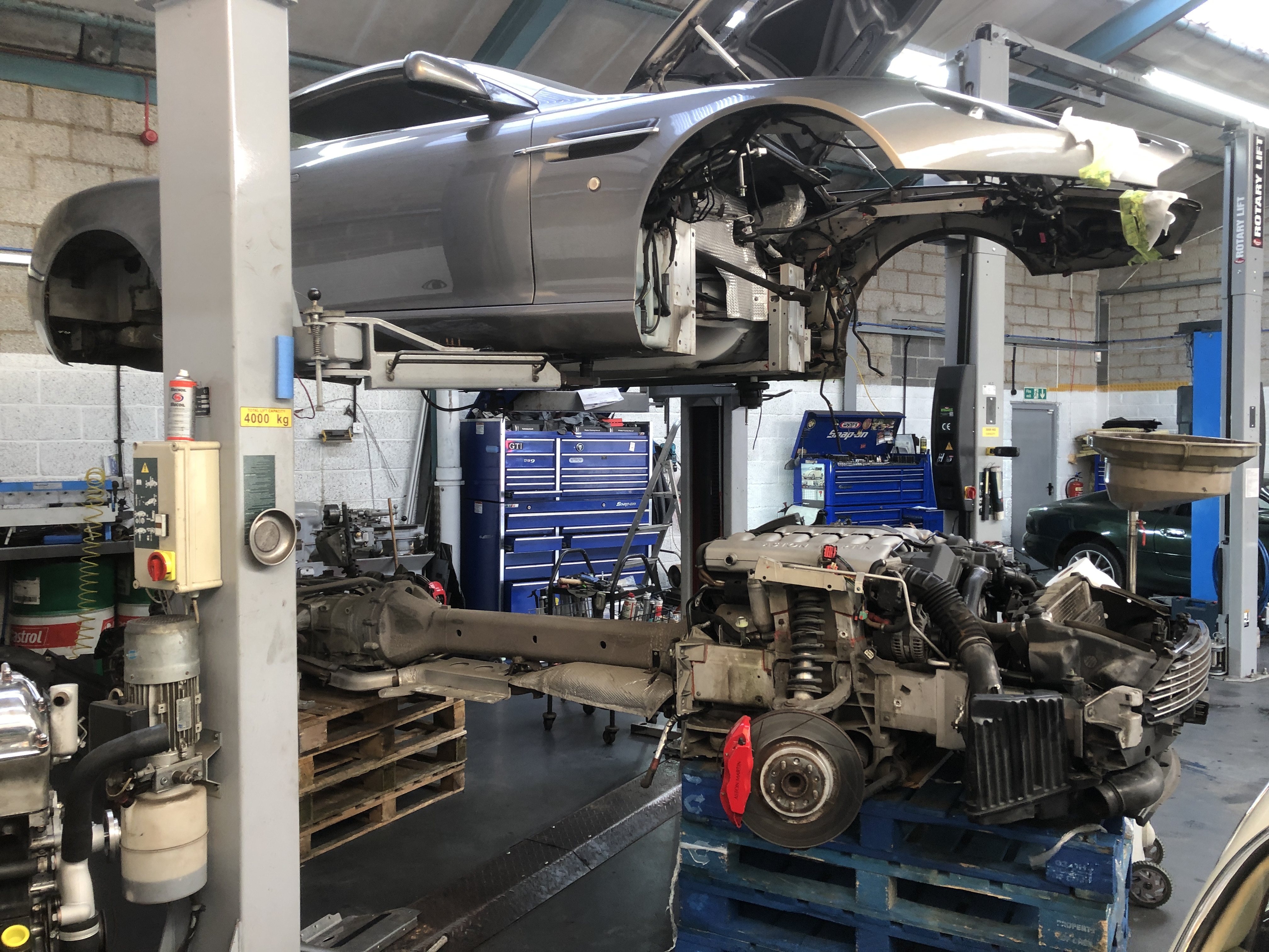

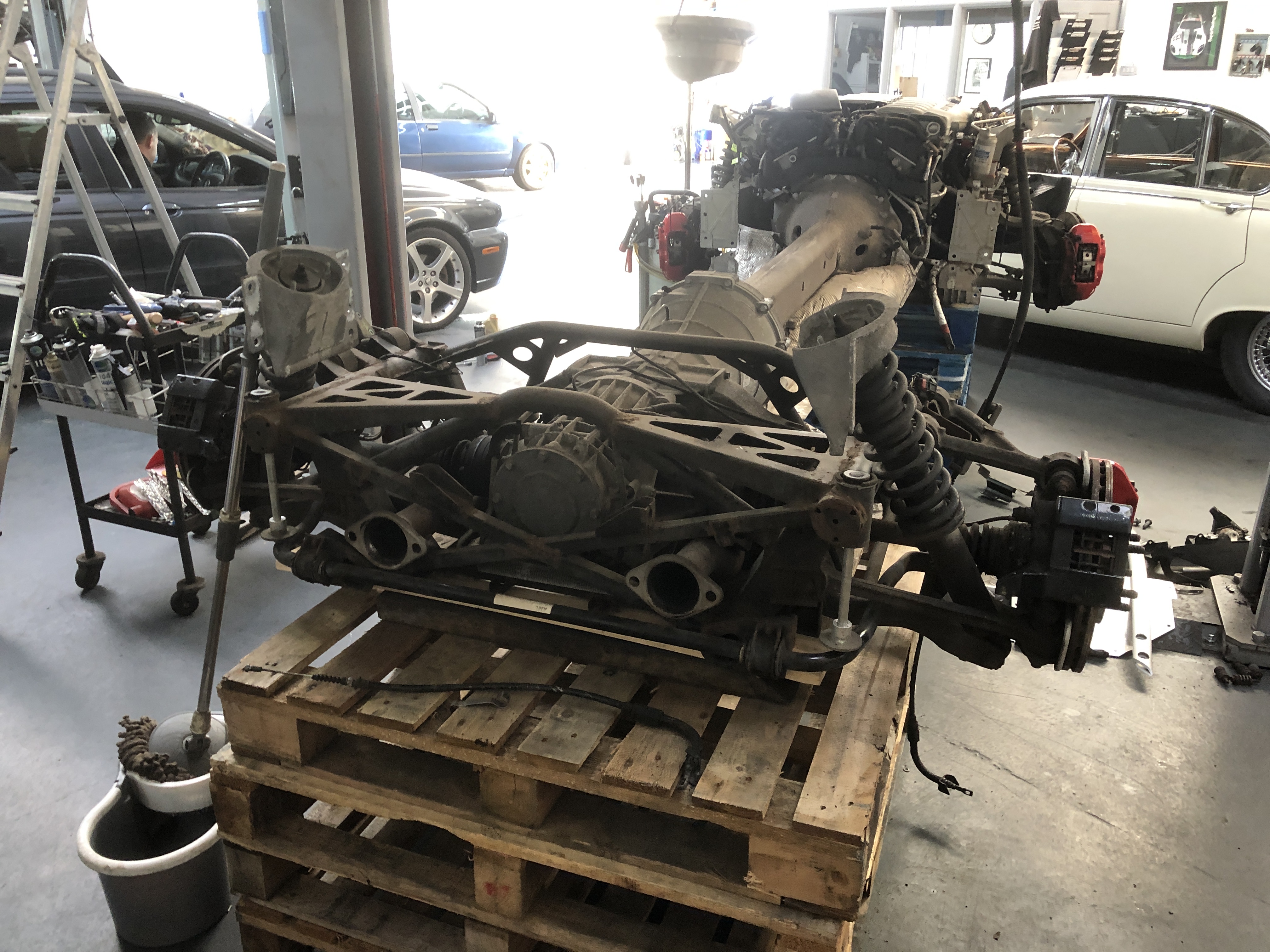

Yesterday when I was picking up my S Type from the Jaguar and Aston Martin garage they had an Aston Martin DB9 V12 on the ramp. I say on the ramp as the body was high up on the ramp whilst the Engine, gear box, suspension and drivetrain where sat below it on a stack of pallets. Why was the whole drive train out of the car? Because the windscreen wiper motor had failed and had to be changed! I kid you not! The wiper motor is on the bulk head tucked under the scuttle and the engine is so big the top of the inlet manifolds touch the underside of the wiper motor and the only way to get to the wiper motor is to remove the engine. 40 hours labour at £65 an hour to change the wiper motor. £3120 including tax plus parts and fluids just to change the wiper motor and apparently it is a common fault!
