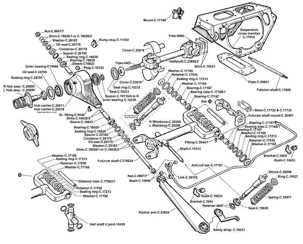

So it's a wider uprated version of this? Does the S Type body have pick up points? (never bothered to look). I know the radius arms do. Does it come as a complete kit?

The anti-roll bar is sold as a complete kit and I believe it is a wider version than the E Type as you envisaged. For the record I believe the standard E type bar is 5/8th inch, the uprated one is 3/4 inch as is the S type bar.
According to the fitting instructions you either use the attachments on the lower radius arms or use the brackets supplied. I understand the main cross bar clamps are attached by set screws that screw into existing threaded UNF holes in the body. The instructions warn that these body holes may be full of underseal. I have yet to look for these threaded holes.
Products from this source are usually well engineered, if expensive and knowing the background of this company very well from my professional days I am sure the product will do the job.

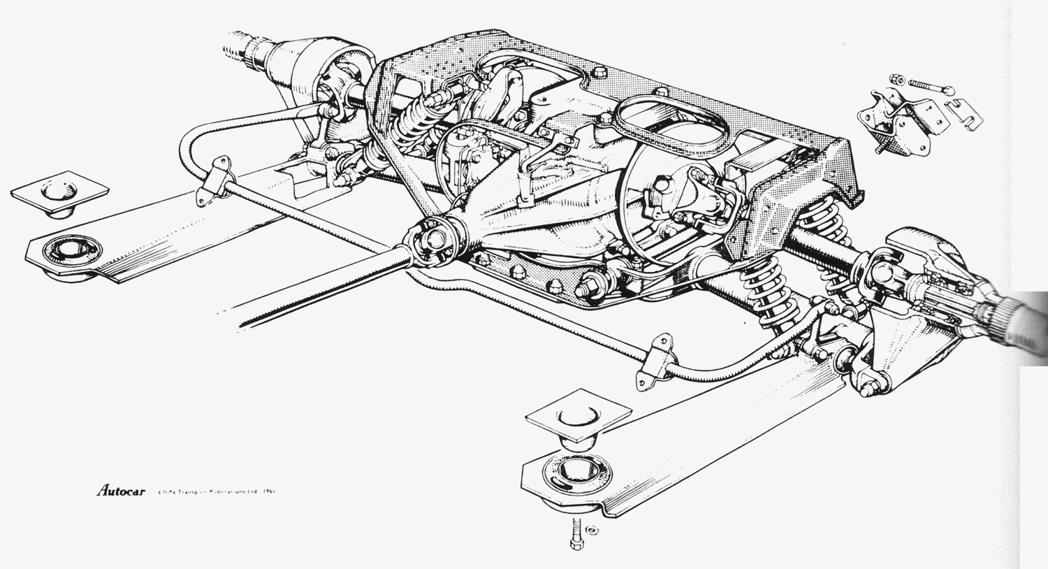

I just finished installing a 1” front sway bar and and a set of R15/205 tires. As I was cleaning the front and rear suspension when I noticed the brackets on the rear trailing arms !
I have just sent an exploratory Email off to HBE. Their web site confirms they do sell a rear sway bar for the S type as mentioned above.
How did the install go and are you happy with the results ?
