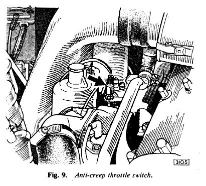

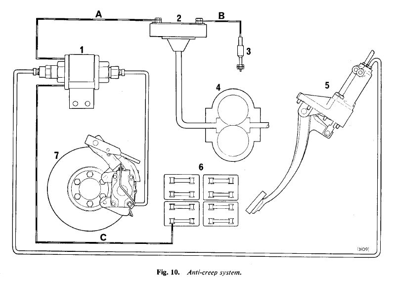

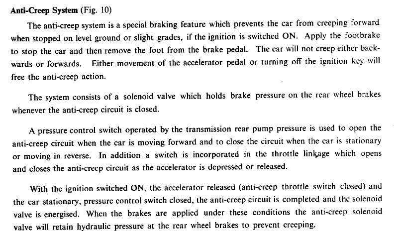

Alan, while boosters and the air/vacuum control valve are frequently the cause of this problem your car has a BW DG250 Automatic transmission. and is thus fitted with the Anti Creep system that can cause locking of the rear brakes only if not in good order or the throttle switch is not adjusted correctly. The fact that giving the vacuum valve assembly on the booster a clout released the brakes & the brake lights went out would lead one in the booster direction. Just don't forget about the anti creep system as a possible cause.

Glyn, thank you also for the comments and diagrams. First, as to the anti-creep system, I could never get that adjustment correct at the carb linkage so I just disconnected the bullet connector at the switch and therefore have no anti-creep. The booster, of course, is a whole other can of worms. During the course of trying to figure this out, I studied the diagrams and text in the workshop manual as to how the system worked. Seemed pretty complex to me, especially that air valve with all the seals and springs! A rebuild kit is available for the booster but doesn't contain much. Maybe a new unit is in order but they seem to be hard to come by and are quite expensive.
