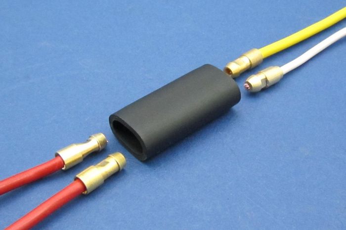

During my rebuild I had to replace some of the wiring under the bonnet and replace some of the old male and female spade type connectors. I now have bits of blue plastic sticking up all over my engine bay as the only insulated spade connectors I could find at the time were blue ones. I seriously dislike this look as it is obviously not original.
I have decided to buy these black insulated covers to replace the blue ones and to use them wherever I need to replace a connector on the car.

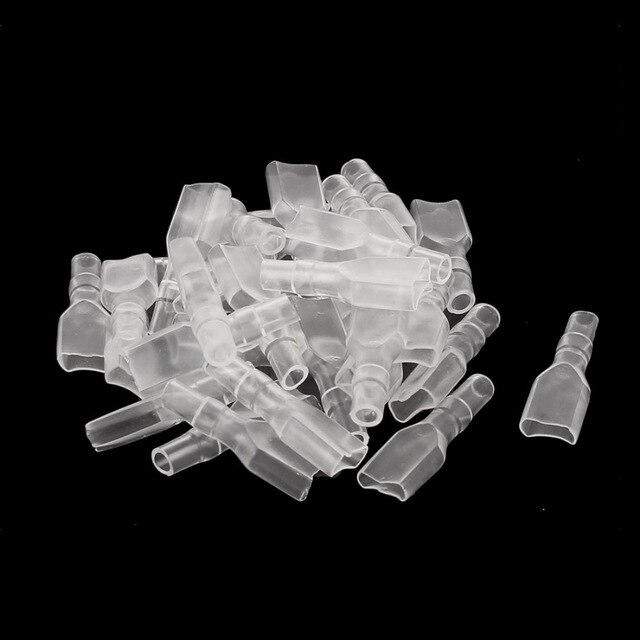

I used slightly opaque clear covers to follow Jaguar practice & those on my new harnesses.

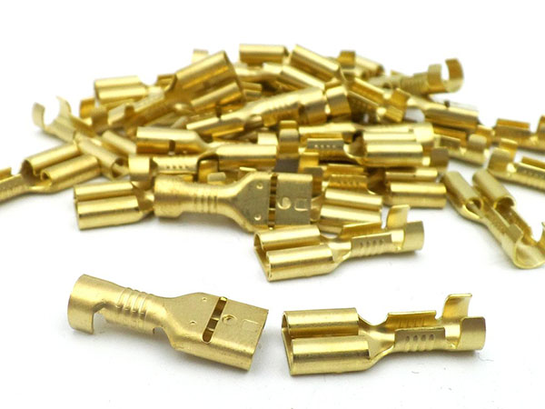

I bought a crimping tool and, for spade terminals, used 6.3mm brass spade terminals like these, covered with the insulation covers Glyn posted. They're not quite the same as the original Lucar ones, but near enough. They seem to work perfectly well.

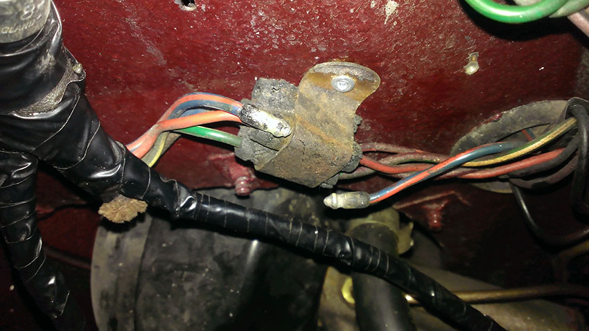

The bullet terminals seem to give trouble more often, because the connectors seem to either become too loose or break internally. The new ones seem okay, but often benefit from tightening up with a pair of pliers before installing. I always solder the bullet terminals, as crimping seems less satisfactory than for spade terminals.

Yes ~ My 5 way bullet connector blocks pretty much melted/deteriorated as did their mounting brackets. Fortunately both still available new.
Ditto to soldering bullets!
