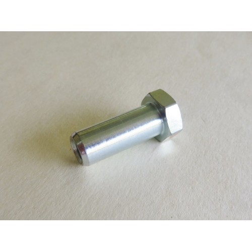

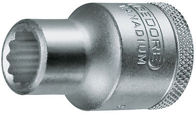

People keep asking me what size the float lid bolt is. They don't have such a socket or spanner/wrench in their toolkit & want to keep these bolts unmarred.
Gedore 6138860 Socket 1/2" drive 1/4 W
Some handbooks consider it a blind nut.

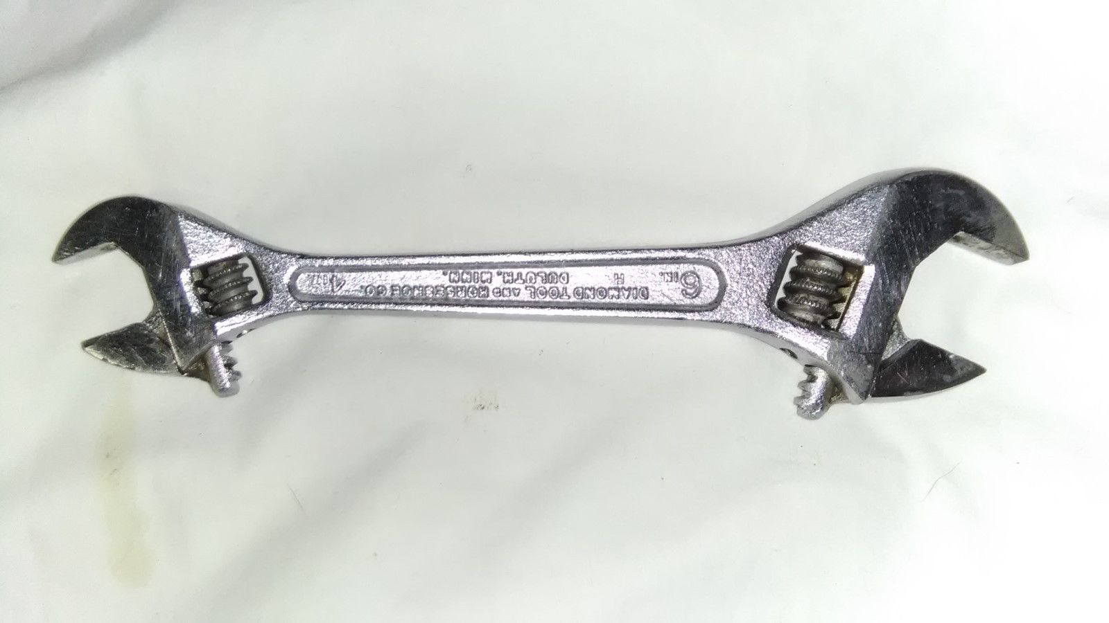

Or you can use one of these handy tools. A double ended adjustable spanner for the complete spanner.
- Double ended spanner.jpg (102.64 KiB) Viewed 3180 times

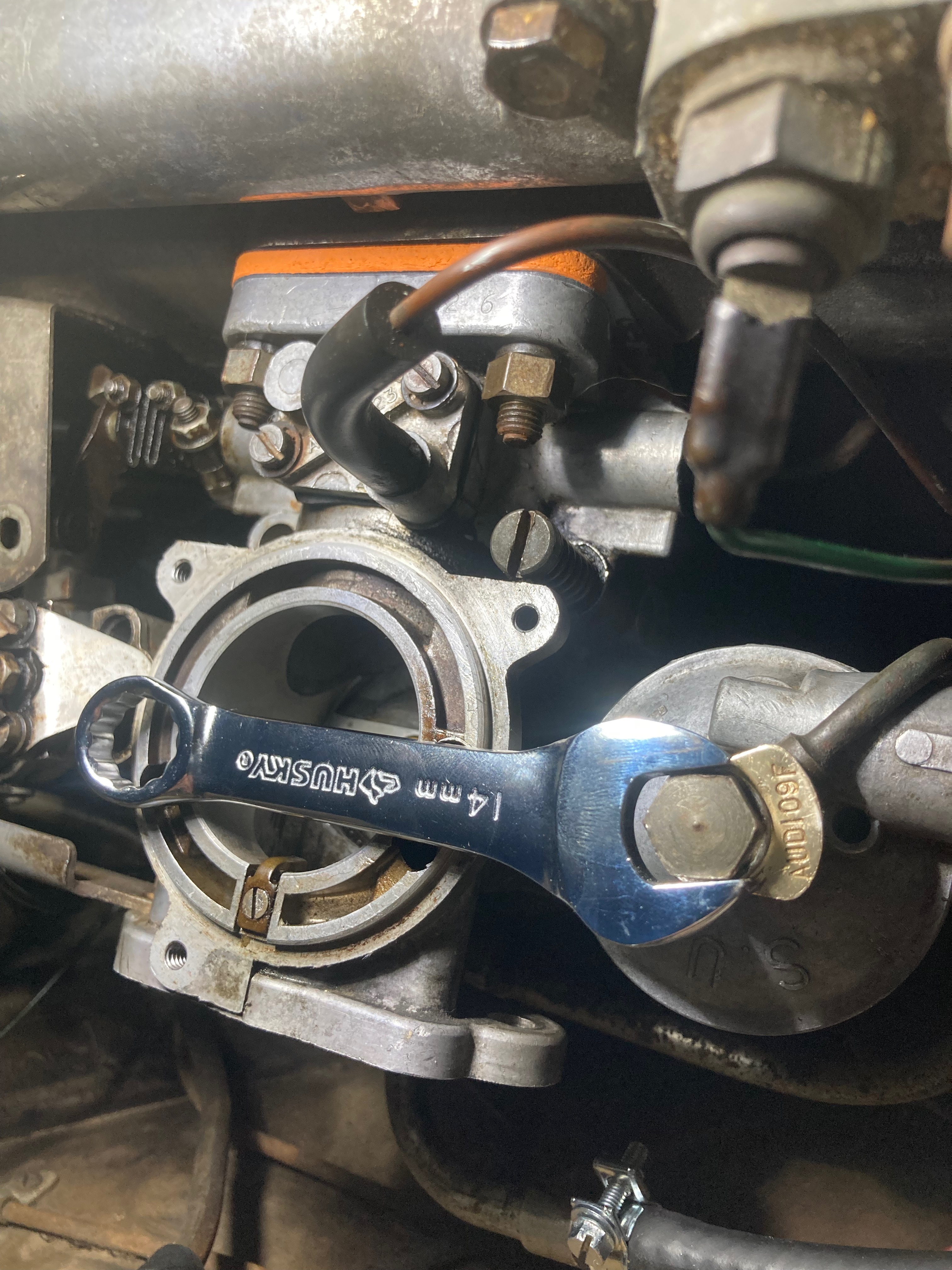

I discovered that a 14mm wrench is pretty close.
