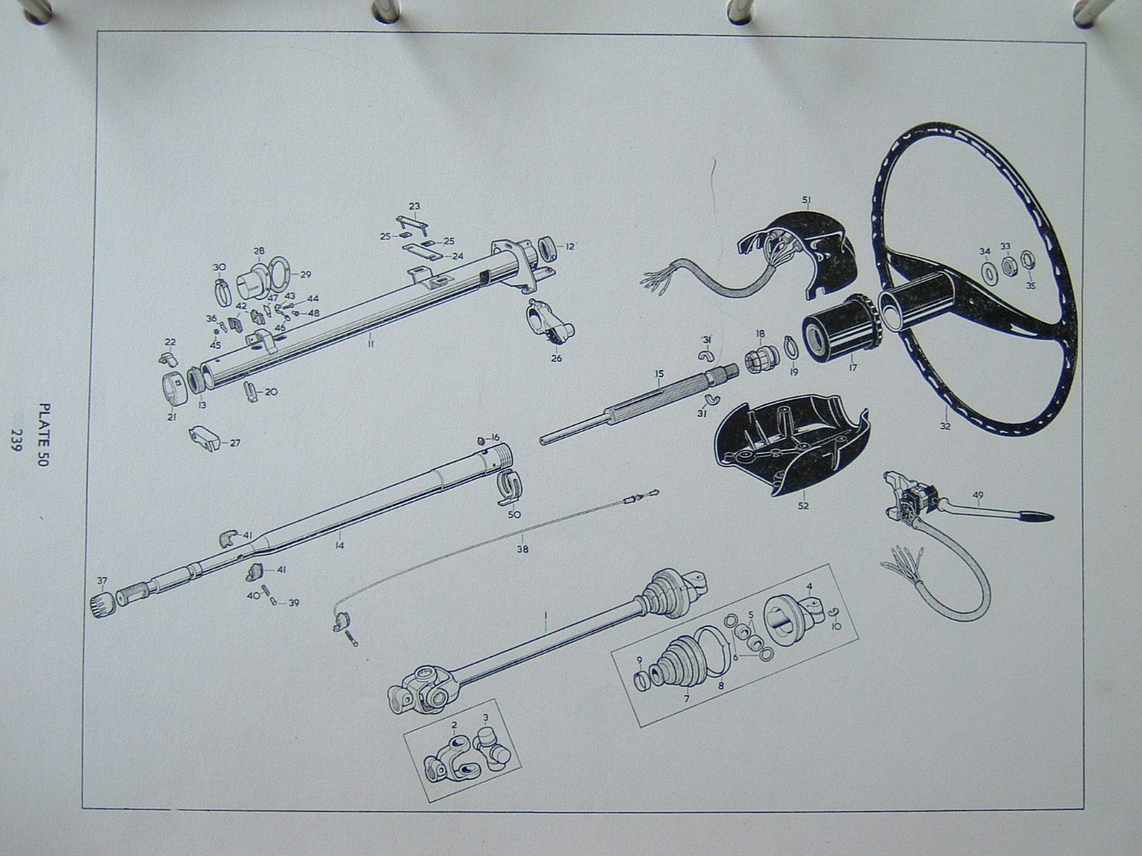

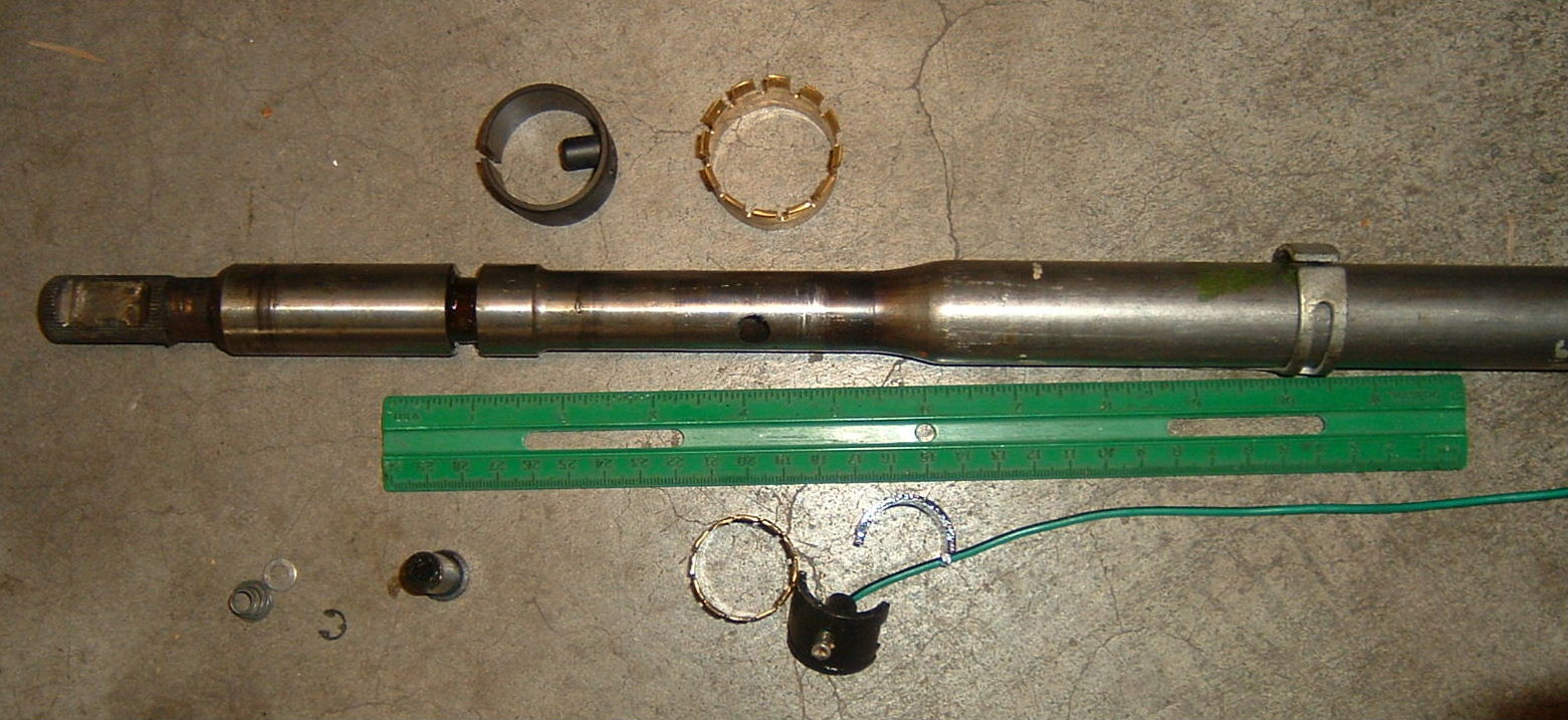

There seems to be a white wire going into the steering column, about even with the parcel shelf - not sure if this connects to something to do with the horns ?
Any ideas please ?
Posts: 289
Re: Horn no go
My car has no white wire going into the upper column at the parcel shelf level. The attached photo of the upper steering column parts should be of use. The connection is down at the bottom of the column near the floor to a "finger" contact that transfers power to the serrated ring and then up the column on wire (item 38) where this wire has a "tit" contact that grounds the wire when the chrome horn ring or center horn button are pushed. The photo is of a page from the factory workshop manual. The other photos are mine from when I had my column apart.
