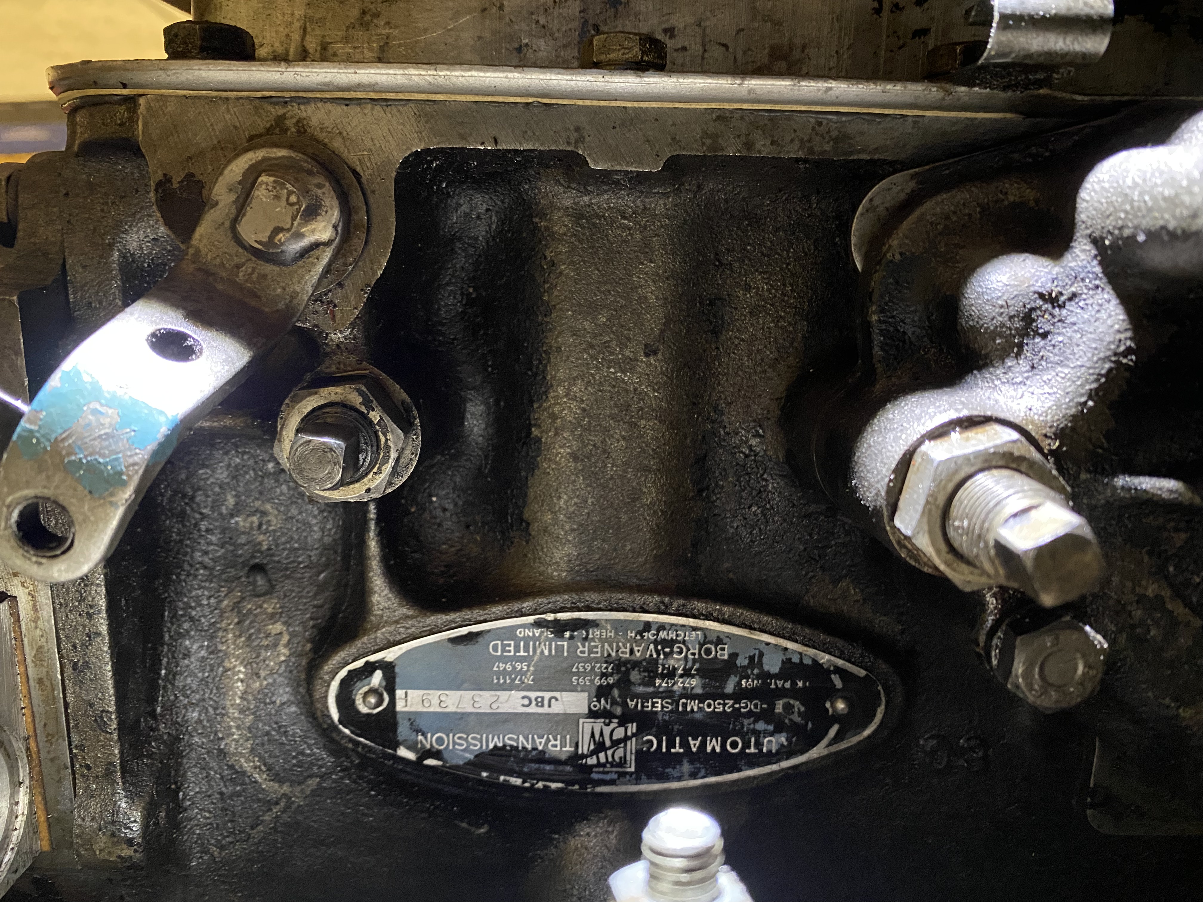

At this point I was removing the gearbox to replace the Large oring sealing the front pump. Gear selector is at right.Jerry

Rolly the 420 will not look the same as it was fitted with a Model 8 auto box. The S Type was fitted with either the DG250 which is what Jerry has shown or from around Sept 1967 they fitted the BW35 gear box.
I have the BW35 but I have right hand drive so the set up would be different for the DG250 but for the BW35 it should be the same. There is a linkage under the dash which is adjustable but there is a cable that attaches behind the dash and runs through the fire wall down to a lever on the side of the gear box. The set up should be the same for RHD and LHD as it is just a cable with no bars running down the side of the steering column. I checked through my photos and I do not have a photo of the underside of the dash showing the linkage but I have attached a photo similar to Jerrys showing the side of the gear box on the BW35. The wiring block you can see is the immobiliser switch which on the DG250 is under the dash.
