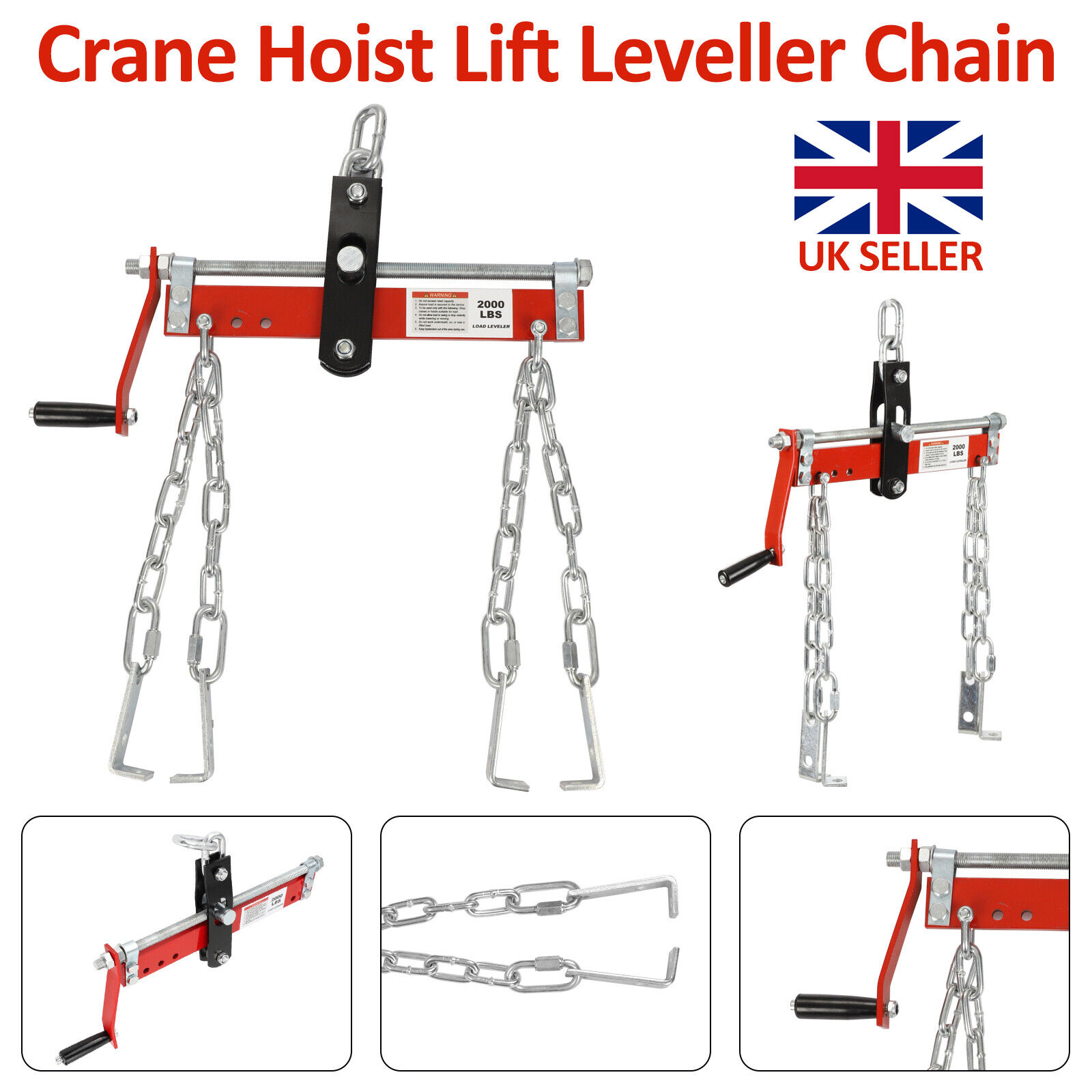

You need some height to get the engine out either way. I pulled mine out of the top and then lowered it after the new paint work gingerly back into the engine bay with the gearbox attached. The gearbox has to be lowered down into the engine bay as you push the engine towards the screen so I used this device which is an engine leveller cradle.
They are only £25 on Ebay but well worth the money.
