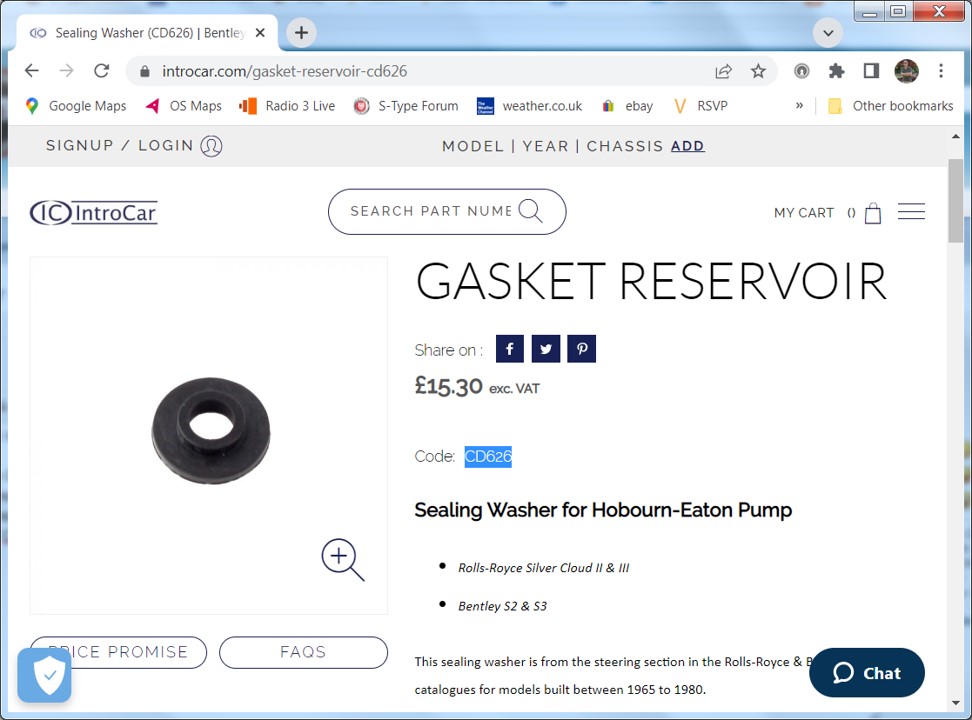

Incidentally, just in case someone stumbles across this thread looking for items 3 and 4 on the Plate 69 PAS Reservoir Diagram from the Parts Manual, which are shown in the parts manual as:
7753 Gasket, on Cover Bolt (HE.1324)
7751 Gasket, under Cover (HE.1306)
Whilst they are not available from Jaguar sources, they can actually be bought as Rolls Royce/Bentley parts (with Rolls/Bentley prices!) from Introcar as parts CD626 and CD628.
