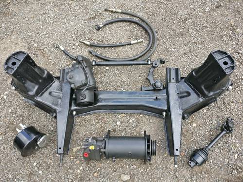

Burman boxes had no indent in the subframe so it sounds as though you already have a Varamatic Subframe. See example below.
Your car obviously has the tube that you screw the tie rod ends into equally. The measurement is from centre of ball joint to centre of ball joint. The tube itself is fixed length. With Varamatic steering toe is set with the outer tie rods. The exact opposite of all previous models where toe was set on centre tie rod with fixed outer tie rods. This is to maintain centre of the variable curve that the Varamatic operates on.

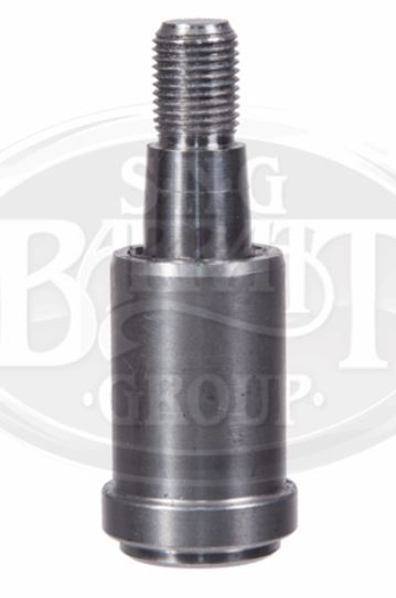

Replace these X 2 with the uprated Teflon variety. The standard ones are a curse & WILL fail or probably have already. Part Number 133101U ~ The rest you can do as it suits you when you have time if you have a bush puller.
