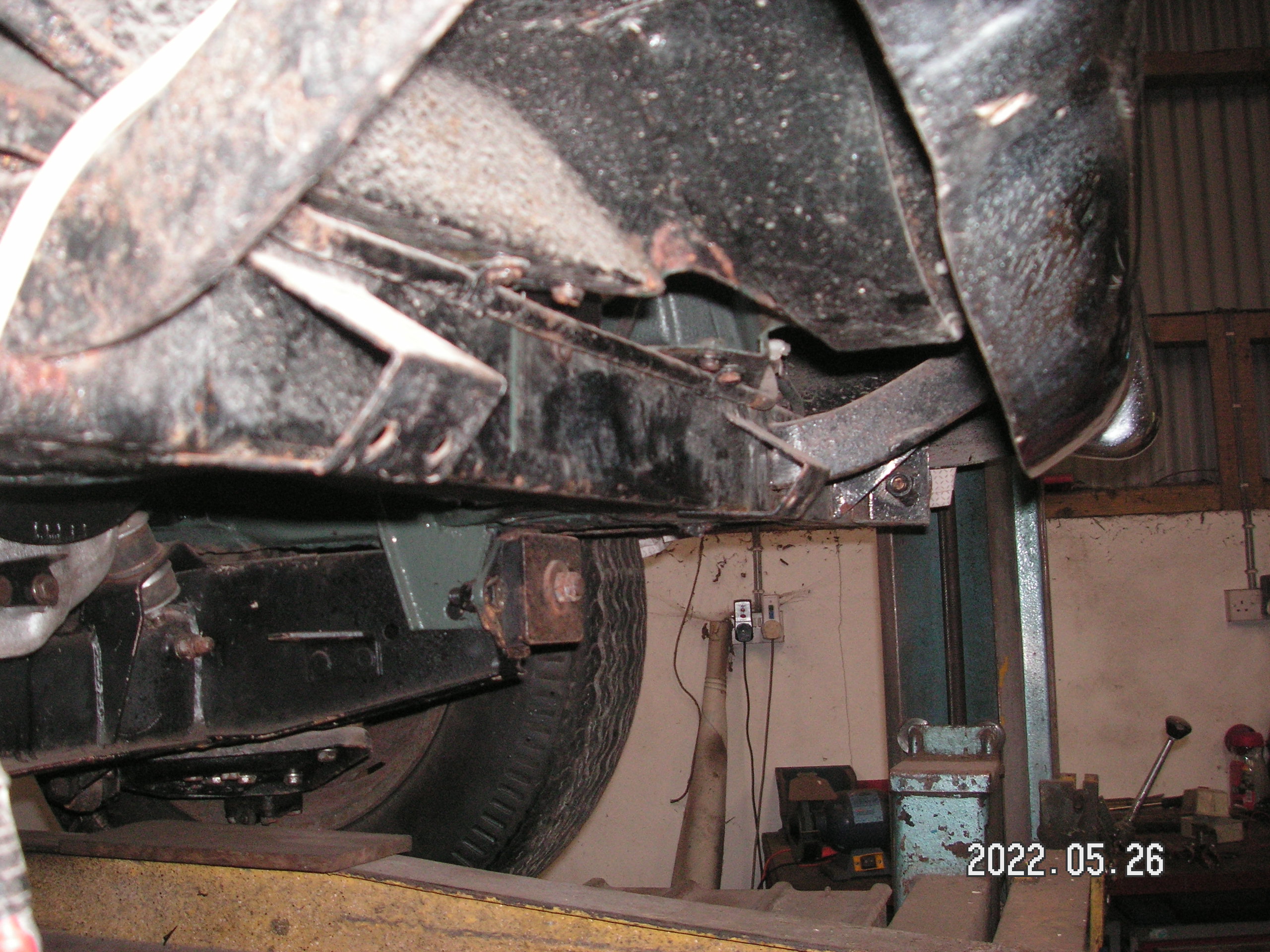

A friend of mine who is rebuilding a 1964 3.8s P1B 51396BW has just sent me these photos and asked what the brackets are for?
They are positioned on the front subframe facing the front and each bracket is immediately behind the brackets that hold the number plate to the bonnet. My car is a 1967/8 and does not have these brackets. I was wondering if they were for fixing the valance that was fitted to early cars to cover the front cross member that rotted out. I think it was deleted for the later models which is why I do not have the brackets.
Any clues? If so and you have photos of the valance fitted to a car as well I would be interested.
- PICT0048.JPG (944.91 KiB) Viewed 3063 times
- PICT0047.JPG (964.94 KiB) Viewed 3063 times
- PICT0046.JPG (994.74 KiB) Viewed 3063 times

Not on my November 1964 build car either.

I don't have them on my 1965 car, but could they be horn mounting brackets? Please do post the definitive answer .

They look like horn brackets to me.

No the horns are mounted slightly further back against the forward arms of the suspension subframe as you can see in this photo. Unless the horn mounting position changed from early to late cars. On the original photos there are no horns visible so I will have to go back to Terry and ask him to check for me. These anomalous brackets are on the chassis cross member forward of the radiator. Does anyone else have them?Treetrimmer wrote: ↑Fri May 27, 2022 6:57 pm I don't have them on my 1965 car, but could they be horn mounting brackets? Please do post the definitive answer .

They look like some home-made bodge. Likely to mount under bumper spotlamps on etc. I have about 50 under-body pics of S Types both Manual & Auto, old & newer. None of them have them.

I was really relying on you Glyn to post the correct answer.
Just spoken to Terry and his horns are where mine are so not horn brackets.
Could be an extra add on after bracket for lamps but a bit low down on the front and lamps would be forever getting broken.

You can try that Rob. '64 cars were Heinz 57 Varieties. My horns are correctly mounted. Cars with Aircon had them staggered.
They are not S Type parts. They are not in the Parts Manual (1972 Revision)
These foglamps were fitted for Swiss market only.

Thanks Glyn those brackets might be for the fog lamps although from what Terry has said the brackets are almost directly behind the fixings for the number plate. That said it is the closest suggestion yet.
