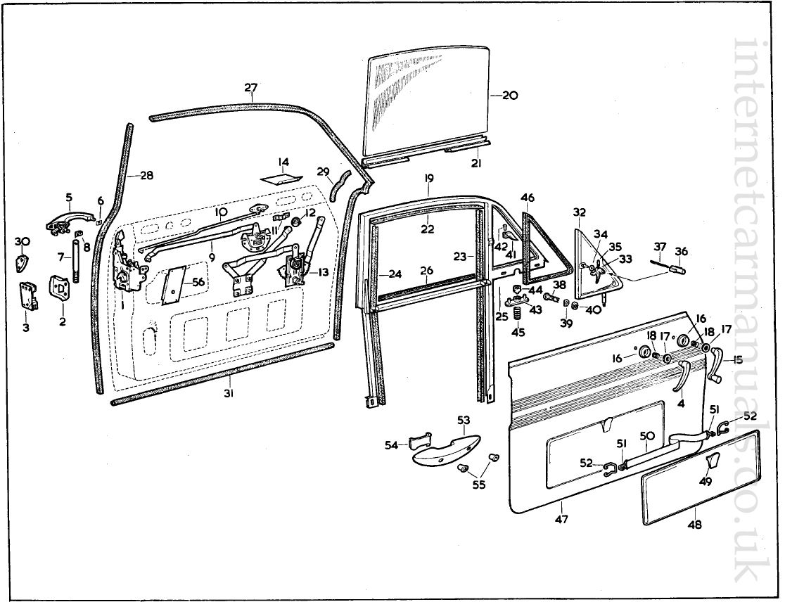

Hi everyone,
Once again it is that time of the year when days start getting longer and we have more sunshine, so I can spare some time for my project.
I came across these pieces, which I can't place. Any information is appreciated.
Thanks in advance.

After giving this some more thought I think they pop rivet into the door carcass. I remember nearly forgetting to put them in. They improve access to the lock & winding mechanism.
Item 56 example.
Item 56 example.

Hi, thanks for the information. As usual this forum turns out to be extremely helpful. I could not check whether these belong to the door I have on my car or not. I will be able to fo so tomorrow. What about the piece on top shown as item 14 on the exploded view supplied?
Re: Unknown item.
Mystery solved! Item 14 shown on picture supplied, is fitted underneath the quarter window above the winder mechanism to protect it from water.
Re: Unknown item.
Thanks for letting is know. I remember it now. But did not before you said it.
