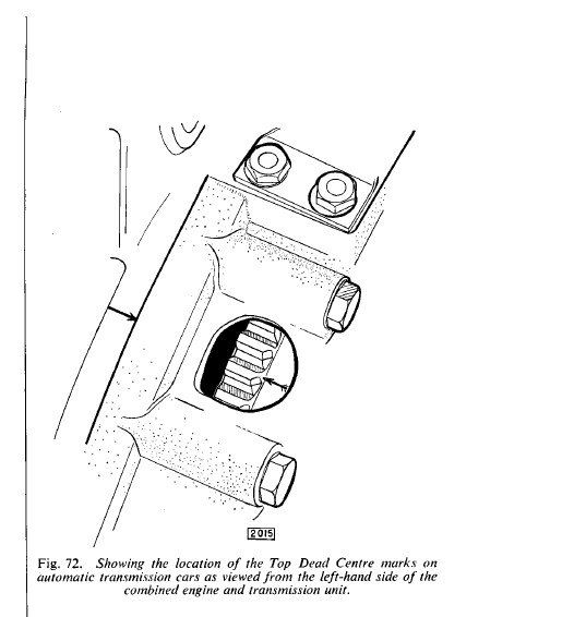

Hi,
Can some one tell me where I can find the TDC marks according the figure 72 in the manual (see attachment).
I can't find this in my car.

Re: Can't find TDC marks
Repeated on the front Crankshaft damper if that helps.
Otherwise take the plug out of No 1 which is the rear cylinder & observe piston to get into the rough area you should find the mark on the flex plate.

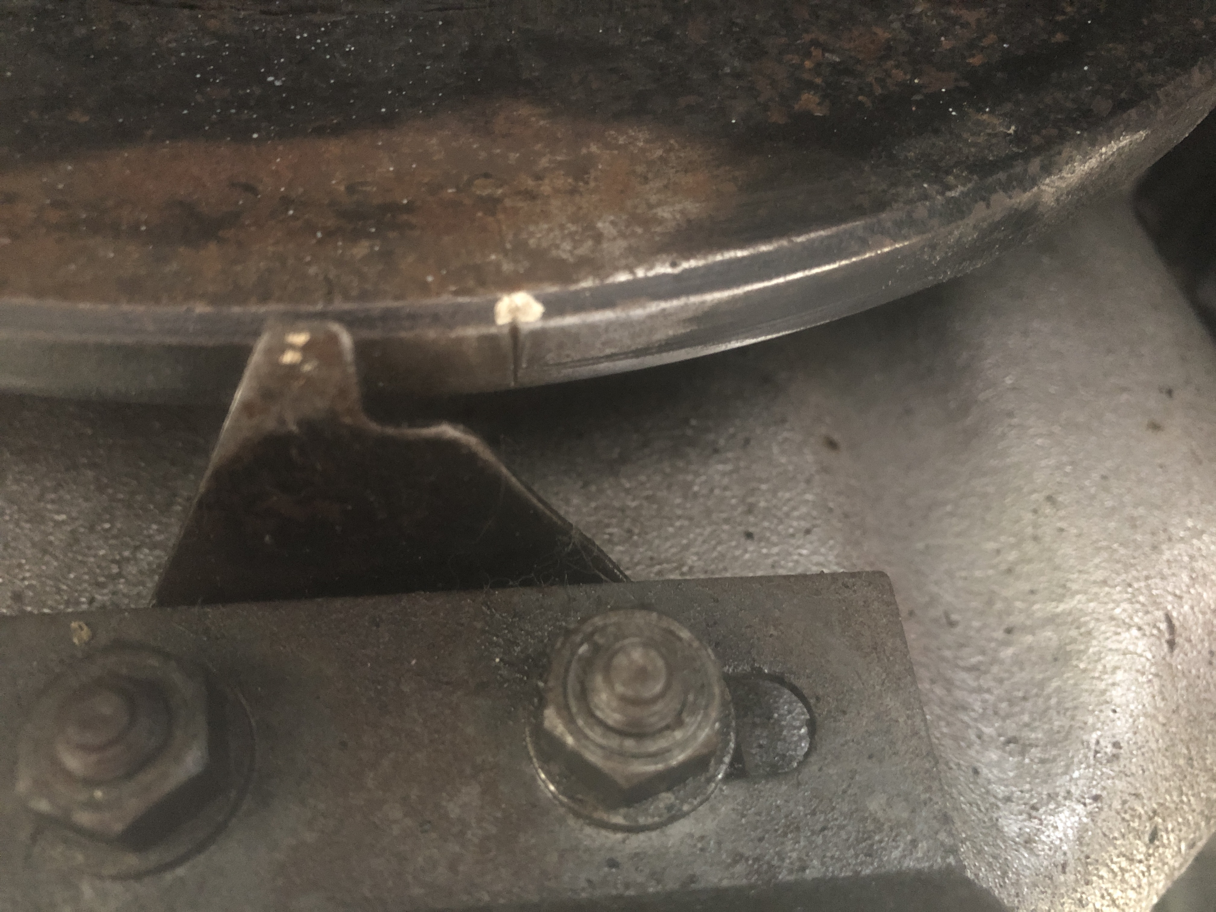

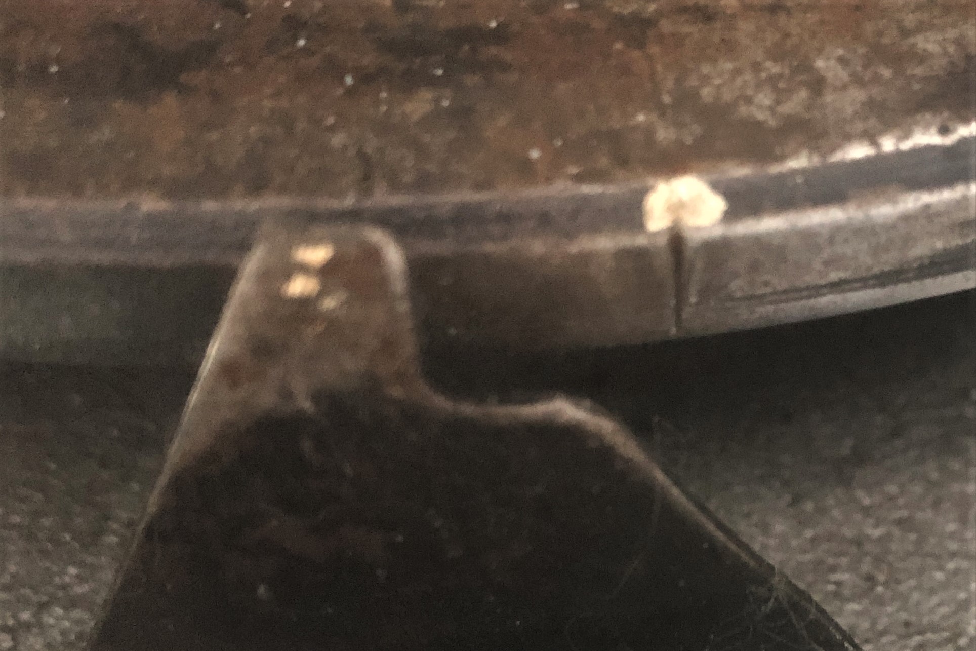

Attached is a photo of the timing mark on the front pulley.
The timing mark on the front damper is a small notch or cut on the inner edge of the front pulley. It is very difficult to see but can be felt with a finger nail if run around the edge of the pulley. So it is easier to see when the pulley is rotating and you have a timing light on it I have painted the position of the notch with a touch of white paint.
Because it is hard to find at first the best way is to put your engine into top dead centre. This can be done a couple of ways but I found the easiest was to remove all the spark plugs and slowly rotate the engine either with a socket on the front pulley nut (If you can get one on as it is a tight fit behind the radiator) or by touching the solenoid button on the bulkhead so the engine jumps a fraction at a time until you have the rear most piston (number one) at the top of the engine. You can check where the piston is by inserting a long screw driver down the bore telling where the top of the piston is but remove the screw driver from the plug hole each time to try and rotate the engine. The timing mark on the pulley should then be at the bottom close to the timing marker bar.
Thanks Rob. Your pics are better than mine.
Thanks Rob. It's clear.
