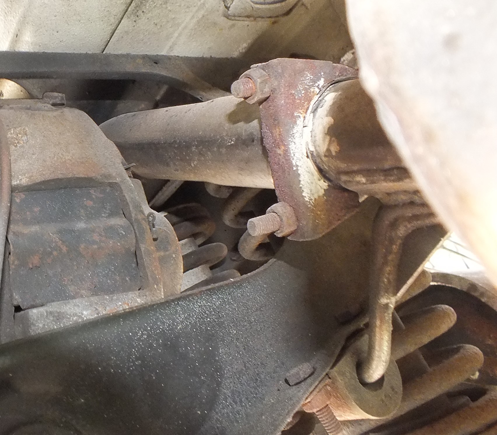

Looking at my rear suspension I found two brackets on the IRS cradle with the remnants of bushes but I can't find anything in the parts catalog that might attach to them. Any clues?

I think there are supposed to be exhaust hangers there. If you have changed or your exhaust system has been changed the metal legs that are welded to the exhaust at that point and then go through the rubber bushes might be missing.
A couple of photos showing the part not taken specifically to show it but you can see in the first photo the leg welded to the exhaust tube which then sits in the rubber bush. The second photo shows the rear subframe with the rubber bushes but the exhaust is not on the car when this was taken. Hope this helps.
