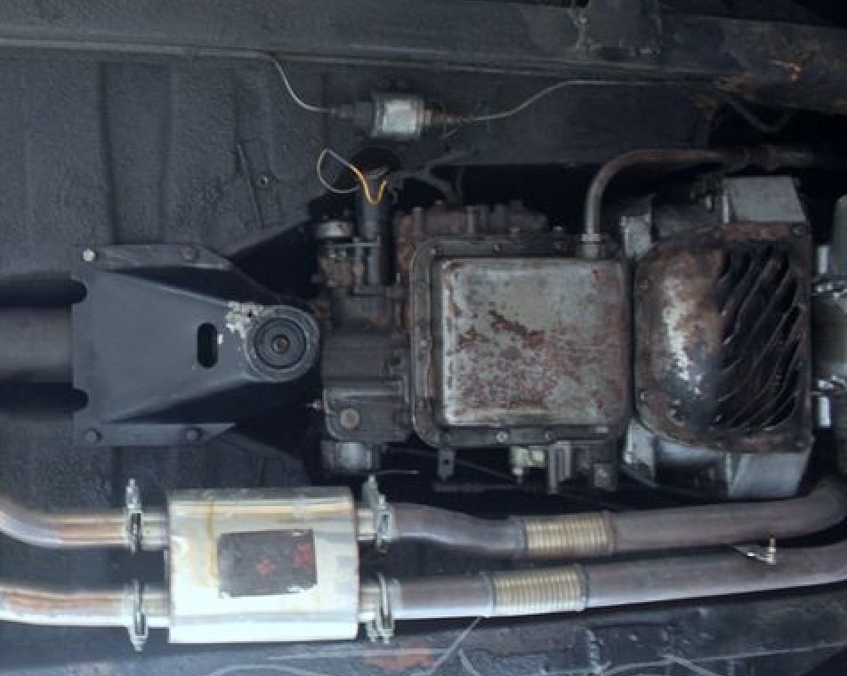

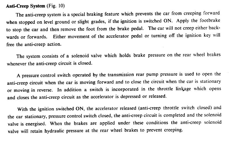

Could be a couple of things. First do you have the anti creep brake system on your car? With the DG Auto system if you stop the car on the brakes the brakes remain on until you depress the accelerator with the anti creep system. I don't have it on my car being a 1968 with the BW35 box but someone on here might know more about it. If the anti creep if coming on you might need a bit more accelerator to release it rather than just creeping out of the garage on tickover. Try holding the car on the hand brake which uses a cable rather than hydraulic fluid and with the car in reverse gear, rev the engine up slightly then release the hand brake. Don't use the foot brake to hold the car as this will defeat the object until the car is rolling. You could even jack the back of the car off the ground and try this but more revs might free the anti creep.

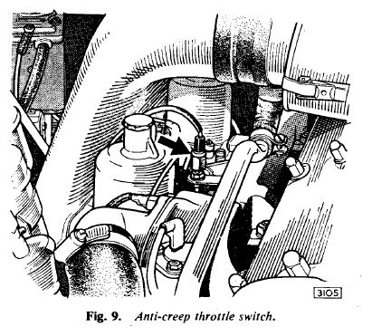

My guess is the anti creep system. You have been messing with carbs and the accelerator switch might not be releasing the rear brakes when you accelerate. Check that the throttle switch is operating properly. Otherwise it could be the pressure control switch in the transmission or the main pressure solenoid itself. Most likely switches. The circuit does not hold pressure forever which is why yours finally released. The wiring is all messed up on the underbody pics but they are all I have of the main pressure hold solenoid.

Yes ~ Make sure which wheels are braking. I actually intended putting that in the post & then a buddy phoned from Dallas & we've been chatting since then. Ignition off = no anticreep as long as no one has fiddled with the wiring.
