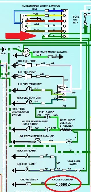

A big thank you to all those who have posted ideas and tips. It's heart-warming and helpful to receive to lots of constructive advice.
Now for the red face bit!
My first point of call was the A.E.D., and also it's Otter switch. The Otter switch tested fine ( the terminal was connected to earth, via the switch, correct for a cold engine) but nothing happened at the A.E.D. when the ignition was switched on and off. Tracing the wiring through revealed the Distributor earth wire connected to the Otter switch, and the Green/Black wire from the A.E.D. lurking unconnected in the engine bay!
However, we had by then begun investigating the fuel bowl chambers on each carburettor, and any re-assembly without fresh gaskets and fibre washers would only invite petrol leaks, plus there was already a fuel leak somewhere on the A.E.D.
So, I think the original problem was the inadvertent incorrect wiring connection. Incidentally, when correctly connected, it is easy to feel and hear the A.E.D. solenoid working when the ignition is flicked on and off.

Excellent news. So the green & black wire was off of the otter switch. Cleanup and gasket replacement is fine as is ensuring all parts present. No red face required. We have all made mistakes.
