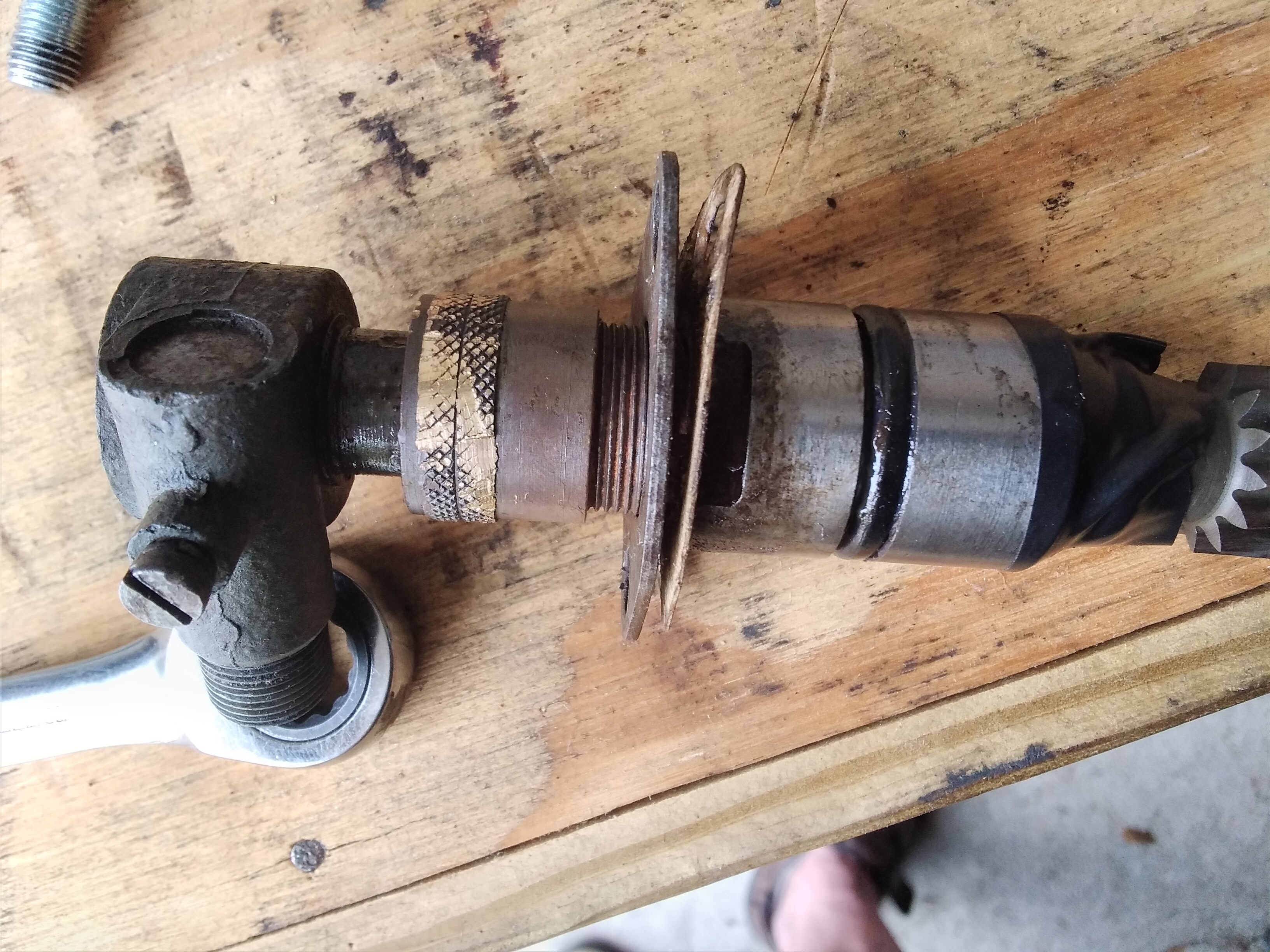

Having determined that my 1965 S-type has a BW model 8 transmission i am now working on getting the speedo to work. I have a used angle drive - which came with a transmission attached. Can anyone tell me what the small screw in the side of it is for? It doesn't appear to do anything. See picture.
Also the rod inside the drive is broken and I am wondering if anyone has any advice to offer on repairing it.

Might be cheaper in the long run to buy a new one from SNG.

I found a chap who has figured out a way of repairing them. He gives quite detailed instructions so I will give it a try once I get the transmission mount job out of the way.
Re: Speedo angle drive.
Just make sure that the squares that the main cable & the short cable fit into are not badly worn. If they are repair is not worth the trouble.

Thanks. I will check that. I may well have to buy a new one but I like to fix the originals if I can. My car doesn't currently have one and this one came with a spare transmission that I bought for the speedo gear housing that I need. So if I can get it to work, it's a bonus.
