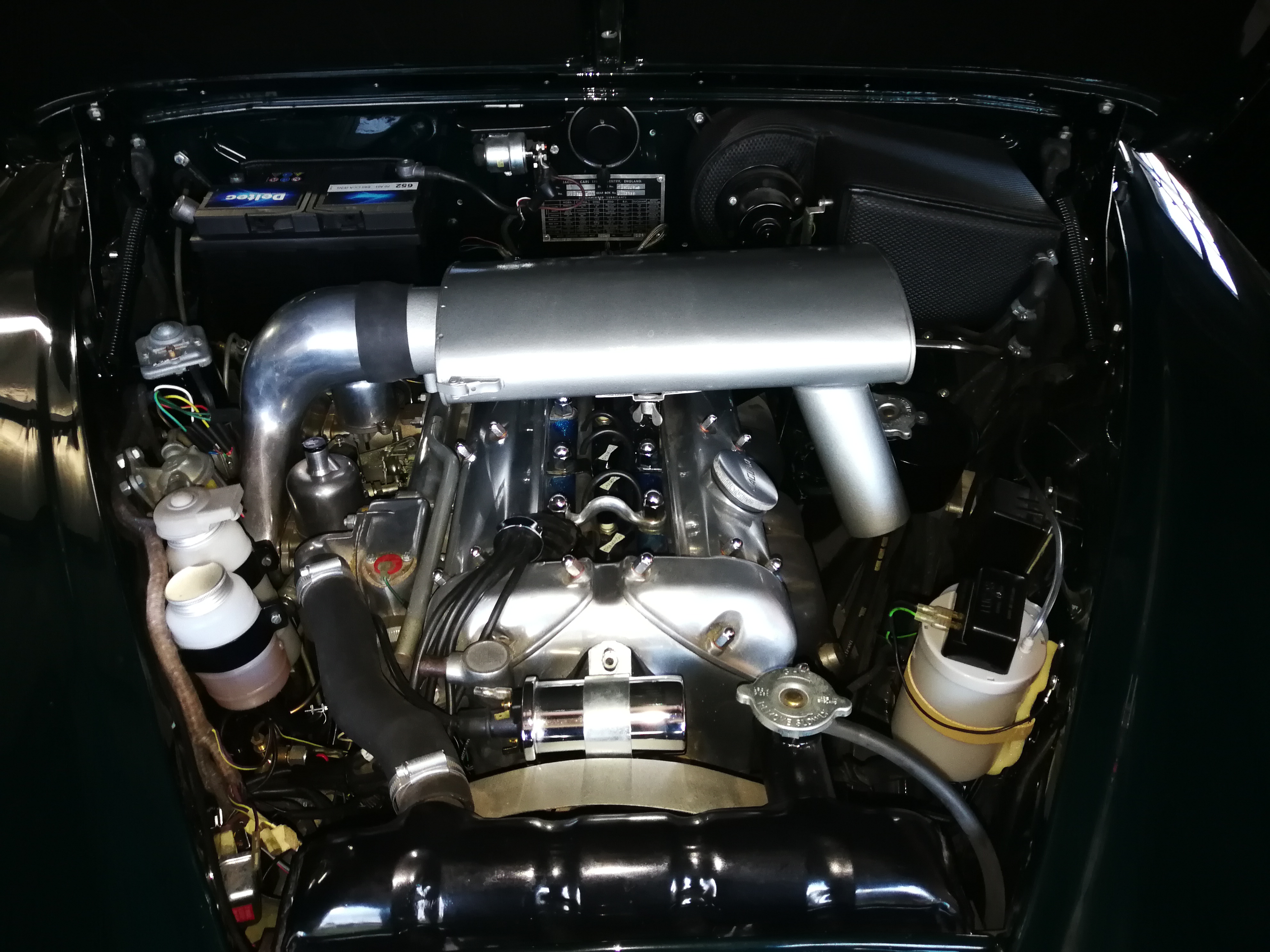

I'm running the pointless Pertronix Ignitor in a refurbished & set up Lucas 22D (41063 A) distributor still positive earth (available negative earth) & one of their Flamethrower coils (debranded by yours truly). Most satisfied & she fires up on the button religiously. All housed under the distributor cap. I have a spare distributor with new points & condenser should I ever get stuck. Of course as long as I have an easy fix I will never have trouble. (touch wood). Genuine Jaguar leads & Champion bow tie caps.
