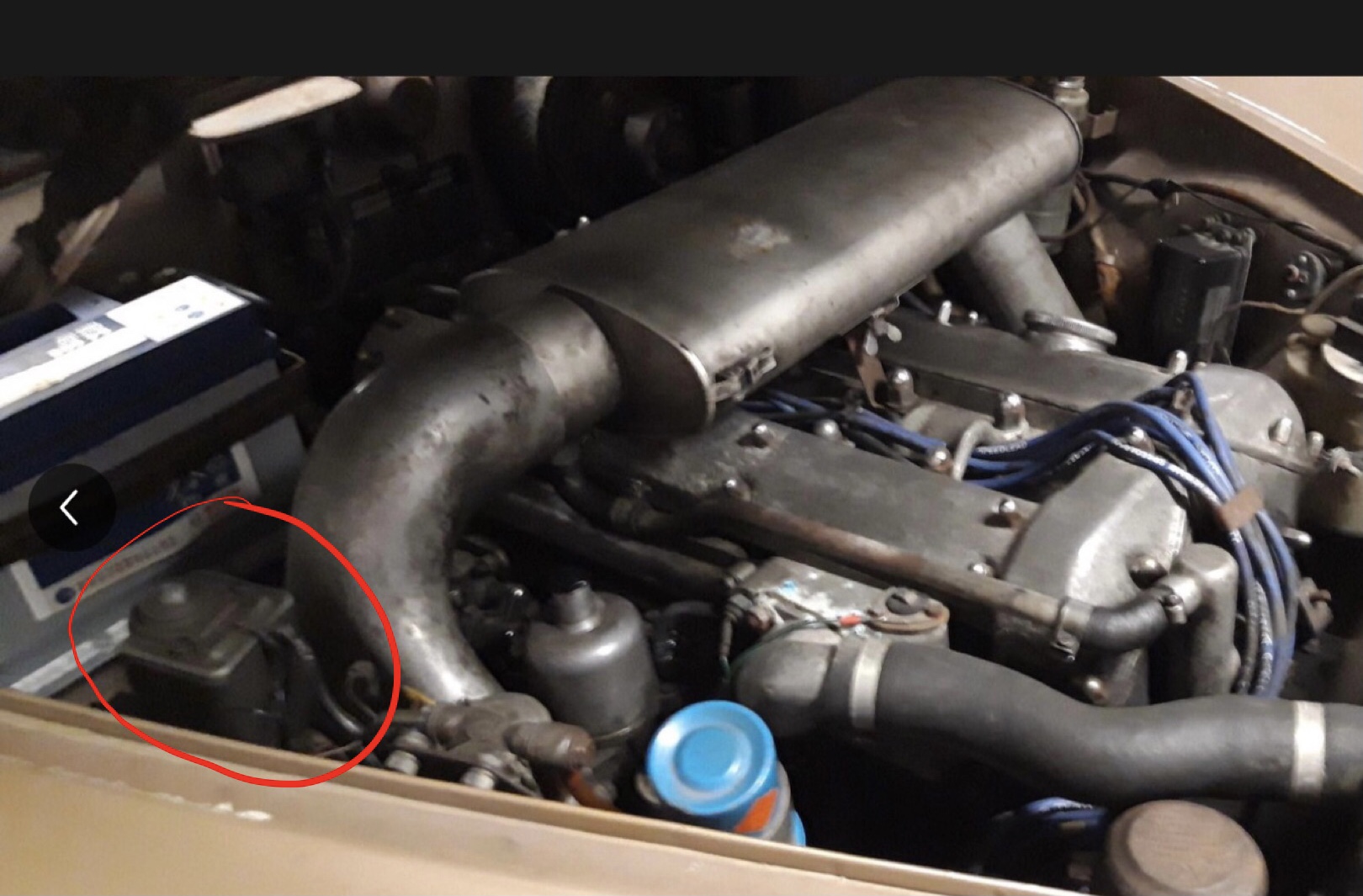

I am a very new owner of a 1964 3,4 LHD S type and working on getting to know the car. And have found this forum quite inforative. But there is an «installation» on inside of right wing just forward of the battery. What is this? See pickture.

Windscreen wiper motor

Welcome to the forum and please ask as many questions as you can as we all love to impart our knowledge and love of the S Type to others.
As John has said that is the wiper motor so you are going to have to try harder if you want to catch us out.lol.

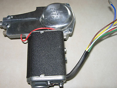

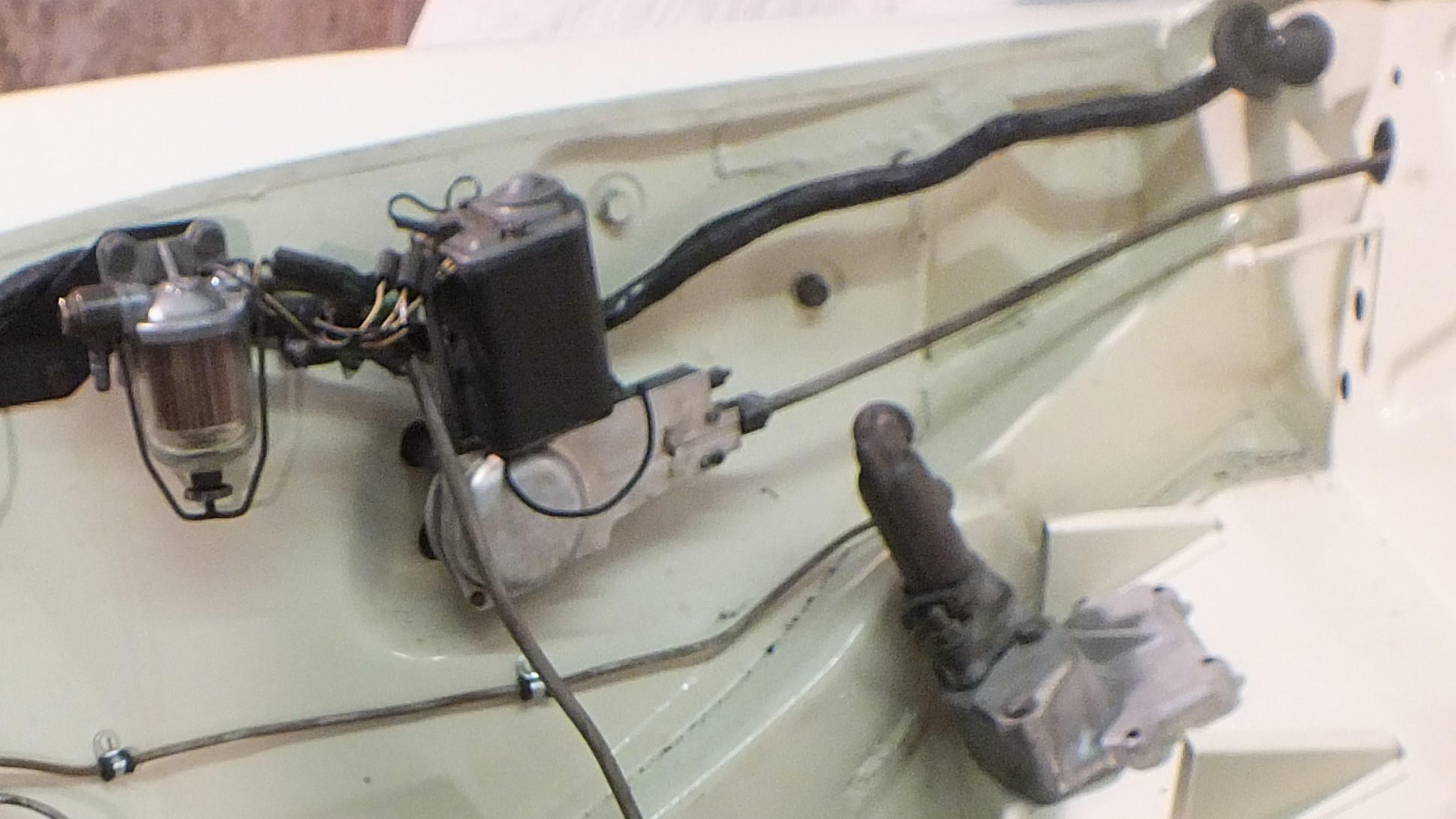

This the side on view of the starter motor. The tube which contains the drive cable is situated underneath what you can see from the top then leads in to the bulkhead and on to the wiper blades.

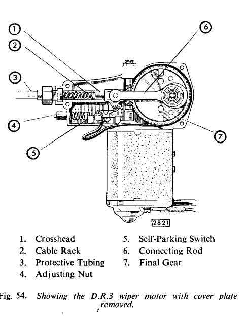

OK, here's one for the wiper motor brain trust. Why does the S Type wiper system do a little dance on the windscreen before finally parking at the bottom of the screen? Neither of my Morris Minors or Austin 1300 do this.
Re: 1964 S type
It obviously has to do with the reset seating mechanism on the motor which I believe can be adjusted using the adjuster screw marked as 4 on Glyn's line drawing of the motor.
Sometimes I switch mine off and it still goes through 9/10th of a cycle to get back to the seating position. Doesn't bother me so I have never tried to adjust it.

The DR3 wiper motor gearwheel/crank does a quick little direction change to park. (Reverse to park when the park switch is triggered). Direction of park is stamped with an arrow on the round gearwheel cover.
There are many configurations of operation of these motors. 3 on MG alone IIRC.

How does the adjuster work?
