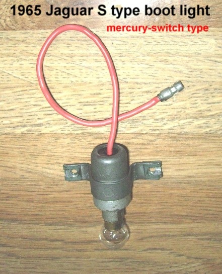

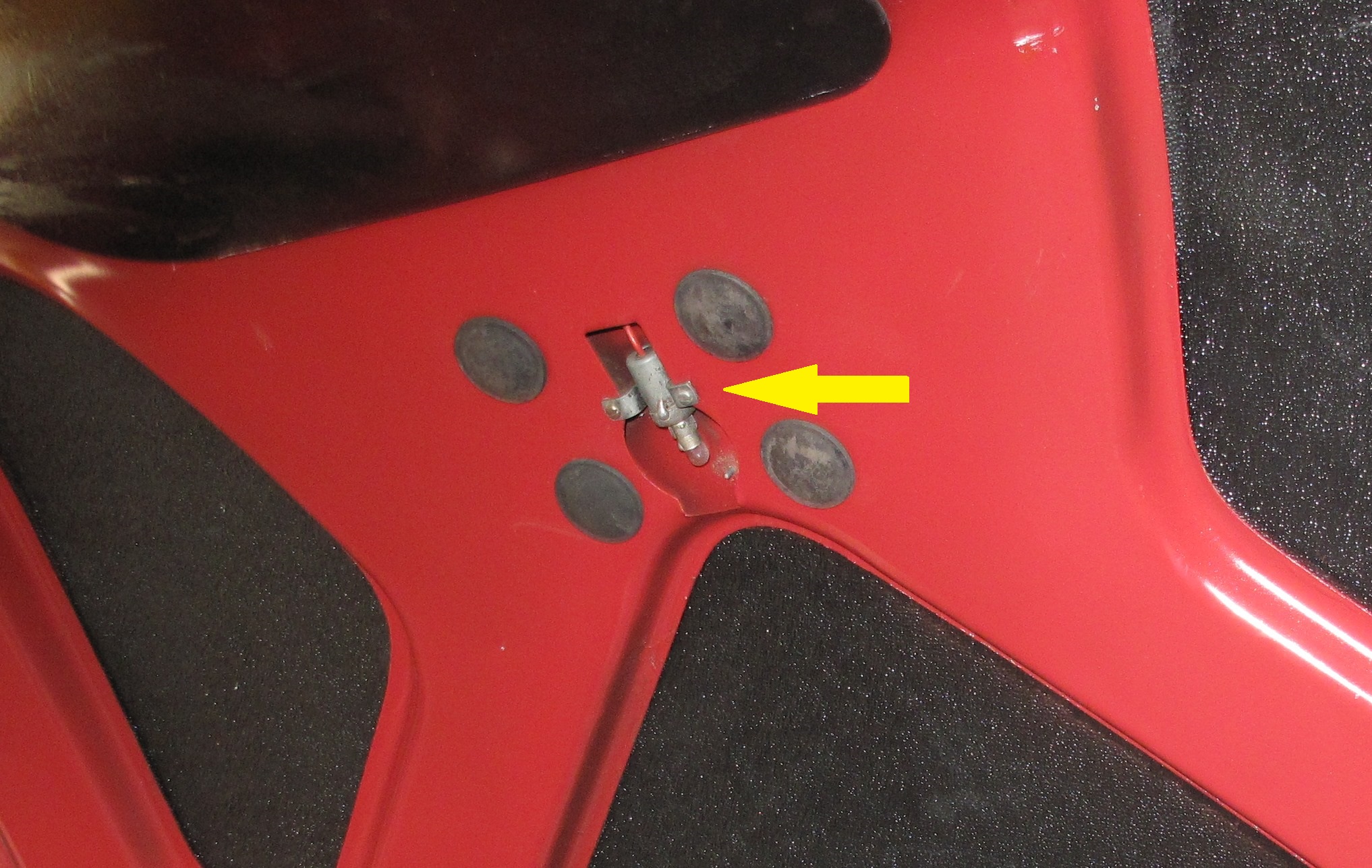

The boot/trunk/ luggage compartment light should be in the top of the boot lid when you open the lid up. You will see a hole in the inner panel and a group of surrounding holes. The boot light was as you said a mercury light which when you had the side lights on there was a live feed going to it but if the boot lid was closed it was off. When you opened the boot lid the mercury was able to flow to the base of the light allowing the circuit to be closed and light came on. Over time the mercury can become dirty and the inner contacts corroded and the light stops working. You cannot buy a new mercury light. The wiring for the boot light comes in from the left side of the car and runs up the left hand boot hinge in to the double skinned boot lid. Very difficult to feed the wire back into place if it has been removed so if your car has been resprayed they possible did not bother trying to feed the wires through. The feed wire should be red which is the same colour of the side lights and I think I am right in saying there is a double rubber connector in the top left of the boot with the red wires, one of which will be for the rear side lights and the other connect should have a wire running to the boot light.

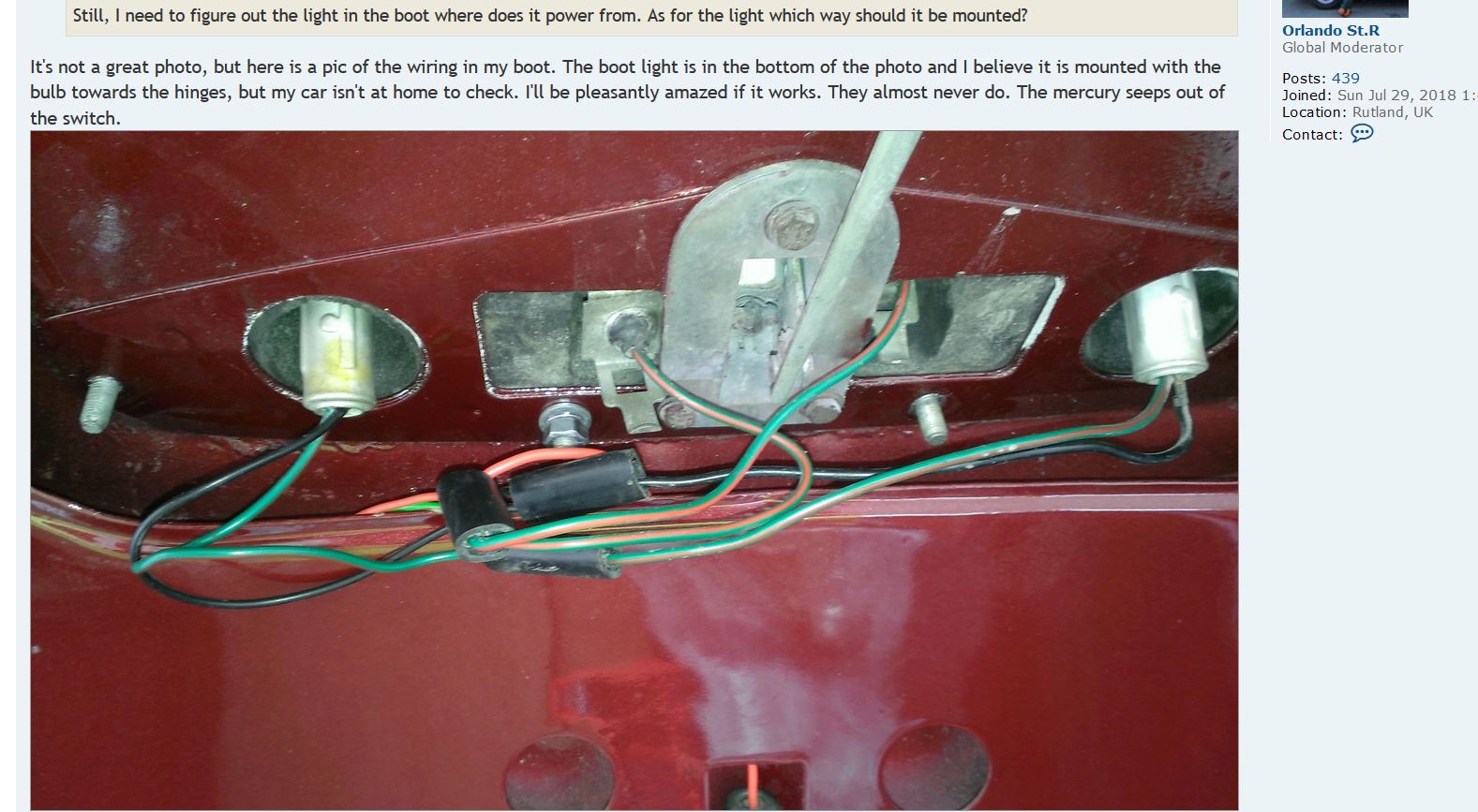

Orlando's boot light wiring.
Colour Wiring Diagram:
http://www.jagstyperegister.com/images/ ... g-page.jpg

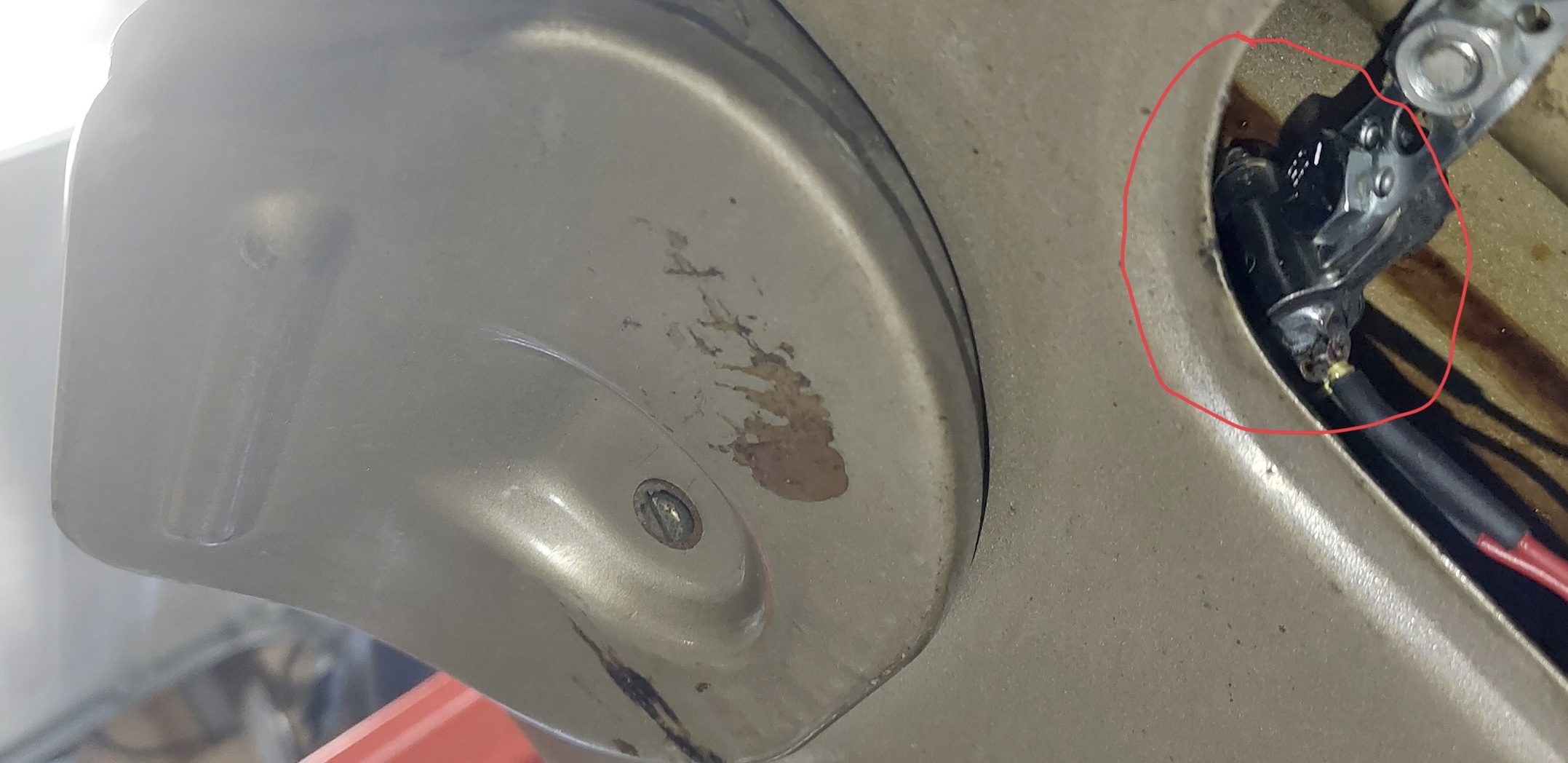

My boot light didn’t work, so I was looking for a switch working with the boot lid. Could not find any, the reason for that I found in this thread. Could not find it in the wiring diagram either, but I could see it was wired up to the number plate lights. So it can only work with lights on.
My old mercury switch wasn’t working. What I did was to wire in a general mercury switch lower in the boot lid behind a panel. Had to sit lower on a simple bracket twisted a little bit to get the right angle of the switch. Also wired in an inline small fuse for safety.

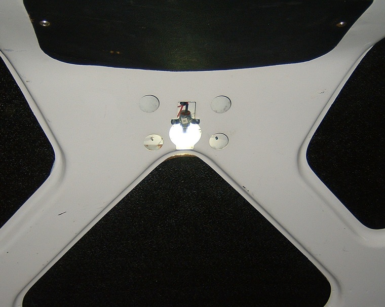

Following up on the boot light issue, I decided to address the recalcitrant mercury switch. My car has been through at least two in 50 years. My solution was to replace the incandescent bulb with an LED (Moss part number LLB989NG {this is for a negative earth car}) and cut open the mercury switch, removed the plastic capsule, removed the end disc, empty out the two drops of mercury and replace with a small rolled section of lead sheet. This makes the switch always on when the side lights or headlamps are on but with the tiny draw of the LED I can not see this as an issue. The resulting improvement in boot illumination is far better than with the incandescent bulb. And while I was at it, I also replaced the map light bulb under the dash capping.
