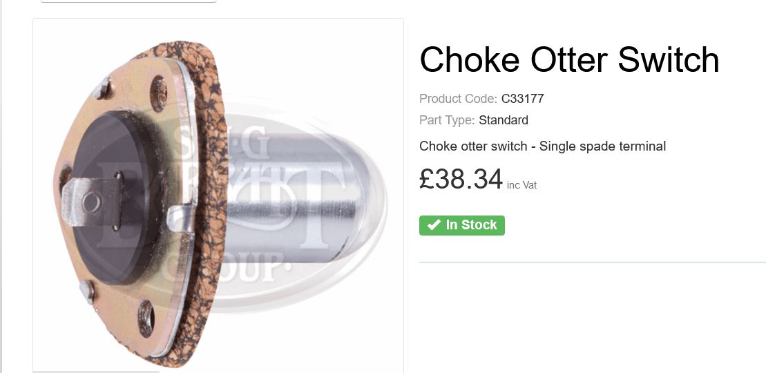

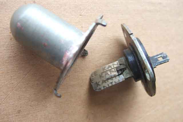

That is the Otter switch, a thermostatic switch that controls the starting carb solenoid by grounding it at this switch. Many have bypassed this switch with a switch on the dash that controls the starting carb AKA the "hisser" or AED, (automatic enrichment device).

Invar spring.
