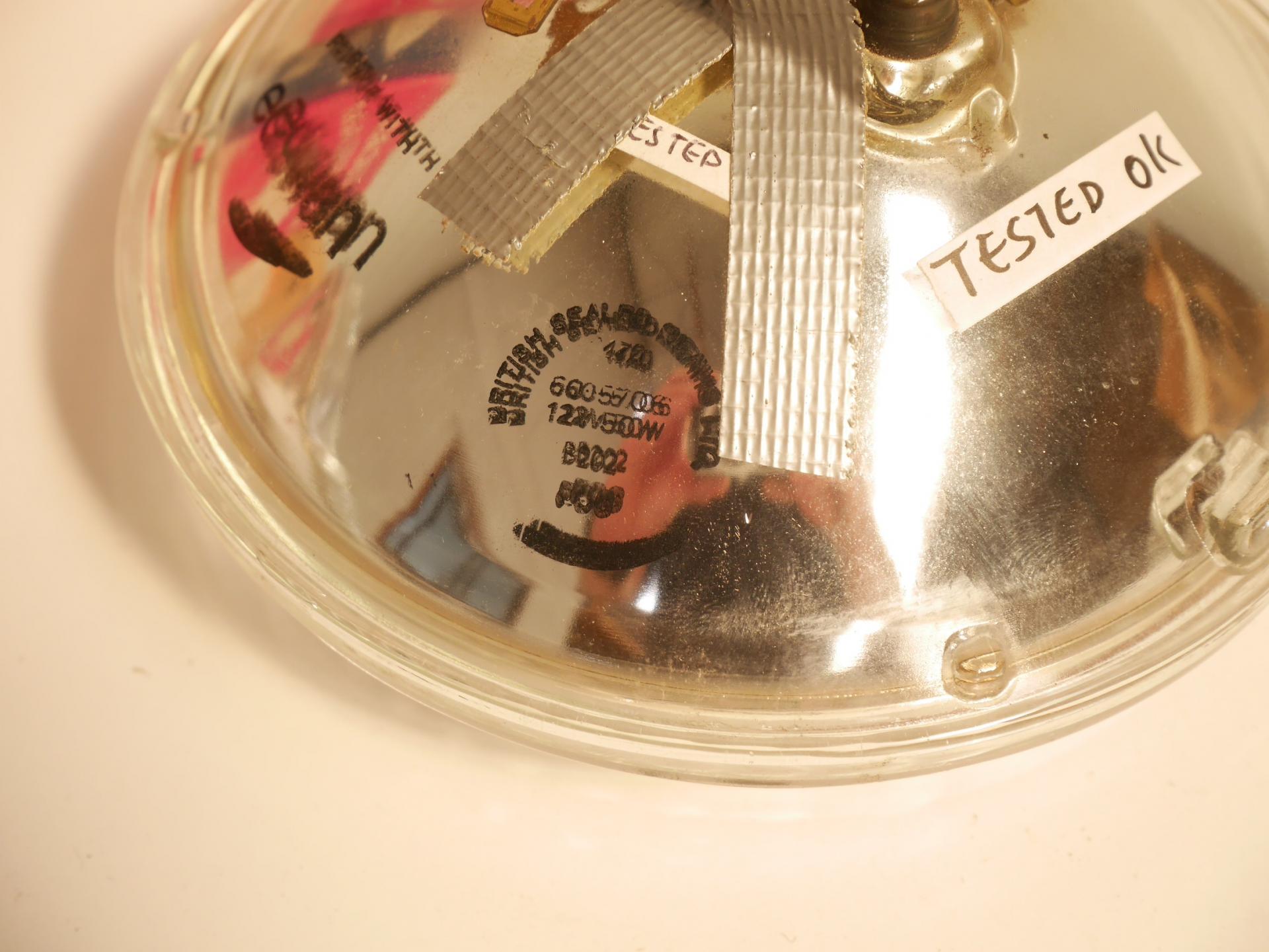

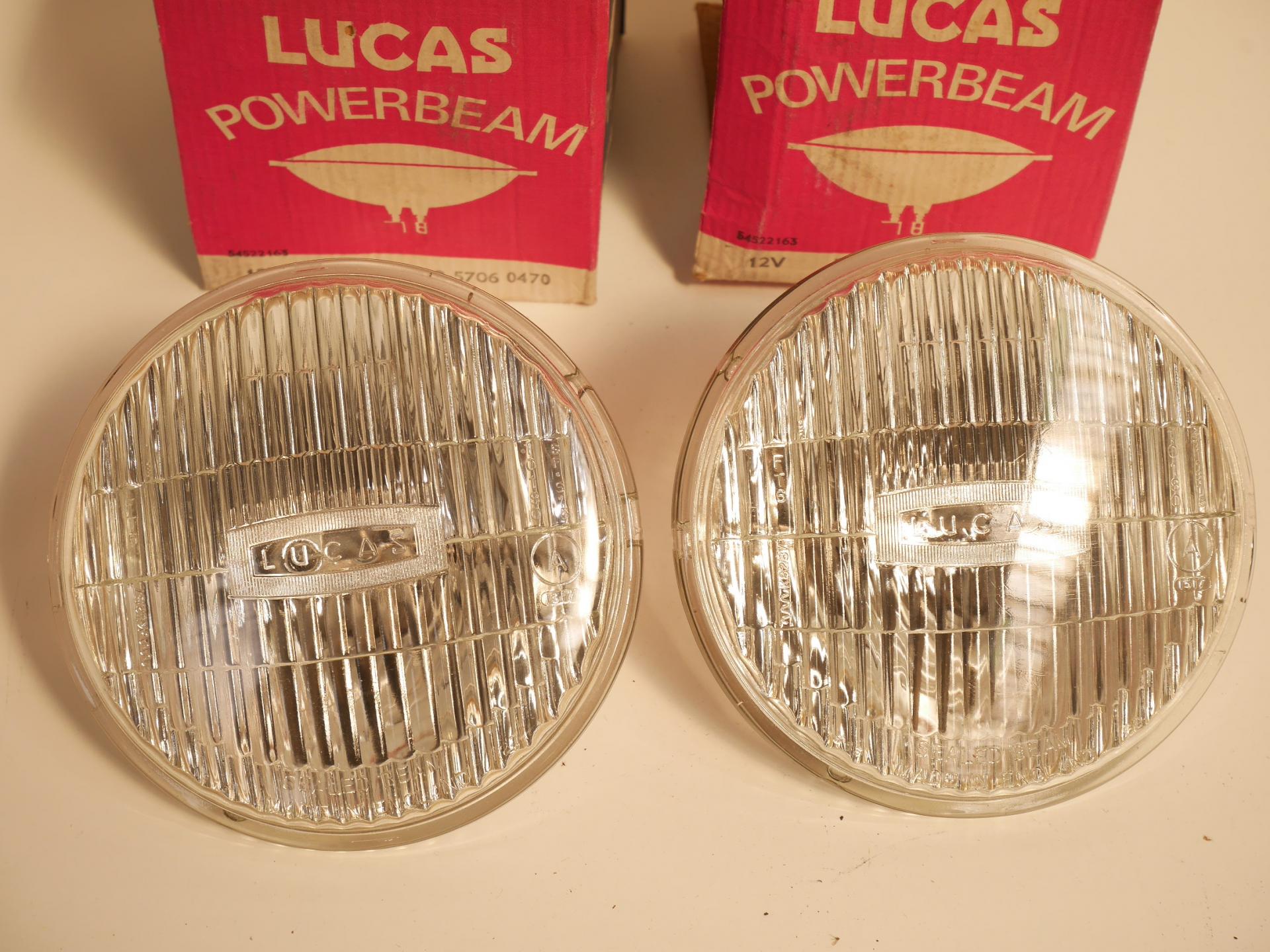

Fog lamps are no longer available & the sealed beam no longer made. You will have to keep an eye on Ebay. The Rover P5B used the same fog light. The FT6 sealed beam is used in other Lucas fog lamps such as the "Pathfinder" that are more plentiful on Ebay. You might have to buy a complete light assembly just for a good sealed beam. The final sealed beams branded Lucas FT6 were made by Mazda IIRC.
Re: Front side lights
I have a box of three or four Lucas FT6 sealed beams as spares that I have found for sale at Auto Jumbles as they are no longer made. If you see one buy it and Squirrel it away as you never know when you might need a spare.
Exactly what I have done with nice new ones Rob! :) The filaments are very fragile in working used ones dependent on use.
