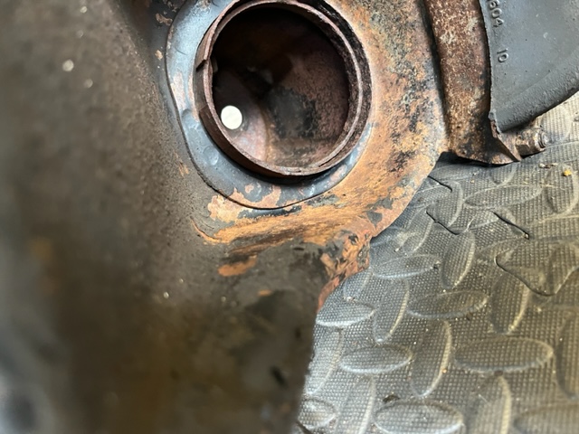

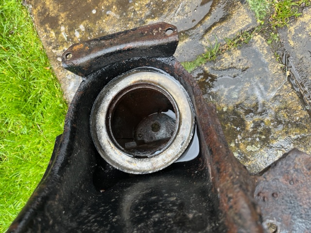

Pictures of the subframe, first is of Marles subframe, second old subframe
- IMG_2393.jpg (141.94 KiB) Viewed 4102 times
- IMG_2391.jpg (231.83 KiB) Viewed 4102 times
1966 3.4 S man o/d in opalescent golden sand with red leather, wire wheels
P1B7647DN
P1B7647DN
Re: Marles varamatic steering box
Sorry for confusion - the pics have been swapped round. One on the top is the original s/f, bottom the Marles one.

I think I am right in saying that the packing rings in the spring turrets were put on the drivers side so when the drivers weight was sat in the car the small packing ring evened out the suspension height. Mine had packing rings when I dismantled the car but I failed to note which ones went where so when I rebuilt the car I did not bother putting them back in and I have not had any problems with ride heights.
I had all my spring rates reset by the original manufacturer for SA built cars. I have no packing pieces & ride height is perfect side to side. All they did was make up for various spring rate variances.
Thanks both. Feels like the best thing to do is to discard the packing rings and use my existing springs with my replacement subframe. I believe the replacement came out of a 420 so maybe that has something to do with why there were packing rings in both turrets - maybe the ride height needed to be higher. Of course, there's always the possibility of a bodge in the 50+ years the 420 was on the road!
