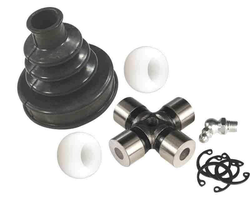

how long do you think it will take to do just the lower steering column , replacing U/J and the CV Rollers and re assemble.
Re: Adwest Marles power steering box.
From memory just over an hour to replace UJ & fit, grease & reassemble the CV Joint if you are not repainting. UJ replacement is the same as fitting any UJ to it's yolks ~ nothing special. Replacing rollers is removing & reinstalling 2 circlips. Old rollers off, grease, new rollers on & replace circlips. You just need to work methodically. Get all nice & clean. Fit gaiter to shaft early. Liberally grease CV housing, keep grease clean & reassemble.

If you were just removing the lower steering column I would say an hour to remove and replace as long as you know what the sequence is. It took me longer as I had to work out what needed removing to get to another part. It can be removed without removing any other parts but that depends on how much you want to get at it. As I was taking the steering box out I had removed the steering linkage but I left the anti roll bar and oil filter in place.
The sequence is.
Disconnect the gear selector arm ball joint on the Auto selector.
Undo the two bolts holding the upper steering column to the dash so it hangs free. I left the nacelle in place and the wiring but my wiring was long enough to allow the steering column to be pulled up far enough out of the way.
Remove the four bolts holding the round plate behind the brake pedal holding the base of the steering column to the bulkhead.
Remove the upper and lower pinch bolts on the lower steering column. You might have to rotate this back and forth to get to the nuts and bolts.
Now make sure that everything is set in the dead ahead position.
Pull the steering wheel and column away from the bulkhead disconnecting the lower steering column from the upper splines.
Pull the lower steering column from the steering box splines and remove it from underneath the engine bay.
Refitting is obviously the reverse making sure that you spread both the splines on the lower steering column to ease sliding them together. Making sure that when you slide the splines on you line up the holes for the pinch bolts correctly.
Make sure everything is in the dead ahead position when reassembling.
Tools required.
I think all the bolts are half inch so you will need,
A half inch socket. Extra long extensions would help and a ratchet.
Half inch open spanner. A stumpy short spanner is a good option just because of the room you have to work in.
I used a set of small mole grips to hold one side of both pinch bolts on the lower steering column because there is no room to get two hands in the space with two spanners.
A decent torch or light source.
A flat ended screwdriver and hammer to open the splines on the lower steering column.
You will need a set of circlip pliers to strip the U/Js, some grease and some cable ties to secure the rubber boot back in place.

Thank you Rob. I was fitting without upper column in place yet. No Auto selector to consider & easy access with no removal required. My gaiter ring clamps were perfect & reuseable. Zip ties will do just fine.
