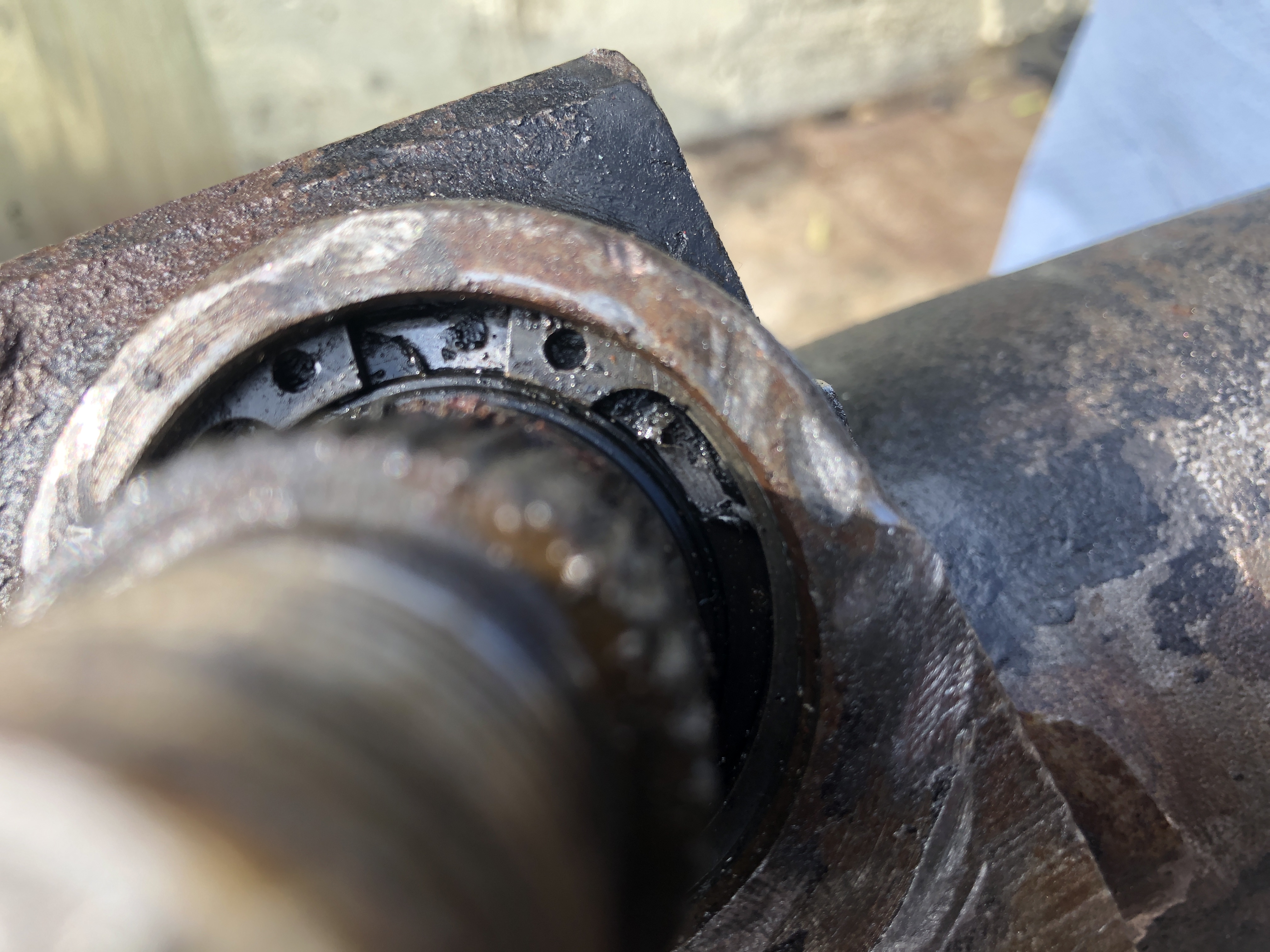

To strip the old Worm and Sector shaft seals out I found it necessary to remove both shafts. The drop arm eventually came off after tightening the puller up a little bit at a time for a couple of hours. With the drop arm off the splines I was then able to get to the seals. With the splined ends still in the seals it does not allow you to get behind the seals to pull them out. A partial strip down was required so I started with the Valve cover. Remove the hydraulic pipe at both ends then four bolts and the cover comes off. New seal on the inside of the cover and the shaft seals removed and replaced after the circlip is removed. The splines are a smaller diameter than the internal diameter of the seal so there is no need to cover the spines when fitting the two seals. The Worm does not come out and is left in place. The book says check the Teflon rings and replace if required but I doubt that is something I could do but a visual check was made and they appeared to be fine. What I did notice as I tipped out the remaining steering fluid was 1. That the fluid had a lot of very fine metal sparkles in its colour and 2. It appeared the fluid was also contaminated slightly with water. The first was disconcerting but as I will explain further not a problem and the second was possibly due to the fact the steering box had never had a full service before, still had the original seals and possibly apart from being topped up, the same fluid, so 50 years of moisture ingress. Valve housing back on with new seal and the Top cover was then removed. Four bolts and the cover comes off with the sector shaft attached. With the shaft out you can get to the sector shaft seals. These are the ones which are more likely to leak than any others due to the fact that the splined shaft is a larger diameter than the internal diameter of the rubber seal. The seals are held in with a large circlip which requires a large set of heavy duty circlip pliers which I did not have. Mine broke after half an hour of attempts and I had to remove the centre rivet on the pliers and replace it with a nut and bolt to stop them twisting. Finally got enough purchase to allow me to get a small screw driver behind the circlip and ease it out. Possibly took two hours to just get this circlip out, so much for two hours to strip the whole box. With the circlip out the old seals were removed but I did not at this point put the new ones in as I wanted the shaft to be in place before the seals as I will explain.

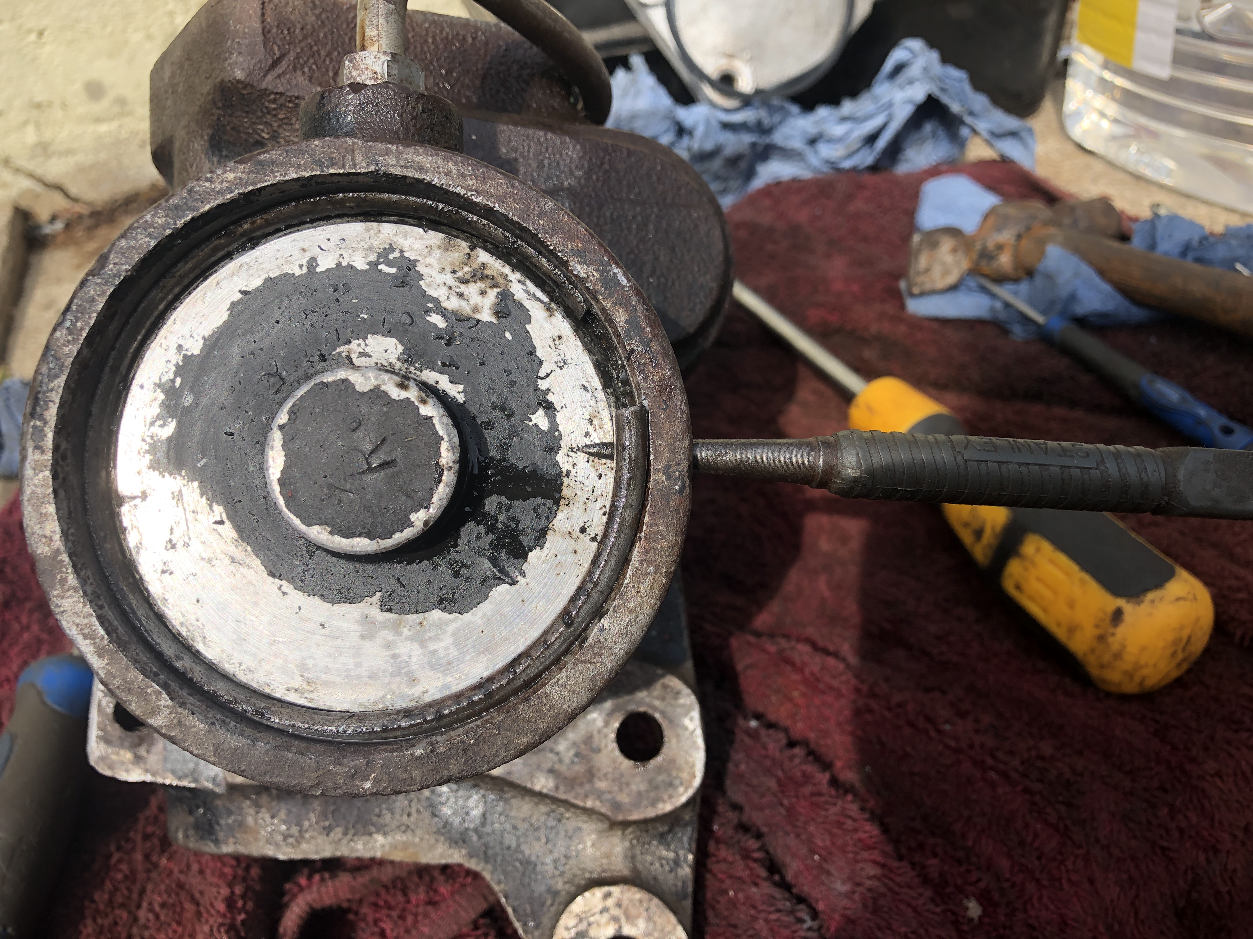

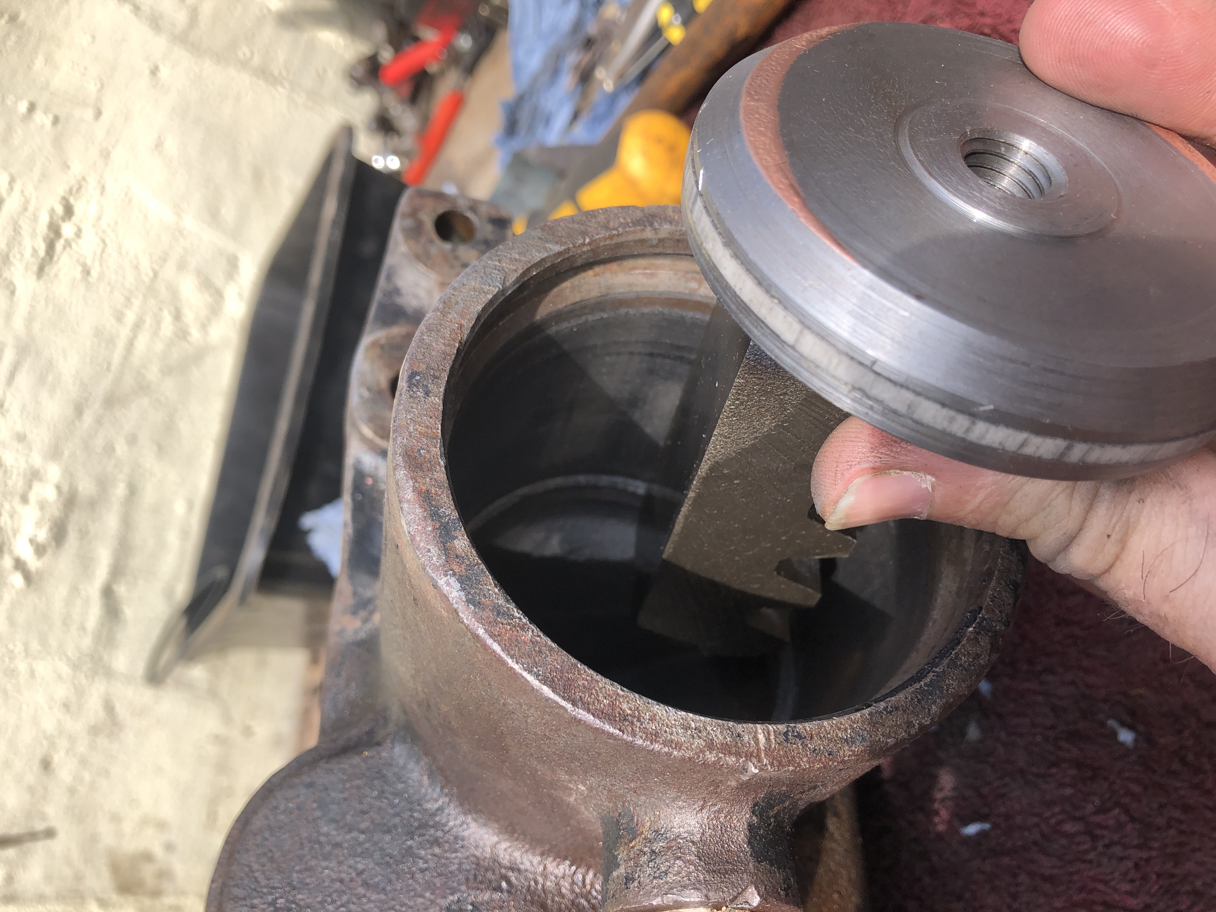

With the shaft out I decided to bite the bullet and remove the cylinder cover, piston and rack as there is a seal inside here. On the end of the cylinder cover there is a large spring ring. To remove this there is a small hole in the out cover which you place a small centre punch and hit it lightly with a hammer. The punch knocks the end of the spring ring out of the groove and with a flat bladed screw driver you can ease the rest of the spring ring out. To remove the cylinder end plate cover it says you pull it out with a pair of pliers. I used a pair of Mole grips as it was quite tight. The cover comes off with the seal which is replaced. Inside is a piston and by inserting a bolt in to the head of the piston you can slide it out of the bore with the rack all attached. There is a small metal domed thrust pad which will fall out. This sits behind the plug screw on the side of the body which is the next thing to remove. There is a small Allen grub screw which you remove which allows you to turn the plug with a large screw driver and remove it. There is a seal on the plug which is replaced.
Looking inside the housing all that is left is the worm shaft which I left in place but further inspection showed where the metal sparkles had come from. There are no fast rotating parts in the mechanism of the steering box just the worm shaft that rotates 3 times from lock to lock, the sector shaft that turns through 45 degrees from lock to lock and the piston which moves two inches from end to end and they are all in a bath of steering fluid so wear should be minimal. On inspecting the Worm, Sector and rack there was literally no wear to be seen but what I did notice was the bottom of the three teeth on the sector shaft had been touching the inside of the steering box causing a slight groove in the casing. This has possibly been caused by an over tightening of the adjusting bolt on the top of the Top cover forcing the sector shaft lower than it should perhaps sit. No damage to the sector shaft as this is hardened steel and the housing of the box is soft cast iron.
