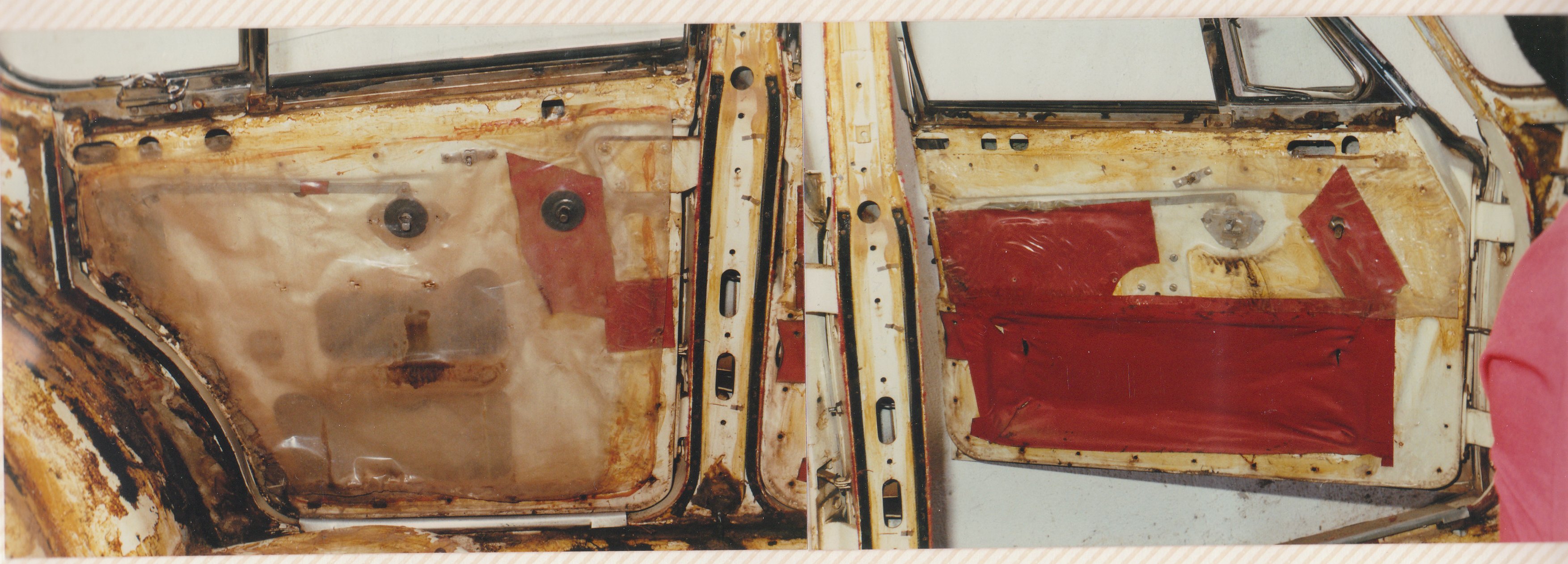

Proper door sealing & door card protection crucial. As Rob correctly observes ~ nevermind how you look at NDV rubber seal replacement it is a job that snowballs into other considerations. It is not a job that is done in isolation.
Original car during stripping.

Trying to catch up on the various threads, I noticed the new plastic sheeting behind the door skin in the pictures, does anybody know where to buy this in the U.K.
I would think is comes on a roll but I have not seen it for sale, I will need it for the rebuild.
Many thanks.

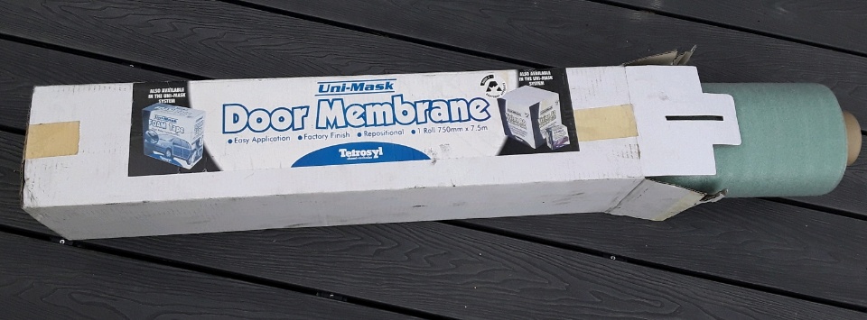

Why not use the correct stuff? This is what I use on doors, available from motor factors or body shop suppliers.
door membrane.jpg (120.28 KiB) Viewed 3377 times
Re: Front NDV/Quarterlight seals.
excellent Nigel.
a membrane is what it is called.
My car still has the original material, I suppose it is the same as you posted, industrial stuff.

This membrane is modern stuff that is self adhesive about 1/8 inch thick and is made of closed cell foam, also acts as a limited sound deadening barrier.
