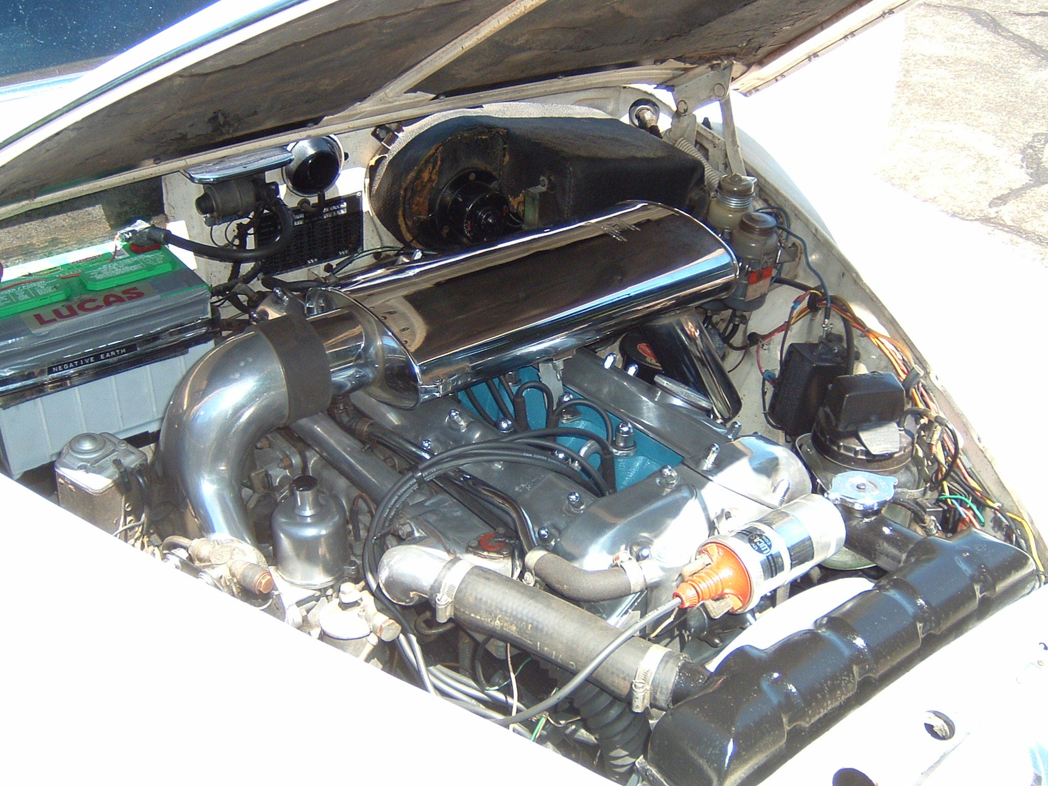

Fluid reservoirs are on on the left side of the engine bay on a LHD car according to mine.

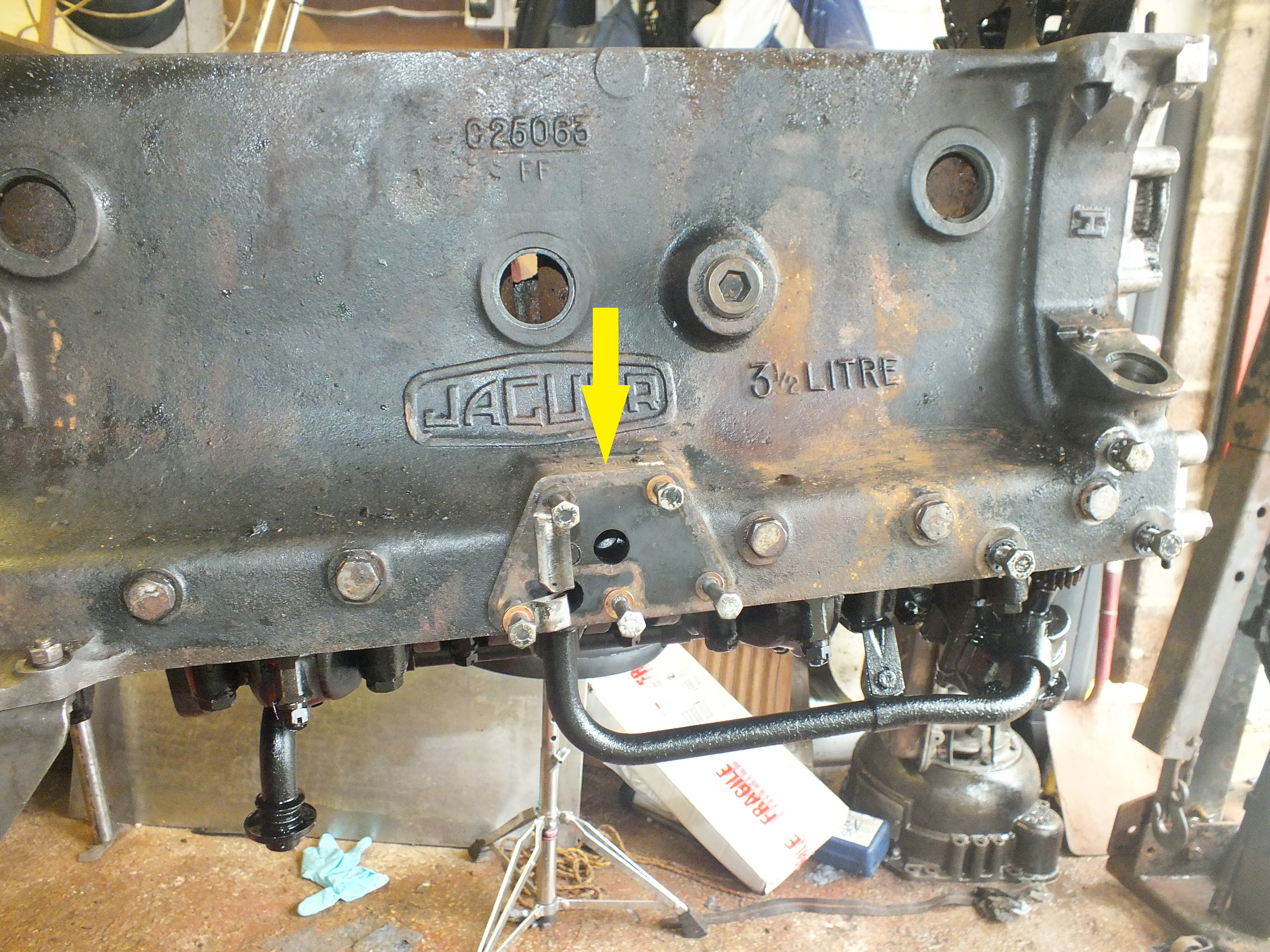

The engine block is marked just below the carburettors with an embossed 3 1/2 litre if a 3.4. Not sure of the exact wording on the 3.8 but it will be different.
The heads are different colours originally. The 3.4s was a Duck egg blue which looks like a light green The 3.8s head is a dark blue or Royal blue. The E Type 3.8 engine head was Gold. These colours can change if someone is trying to fool you though so check the embossed writing on the side of the block. You can see the two colours Duck Egg and Royal blue in the two pictures on page two.

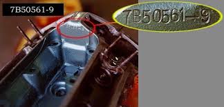

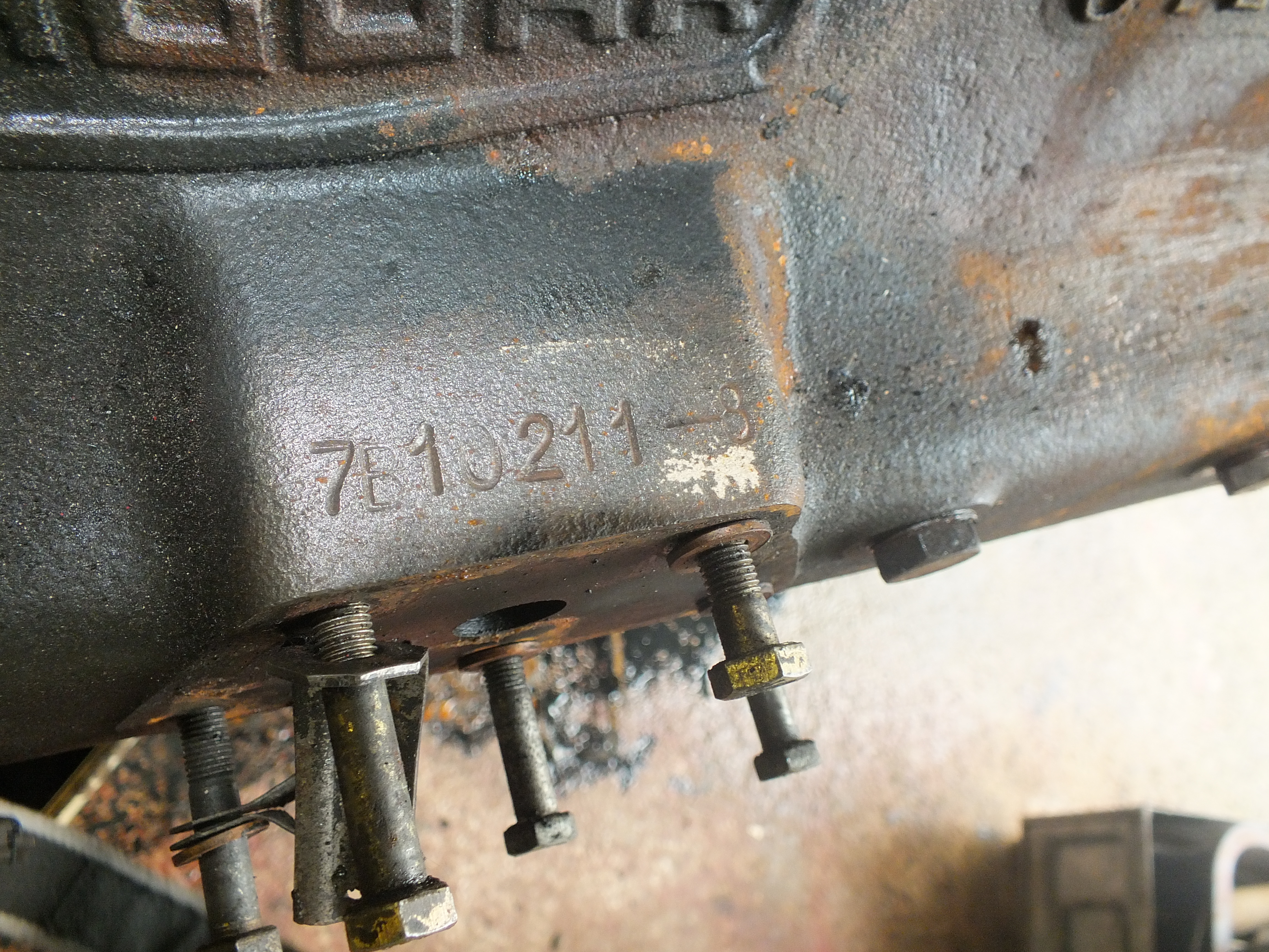

Engine number is stamped here & back of head chaincase. The entire oil filter housing is missing at this stage.

This is the top view Glyn showing the engine number stamped where you have indicated.

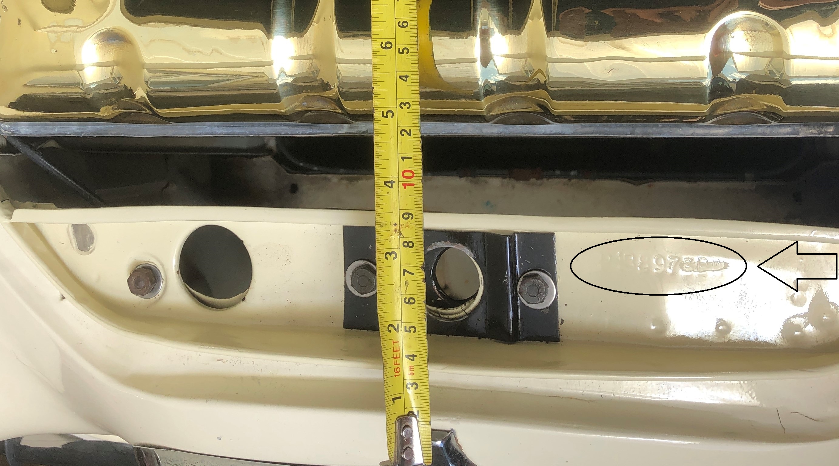

Re: Newby here with some questions please !
This was a photo taken for a different purpose but shows the chassis number stamped into the slam panel just in front of the radiator by the side of the bonnet catch circled in black.
Sometimes this is stamped in as in this case with block letters and numbers other times it is etched in by hand using something like a Dremel.
It is often painted over and difficult to see but it should be there.

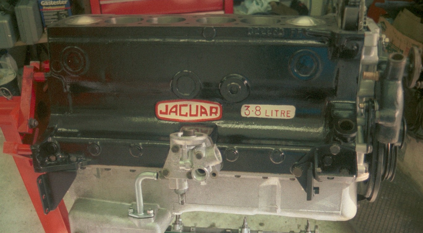

My 3.8 engine block with the 3.8 cast into the block. The difference between the 3.4 and 3.8 are noticeable, I have a spare 3.4 engine that I've fitted a few times and used it to drive coast to cost across the USA and was glad to put the 3.8 back (after a rebuild) when I got it back to the UK as it had more 'go'.
Interesting that they put 3 1/2 on the 3.4 but the full 3.8 on the 3.8.
The 3.4 is actually 3442 cc where as the 3.8 is 3781 cc. Not disputing the sizes but why did Jaguar not call the 3.4 a 3.5 if they marked the engine as 3 1/2?
Was this because of racing homologation perhaps?
My 3.4 which has been rebored with new oversized pistons must be a 3.5 now. I will have to search for a 3.5 boot badge just to confuse everyone.lol.

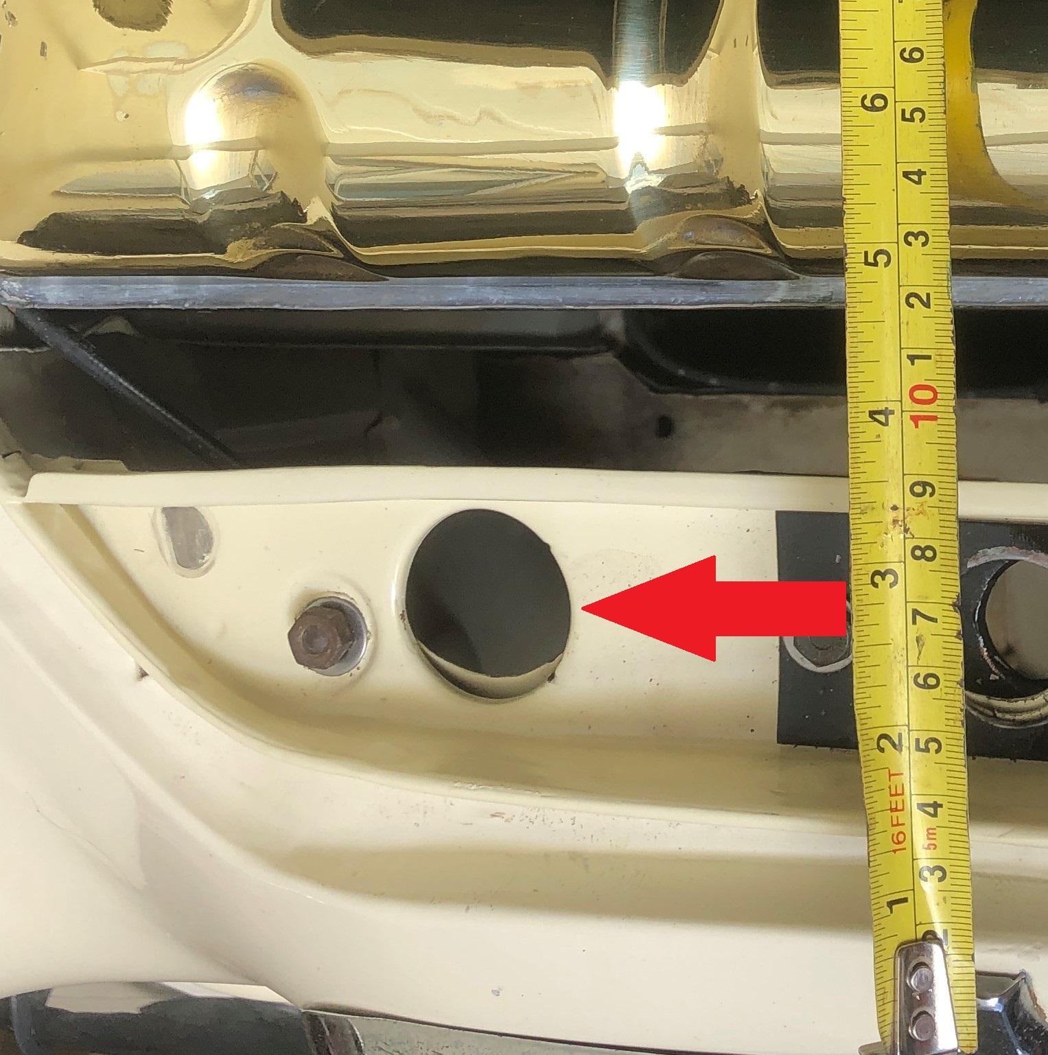

Rob, How do you stop the safety catch from chipping the paint around the hole indicated? Just care?
