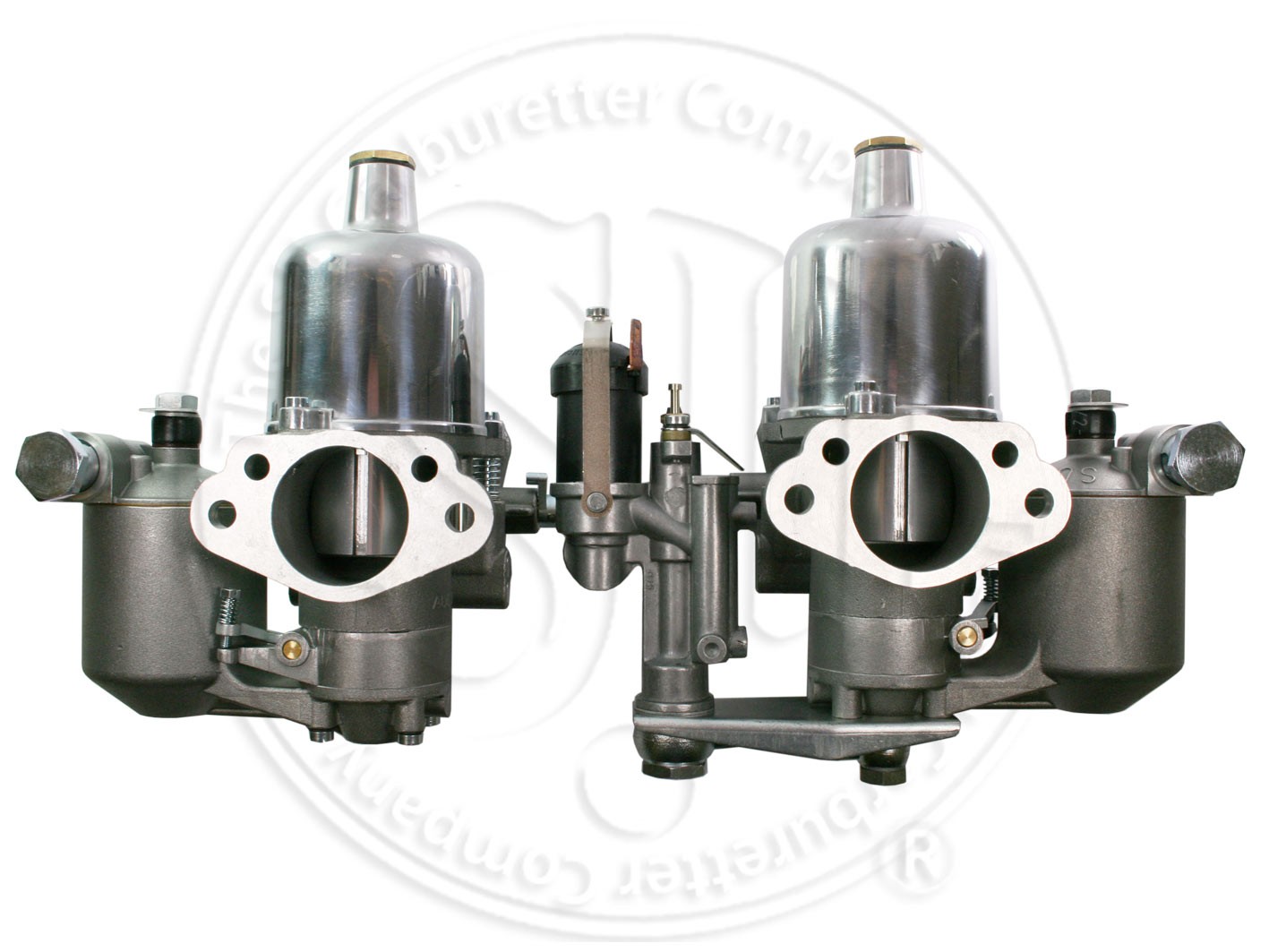

Below is a photo of my bridge piece as I stripped it down the first time. The Banjo bolt is loose but not dismantled at this point. I do not know if this is the original assembly but it shows the alloy washer between the bottom of the carb and the top of the bridge and a fibre washer over the head of the banjo bolt against the base of the bridge.
When I reassembled the carbs though I came across this diagram which shows in colour where the fibre washers and alloy washer goes so I reassembled it to this spec. 42 just says washer which I took to be a fibre washer so I placed fibre washers either side of the alloy washer on the banjo bolt as per the last photo of it reassembled.

I don't think your carbset is original S Type not that it matters. Does your engine number match?
Anyway to assist with Cass excellent pics & try and answer your bridge piece question. Some Thermo carbs had a pipe with banjo fittings on it.

It does look as though your carbs have been messed with if not changed. I noticed in your photo with the red background, if that is a picture of your carbs, that the bridge piece support between the Carb and AED is upside down. Indicated here with the yellow arrow, when compared to mine in the second photo.
Also your float chamber tops are a different design or appear to be. (It might just be the angle of the photo.)
Re: Help with a non-starting 3.8
The pics I show with red background are just plucked from the internet at some time off a Mk2 IIRC. Mine are as yours Rob. I just wanted to show the T piece & rubber pipe arrangement to the OP. The support bracket appears assembled upside down.
The bridgepiece diagram is purely to show that it is purposely reversible.

Thanks once again for the replies. I apologise for attaching the same image of my A.E.D. twice in my earlier response.
Cass: My bridge piece is the same orientation as yours. I was slightly concerned because Glyn had provided some photos, ( intended solely to show the "plumbing" of the A.E.D) which showed the bridge piece rotated through 180 degrees, and I wondered what was the "correct" orientation. This is possibly just academic, as I think it work be fine either way round.
Thank you for the exploded diagram, in colour, you attached. Do you also have the "key" to that photo? I would be grateful for a copy (via a P.M. ?) if you do. Incidentally, your colour diagram shows the "pipe" exiting the A.E.D. vertically downwards, so not meant for an "S" type.
Glyn: I'm sure you're correct, and my A.E.D. set up is not original. My engine number, chassis number etc all tie up with the Heritage Certificate, and the chassis plate. I just hope my interpretation of the fibre washer arrangement is leakproof.

Have to get my two pence worth in here. The aluminum washer goes between the banjo and the cross piece, the fiber washer between the cross piece and the bottom of the front carb. Someone's photo showed the reverse. All washers at the starting carb end are fiber. Apparently, the cross piece can be reversed to change fuel levels in the carbs, however that's possible, but I have never tried that and under what circumstances would you? Come to think of it, maybe that would help with my poor idle problem.
