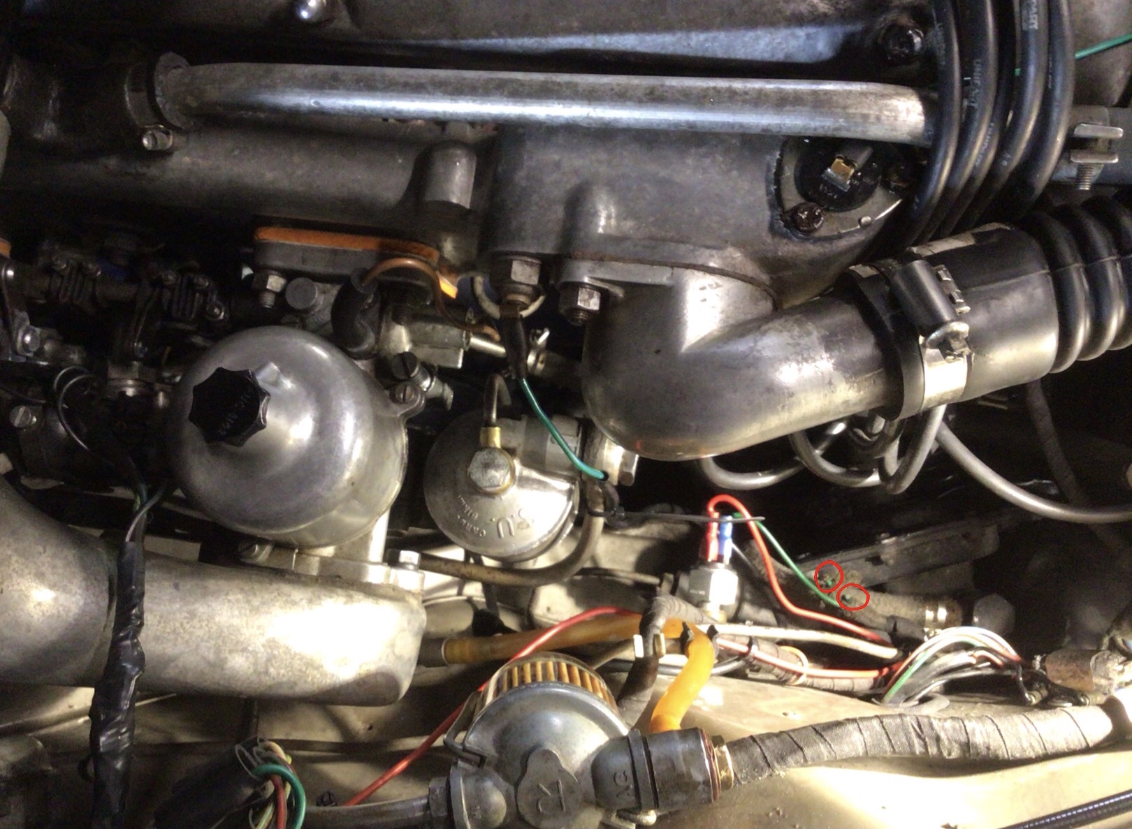

Here is a picture. Have done some checking. Brake switch, the red wire powers the stop light, replacement for original at some point for some reason. Green energized with ignition.
Where the green wire emerges from the harness, there are two green black wires whitch are cut off. Red circkles on pickture. They are not energized with ignition on. Originally to stop ligths, aed?
Have read quit a few posts regarding otter switch / aed. PO have fitted a switch below dash to power aed, with a «on» warning light. I have been fiddling with that switch trying to figure out what it is doing. And I was sure the aed was off with hot engine whether or not the switch was on. Turning switch on/off with cold engine a distinguished difference. Engine need aed/«choke» when cold. «Hissing» sound with switch on.
Turning switch on/off with hot engine - no difference and no hissing sound. So I assumed otter-switch was in operation. However when doing some cheks with engine not running ( cold ): Aed solenoid clicks with switch on / off. Also with jump wire directly from battery. But also operates when I disconnected green black wire ( see pickture ) from otter switch. Understand if otter switch is wired into the circuit, aed should not operate with this wire disconnected? I will check more next time engine is hot.
Rgds Harald.
Rgds Harald.

I will have a look under my bonnet tomorrow but looking at the wiring diagram the only Green/Black wire I can find is for the AED solenoid. My thinking is that if you have a switch on the dash the wiring to the AED might have been altered and the two original wires disconnected.
Down that side of the car there should be wires for the horns, right front lights, AED, coil, Brake warning to the reservoir, Wiper motor. Brake light switch, Oil pressure warning and water temp. I think that is all. The only one of these that is Green/Black is for the AED.
I will investigate tomorrow for you and add some photos of how my wiring runs.

I have had a look down the side of my engine today and as I thought I can only see one Green Black wire that comes from the wiring loom where your cut wires are and this goes to the AED. My thoughts remain that someone had rewired your AED to fit the switch on the dash but have not used the original wiring.
