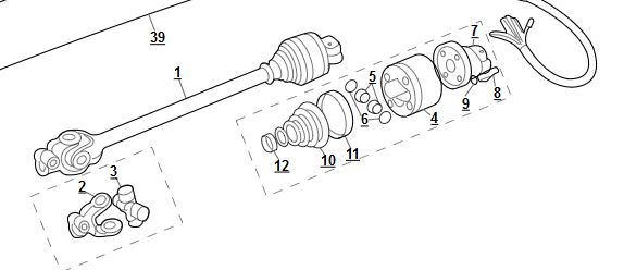

That upper joint under the gaiter on the steering column with the two nylon rollers is actually a simple plunging CV joint. If the rollers wear they can create quite a bit of slop in the steering. They are available & can make a big difference. I had multiple steering columns & they were all shot.

I Know things are never as easy as described in the manual, but to replace the nylon rollers and the UJ joint don't look that bad a job.
Re: Adwest Marles power steering box.
All the parts are readily available including the gaitor. Re-building the joints is a simple job once you have the shaft out of the car. Grease that CV joint with a minimum 3% Moly No 2 grease & it will outlast any of us.
In my case every single bearing, bush, ball joint, tie-rod end etc. was new & the steering box professionally rebuilt. All we had to do was rebuild the steering shaft which was simple.

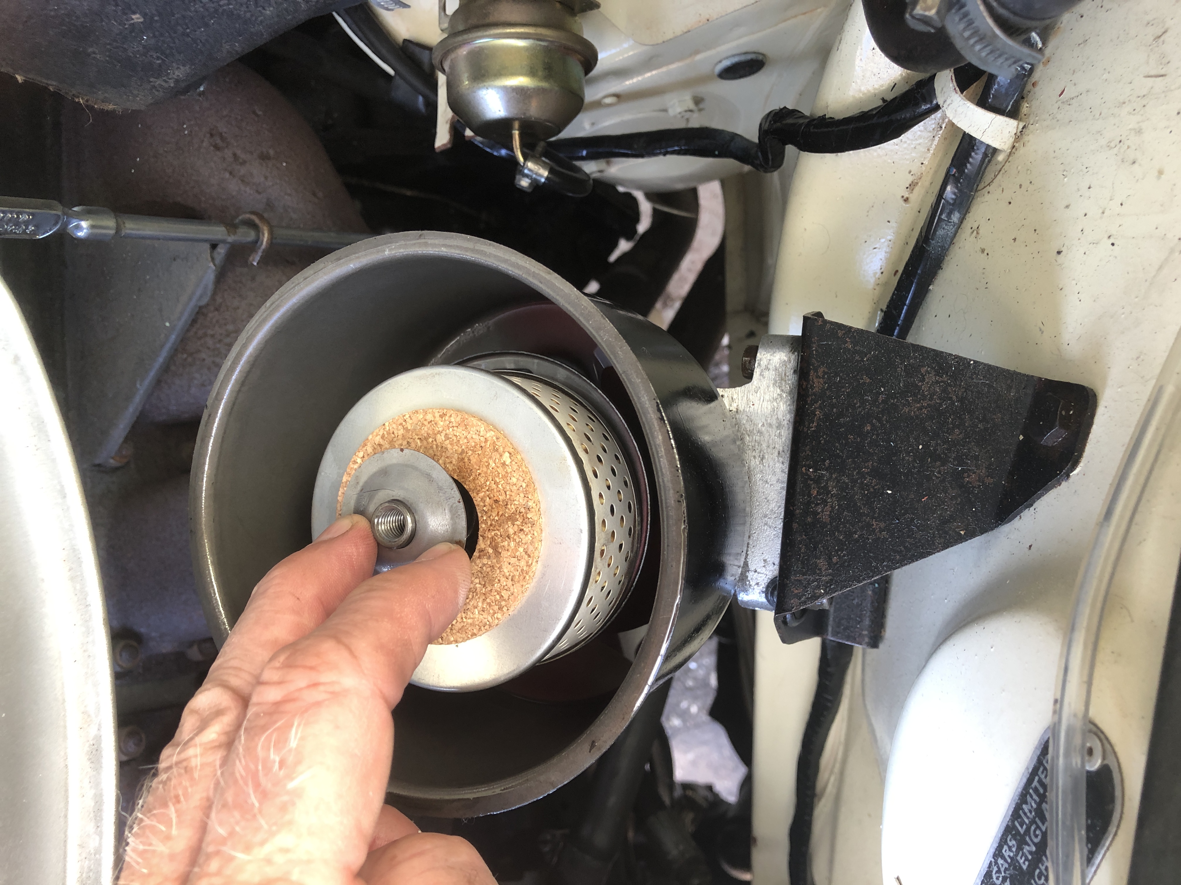

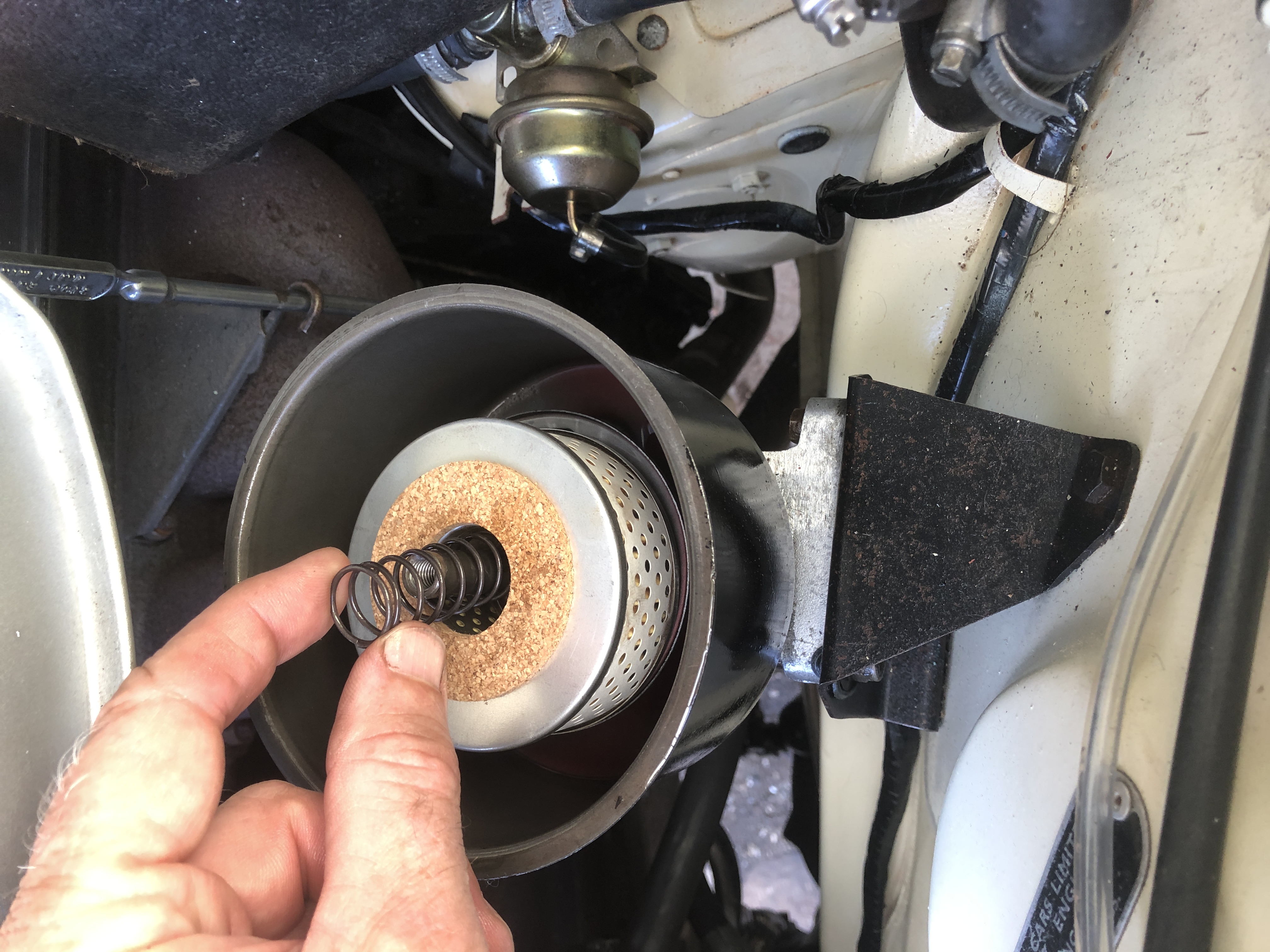

New filter arrived today so I popped the top of the reservoir and removed the old filter and put the new one in. Put the top back on and thought "that does not look right". In the reservoir there is a central spindle that the filter goes over. There is a spring which I had positioned over the spindle inside the filter.
Went back to the reservoir to try and figure this out. If I placed the washer on top of the filter and then the spring on top of the washer, when I put the top on the washer is now compressed between the washer and the lid top forcing the filter down so it seats correctly on the base plate. Question. Is this correct? should there be a spring in the set up as per the parts book or is the parts book wrong?
Anyway filled up the reservoir with fluid and with the ignition off I turned the engine over to prime the pump. Spun the steering wheel over from lock to lock a couple of times and topped up the fluid. Started the engine and again spun the steering wheel from lock to lock and topped up the reservoir. Checked under the car and no leaks that I can see but the real test will be a long run. I just have to find a legal and essential reason to go for a drive now.
A washer then sat on top of the spring.
I started to screw the top back on and thought it was not right and looked in the filler cap at the set up. The spring was pushing the washer up to the underside of the top and when I put a finger in I could move the filter so it was not sealing correctly. Got the blue book out and had a look at the set up and there is no spring in the drawing? Went to the parts manual and again there is no spring mentioned? Went back to the reservoir to try and figure this out. If I placed the washer on top of the filter and then the spring on top of the washer, when I put the top on the washer is now compressed between the washer and the lid top forcing the filter down so it seats correctly on the base plate. Question. Is this correct? should there be a spring in the set up as per the parts book or is the parts book wrong?

Your bottom picture is how mine is installed with spring. Parts book is lacking.
Your centre picture appears to have the washer/spring seat inverted.
Thanks Glyn. I thought the third picture was correct once I had assembled it again as it was just logical to have it this way so the filter was held down securely. It confused me when I looked in the parts book and could not see any mention of the spring.
