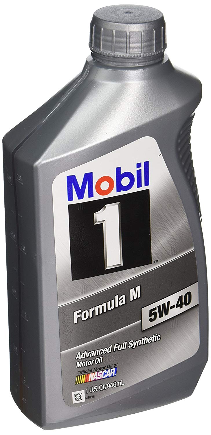

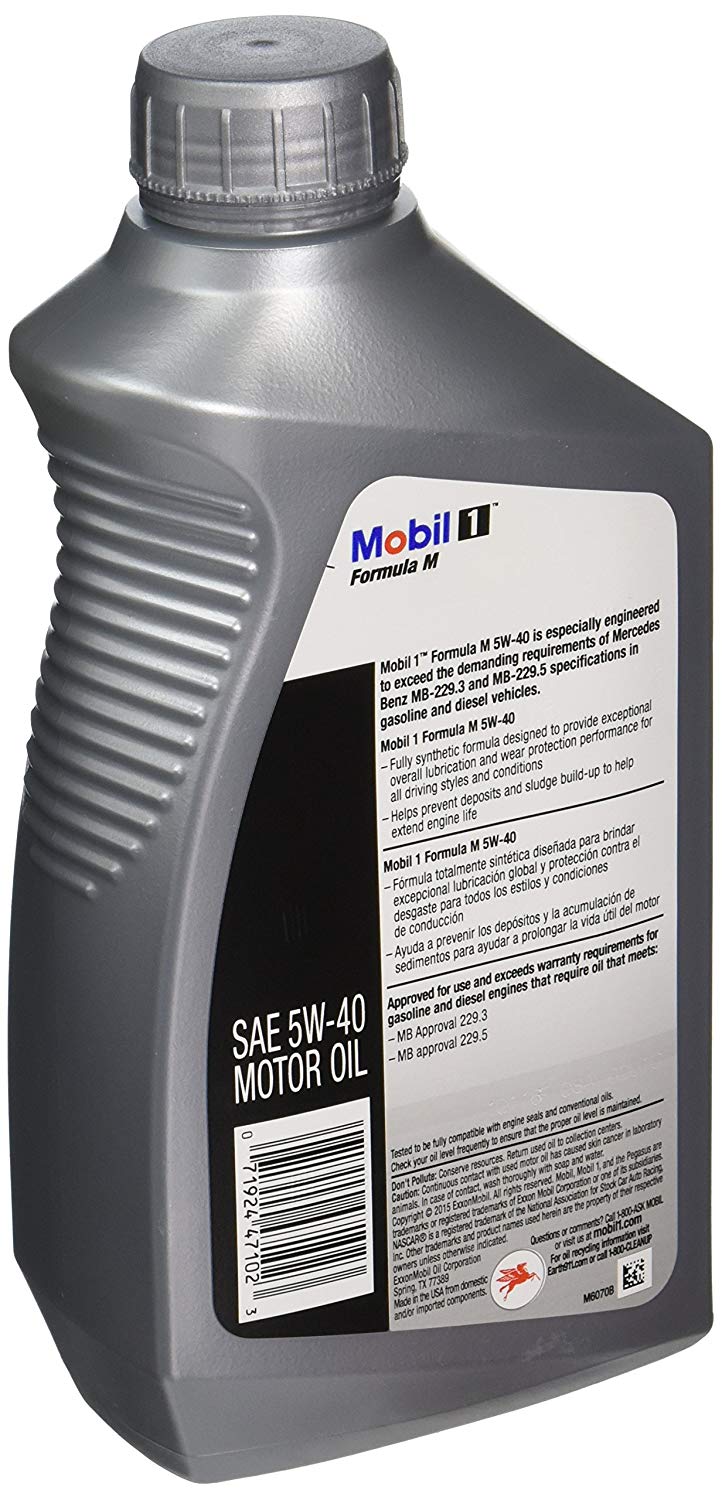

Thanks so much Glyn for the clarification.....In the list from Mercedes, which one of the Mobile One products would you recommend since they are in the U.S.?
Re: Engine Oil
This product was at one time only available via Benz dealers but has now been opened up to certain outlets at vastly more sensible pricing. The US just about gives away engine oil. This product does not sacrifice engine protection for the sake of extending emissions system life.
https://www.mobil.com/English-US/Passen ... ula-M-5W40
https://www.amazon.com/Mobil-1-CASE-5W- ... B00HXILF5Q
Re: Engine Oil
Thanks Glyn.....I like the Mobile 1 product....use to run it in my motor home.
Re: Engine Oil
For me ExxonMobil was the opposition but it is a damn fine product.
