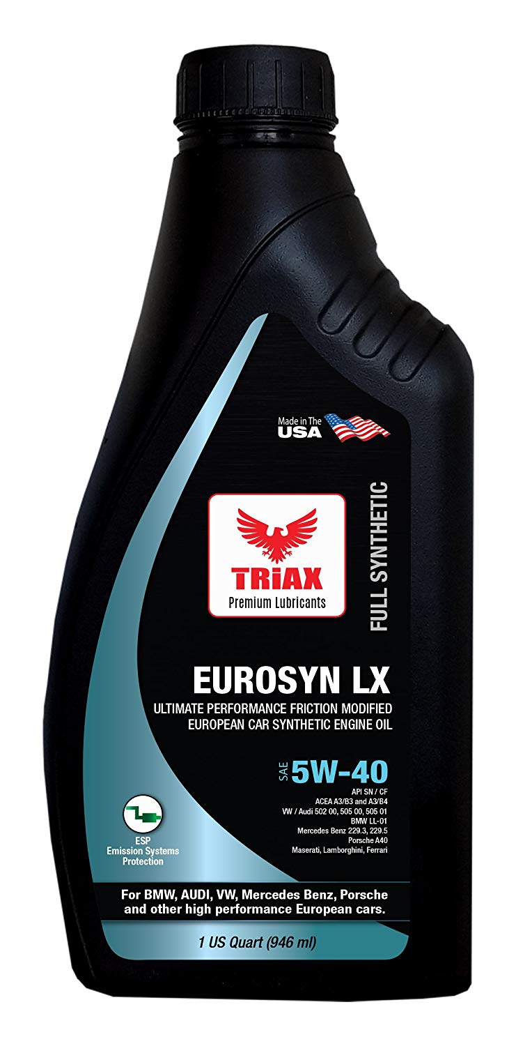

Thanks everyone for their comments.....great info.
To summarize: Full synthetic SAE 5W-40 approved against Mercedes spec 229.5. This looks like a great choice.
Re: Engine Oil
You are on the right track but NO. This product is not approved by Benz. Who is Triax Lubricants? Some boutique blender that has not achieved an approval. Stick to reputable oil company products.
Avoid products that use weasel wording in/on their labels. Most prevalent in the US. Avoid claims like ~ "For" or "Is suitable for" or "Meets the requirements of".
Only use products that state "Approved against Mercedes Benz 229.5" ~ "Holds Mercedes Benz Approval 229.5" etc.
