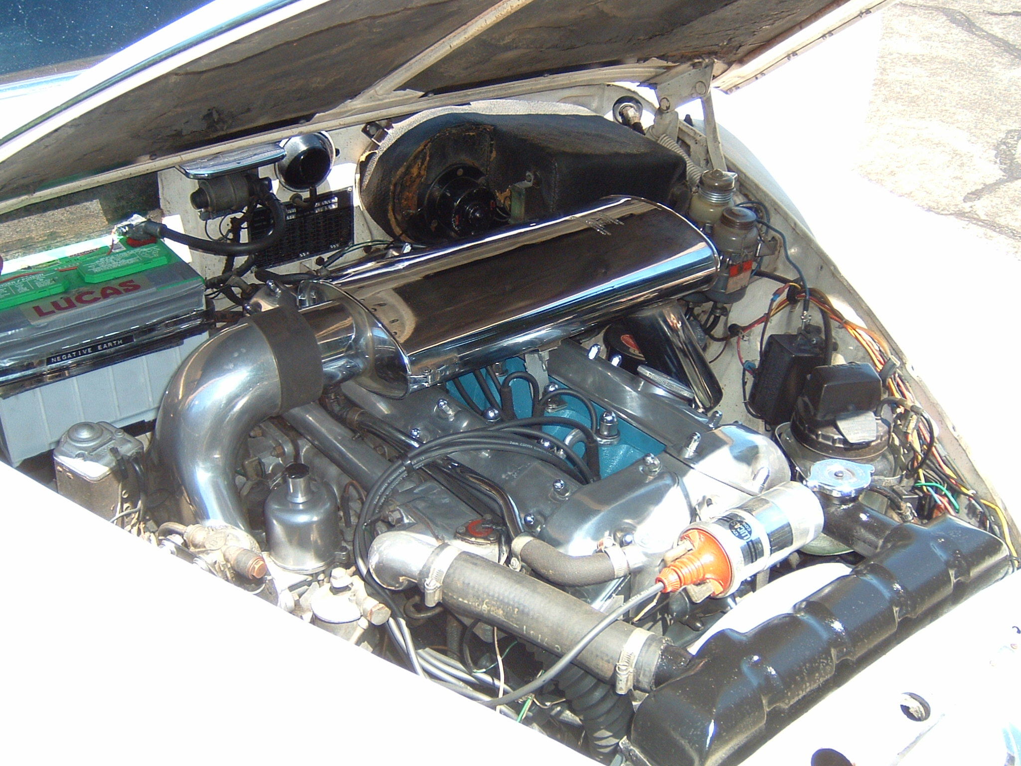

The original bracket is as yours with just a brace between the two to keep it as one piece.
The painted air filter housing makes the engine bay brighter and more interesting rather than the Hammarite grey which tended to blend in with the top of the engine.

Great looking engine bay. Back when chrome plating was relatively cheap I had the large air cleaner and some other miscellaneous brackets chromed for more bling. Yes, I know, not stock.
