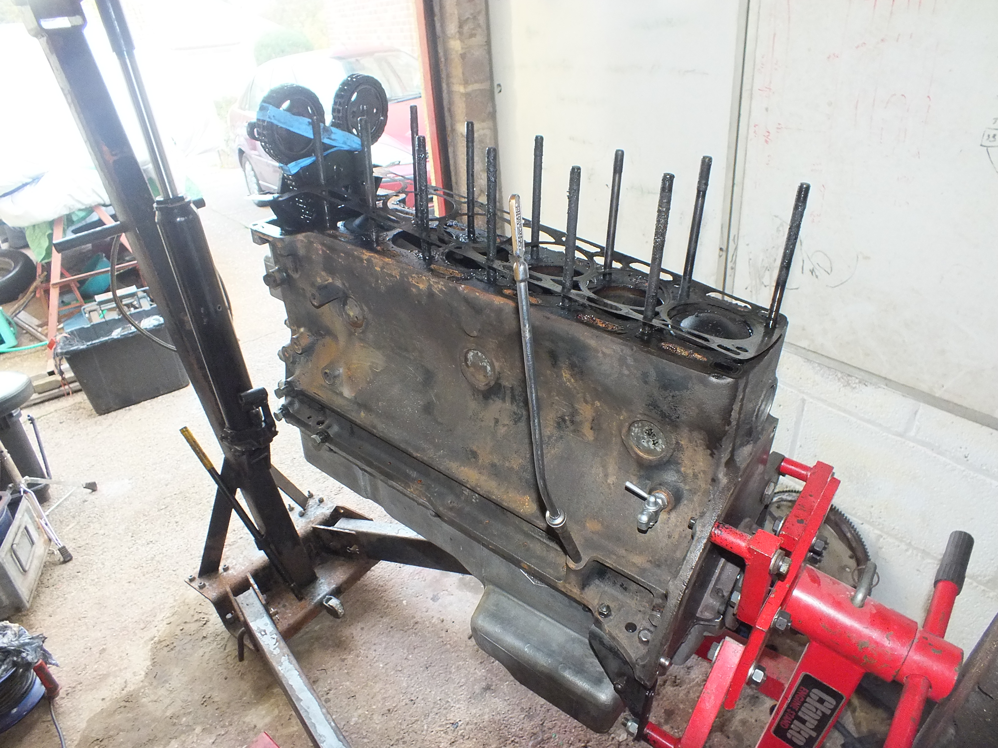

The studs on my 3.4 I reused without any problems when I rebuilt my engine but like you I think it was the first time it had ever been taken apart. The problem you will find with the studs is corrosion. They are made of iron and screw into a cast iron head and if you have an old engine that has blown a head gasket which might not be bad enough to effect the compression but allows water to seep across between the head studs they can become rusted in. Removing them becomes a nightmare and studs can shear off in the block. Then we come to iron head bolts going through an aluminium head and there is a chemical reaction that can occur causing the alloy to fur up and lock the bolts into the head. This then makes the head a real pain to remove and when I removed mine I had to use an engine crane to take the weight of the head on chains and gradually ease the head up off the studs over a couple of hours. One stud came out with the bolt the rest stayed in the block.
If you have removed the head I would then remove the studs from the block to check for corrosion in the threaded area, change the ones that show corrosion or possibly change them all. If they are like you have said clean, shiny and look in good order I would clean out the thread with a suitable tap, ream out the hole in the alloy head and reuse the studs using a decent carbon grease to coat them when refitting the head and in the thread.

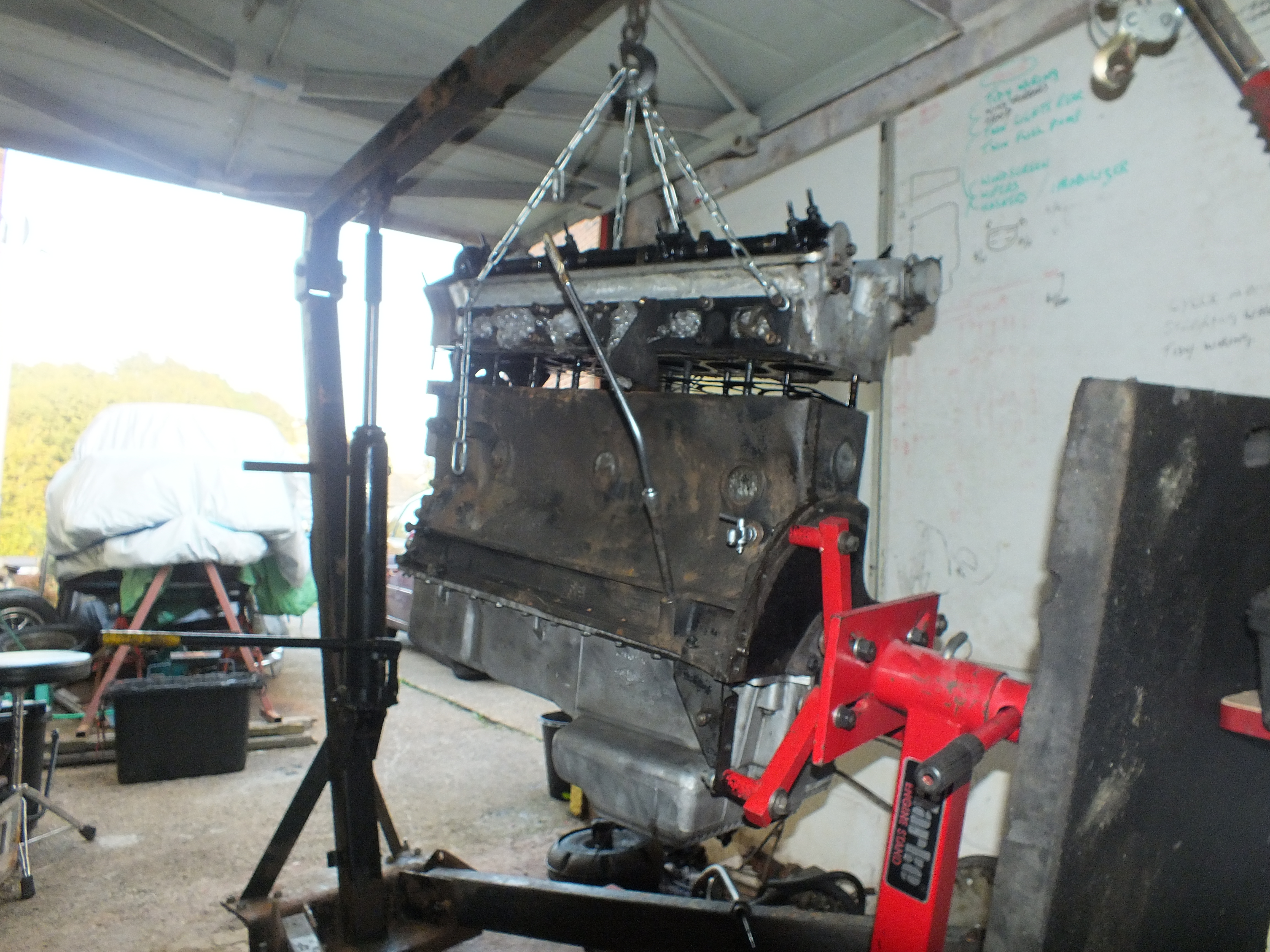

Studs. Of course. Chalk it up to sloppy thinking. I had 2 studs come out with the nuts. I used an engine hoist as well along with a load balancer which I bought for this project. The head came off pretty easily I think, considering all that I was thinking could go wrong. I will mention that I did not, but should have removed the heater box beforehand. It encroaches by about 1/2 inch- well beyond what can reasonably be "jostled past." I read a few posts on that subject and some said to remove, some said dont need to. I suspect that it may have something to do with the condition of the engine mounts, or with the way the body itself was assembled. Im not sure, but I had to. Back to the studs, I will probably remove them as you suggest. I was considering it if only to clean them up and to make cleaning the top surface of the block easier.

I got all but 3 of the head studs out. Those remaining are stuck hard enough that I was concerned they may snap off. They are 3 of the ones that the lifting hooks are on when assembled. I presume that these loops being under the top nuts allowed moisture to get in. I don't see any evidence of failure in the head gasket. I tried the old double nut method to try to twist but no joy. I have elected to leave that can of worms for some later time due to limited finances and completing tasks involving other smaller cans containing fewer worms during this whole endeavour. My parts should be here soon and reassembly will commence shortly....
Re: Head bolts
Heat is your best friend here Jerry. The heat expands the metal breaking the bond of rust between the stud and head. An old trick I was taught years ago was when the stud is hot get a candle and allow the heat of the stud to melt the wax so it runs down into the thread. Allow it to cool a little and then turn the stud out. I use a stud removal tool but it can damage the shaft of the stud as it has a serrated cam cog that bites into the metal. Ok if you are replacing the stud or the damage can be cleaned up so the double nut method is just as good.

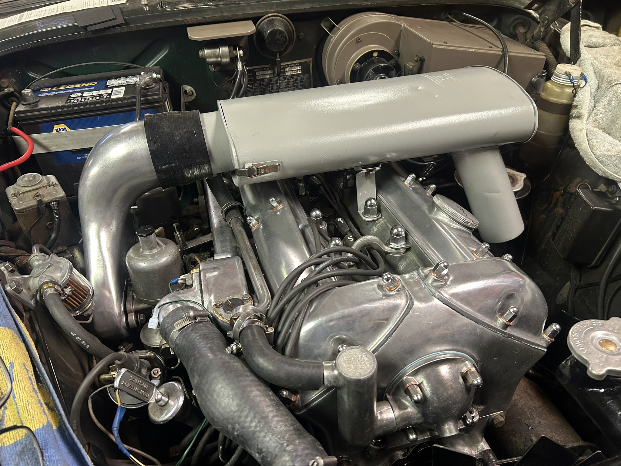

A small thing I wanted to get done during this escapade was to get or make an air filter box bracket. Here is my filter box mocked up. I ended up simply making 2 "C" shapes out of some flat steel stock that I have. It was quite easy and took much longer for the paint to dry than to make them. I also found the silicone sleeve at the head of it on a site called Siliconeintakes.com of all places. Its an excellent fit.
