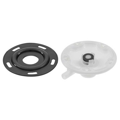

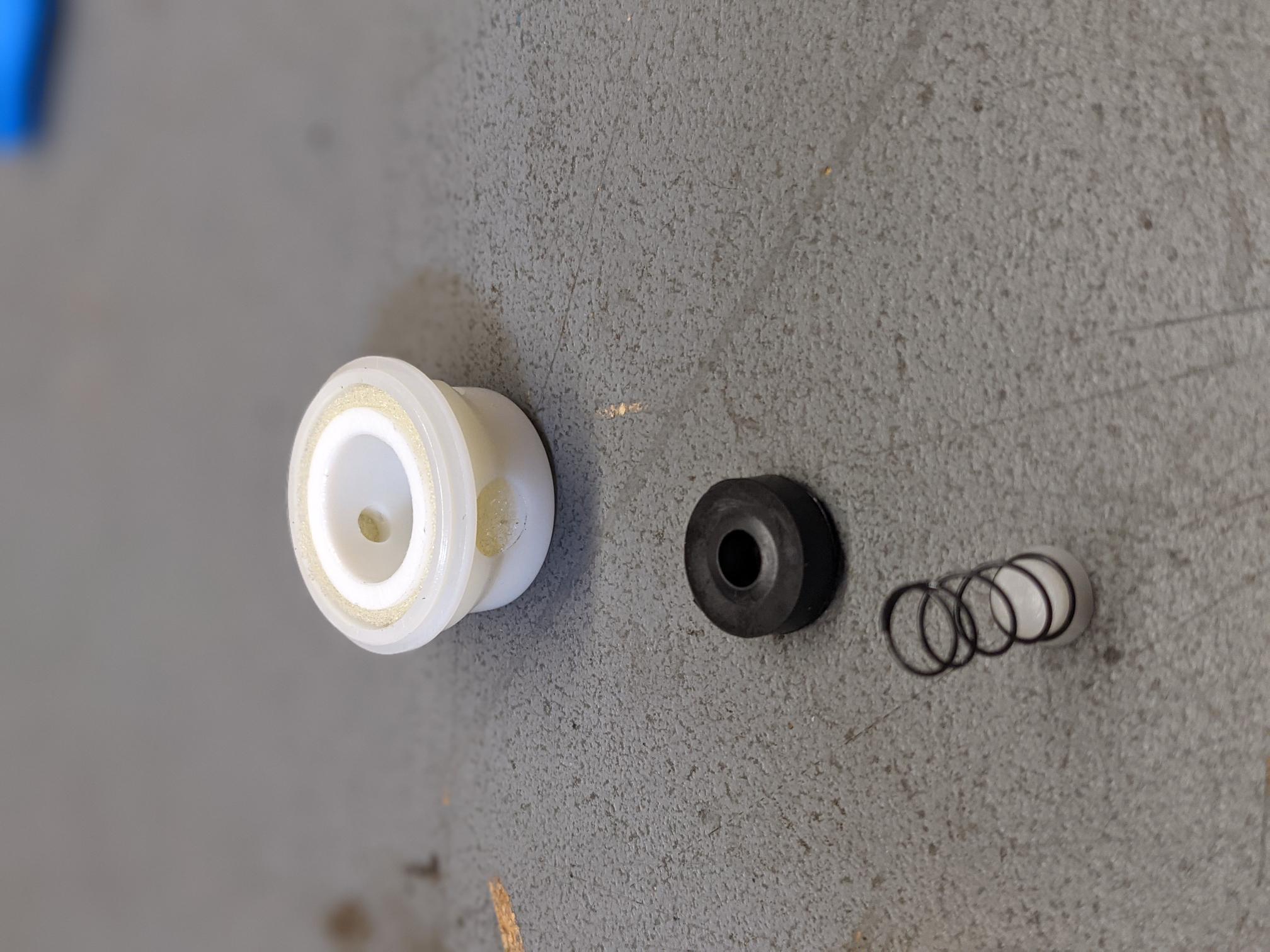

Saw this post and thought I would chime in with my recent experience of the same issue. After a full mechanical rebuild of the car over several years, and upon first startup I discovered a few small vacuum leaks on valves and diaphragms. Once I had a functioning vacuum system with both Reservacs and all diaphragms holding vacuum I had complete lockup on the brakes and a pedal that felt like a brick. After some tracing I realized I was missing the small spring that regulates vacuum pressure on the servo reaction vacuum. Turns out I had inadvertently knocked of the white plastic protective cap on the brake servo reaction valve when installing the engine last year and had pushed the plastic cover back on minus spring in all the excitement of getting the engine/gearbox back in situ after 10 years. With a new spring installed from a Moss Motors rebuild kit (182-291) all was well and brake pressure was normal. May well not be the exact problem on your car but hopefully helps narrow down the options.

Forgot to post image of the reaction valve rebuild kit...

My brake problem was completely self induced of course having misplaced the spring initially, then forgetting about it a year or so later.

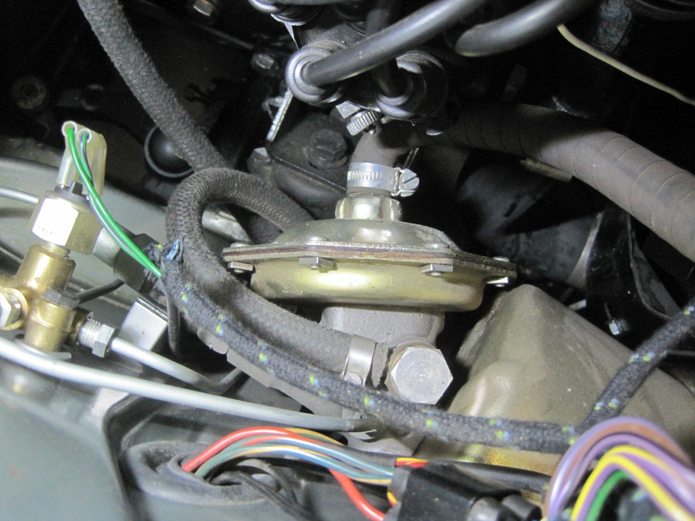

Giles, thanks for your interesting comments. Your locked up brakes and hard pedal sounds exactly like my condition although your servo has a different air valve, I guess you call it. The one on my servo vents via a hose to a filter head next to the radiator. Since my brakes unlocked after I rapped on the valve body, I suspect something is going on inside, maybe a stuck valve. Parts are available to rebuild that assembly. Anyone try that?

It would seem you have narrowed down the issue to the Servo & peripherals. It's likely the Vacuum/Atmospheric pressure control valve that your remote filter connects to with your model servo. If you can get parts rebuild it. I hope it's nothing deeper in the Servo. Check the vacuum system for leaks. I've got a Barratts rebuild/exchange unit on my car ~ 8 inch with integral filter. They do a beautiful job. Not criticism ~ please ~ but you need to use that car a little more often. 10 miles in 8 years is not sufficient.
Rock hard pedal that does not soften on start up is typical Servo & related as I mentioned earlier.
Change your brake fluid ~ DOT 4 or DOT4+ ~ Bleed/flush from longest line to shortest line.
