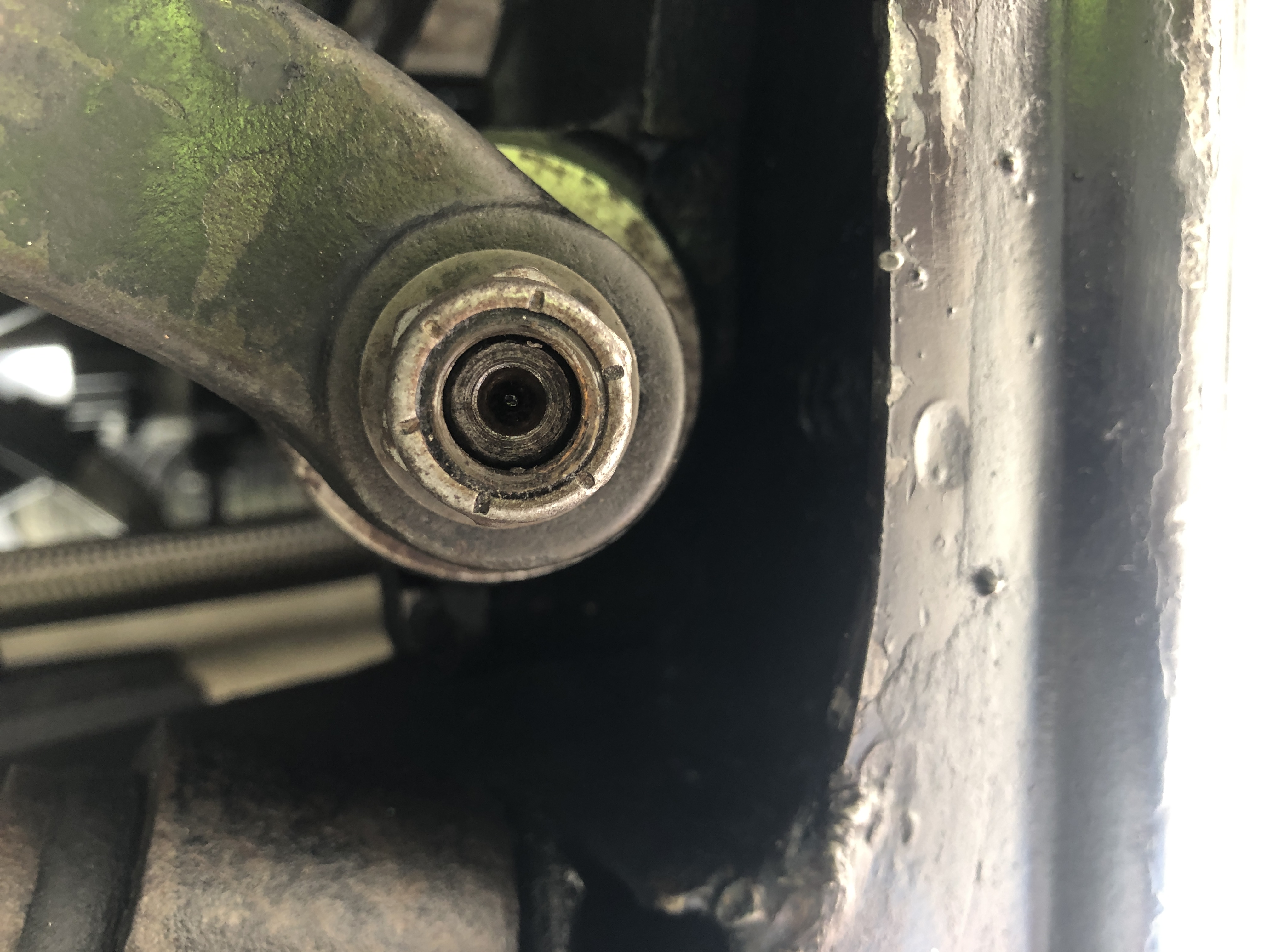

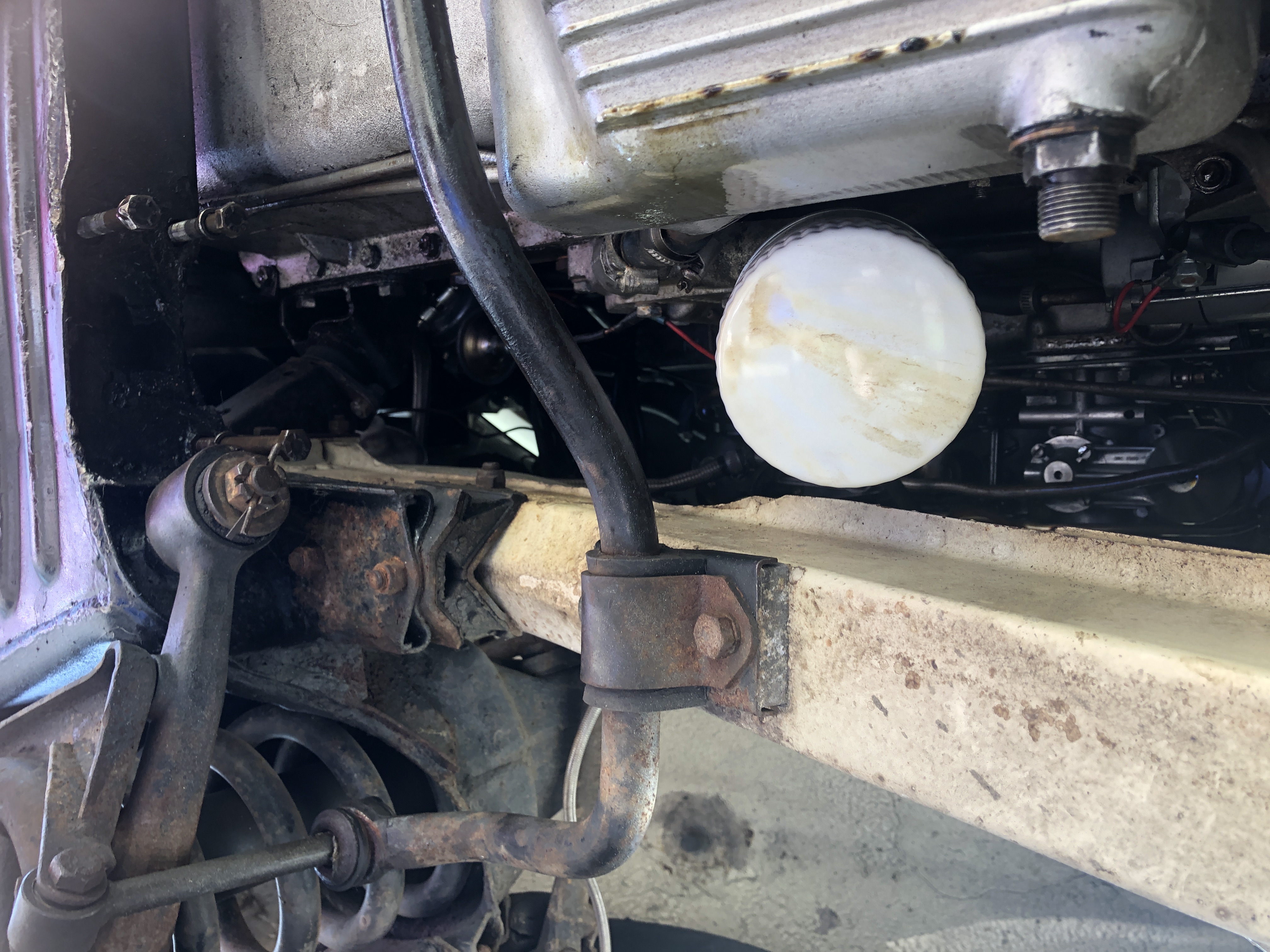

Today the Adwest Marles PAS box went back in. Again do not believe what the manual says there is a lot more work involved.
First the box is offered up in to the cut out section on the cross member which you can see in this photo. You can also see there are four bolt holes on the cross member but there are only three bolts holding the Adwest box in place. The fourth hole, top left, is for when the previous Burman box was fitted to the S Type but they are using the same crossmember for this Adwest box. Sorry this picture is upside down but for some reason it will not let me set the orientation correctly. The steering box cannot be feed into position with the lower steering column attached or the drop arm unless you want to remove both the anti roll bar and the oil filter. You will note in my case I have changed my original oil filter to a spinoff system which is actually smaller than the original. Once the steering box is in place (be careful as it is very heavy) tighten the three bolts to secure it in place. Next attach the hydraulic pipes to the steering box and the feed pipe and secure these to the cross member. Attach the drop arm getting the orientation correct using the previously mentioned punch holes I made as a reference and cinch the nut up. Next I attached the steering arms, this was so I could check the dead ahead position of the steering box to the dead ahead position of the wheels. I found that trying to tighten up both the tie rod nuts was difficult as they have a locknut and as soon as the nylon part of the locknut hit the thread the tie rod started to rotate and would not tighten. On modern cars you find they have got over this by having an Allen key hex in the centre of the bolt into which you can insert an Allen key to stop the rotation. Not thought of in the 1960s so it was a problem. I got around this by taking my angle grinder with a 1mm cutting disc and I cut a groove in the end of the bolt. I was now able to use a ring spanner on the nut whilst holding the bolt still with a screw driver. With the tie rods tight I checked the orientation of the front wheels in relation to the centering of the steering box and all was well. The lower steering column was ready to be offered up but before doing so I removed the pinch bolts and used a screw driver and hammer to open up the gap in the splines so the ends would slide more easily over the upper steering column and the steering box splines. The area you are working in is very restricted so having the splines slide over one another is esential. The lower column was then feed through the small gap between the oil filter and bulkhead and slid on to the steering box splines making sure that the splines matched up so the pinch bolt could slide in to place. The lower column has two U/Js and the orientation of the lower column is that the small end sits on the steering box whilst the larger round end with the rubber gaiter goes at the top and connects to the upper steering column. With the lower steering column connected to the box I had to use the Jaguar special tool called “ WIFE” to sit in the driver’s seat and to hold the steering wheel straight. When asked the “WIFE” pushed the upper column down to slide the splines together whilst I lay under the car and directed them in to place. Again emphasis must be placed on getting the splines lined up so the pinch bolt slides in to its groove correctly. Once satisfied that the system was all aligned correctly I tightened the pinch bolts then reattached the upper steering column to the underside of the dash and the bulkhead plate. Finally I checked all the nuts and bolts were tight under the car and ran a test by turning the steering wheel from lock to lock.

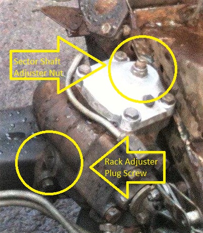

On the Adwest steering box there are two methods of adjustment. Bearing in mind most of the steering boxes in our cars are now over 50 years old and possibly never been serviced in their lives, so will have a little play in them. The first adjuster on the Adwest is on top of the aluminium top cover and is a lock nut over a threaded bolt with a slot cut in it. The threaded bolt is attached to the Sector shaft and adjusts its connection with the worm drive. By undoing the lock nut and screwing down the slotted thread into the aluminium top cover you are making the sector shaft which has a metal wheel about the size of a roller skate wheel move down into the worm drive getting rid of any sideways movement caused by wear over the years of use. Too tight and it will affect the self centering of the steering wheel. Too loose and there will be movement between the two parts causing a vagueness or wandering in the steering. The blue book talks about 4 ft lbs of torque but how you attach a torque wrench to a screw head is beyond me so I did it by the other method suggested which is "By feel". This adjustment can be made whilst the steering box is in situ.
The second adjustment is between the three teeth on the sector shaft and the three teeth on the rack which is moved by the PAS piston. On the side of the box there is a large plug with a cross head screwdriver groove in it. This plug is held secure by a small Allen key grub screw. Under the plug there is a dome shaped metal friction pad which is used to push the teeth of the rack tighter against the teeth of the sector drive shaft eliminating any gap caused by wear. By screwing this plug screw down you can "feel" the slackness being taken up. Over tighten and you will feel the steering going tight so again by feel you can get the correct balance. This adjustment cannot be made with the box in situ as the plug is down the side of the box, between the box and the sump and you cannot access it in situ.
Details of both these adjustments can be found on page 203 of the Jaguar 420 workshop manual which I am hoping David will add to the S Type Maintenance documents above soon as the S Type workshop manual only covers the Burman types 1 and 2 PAS system. There is an adjustment that can be made to the Burman box but it involves using shims and can be found on page I.39 of the S Type workshop Manual.
