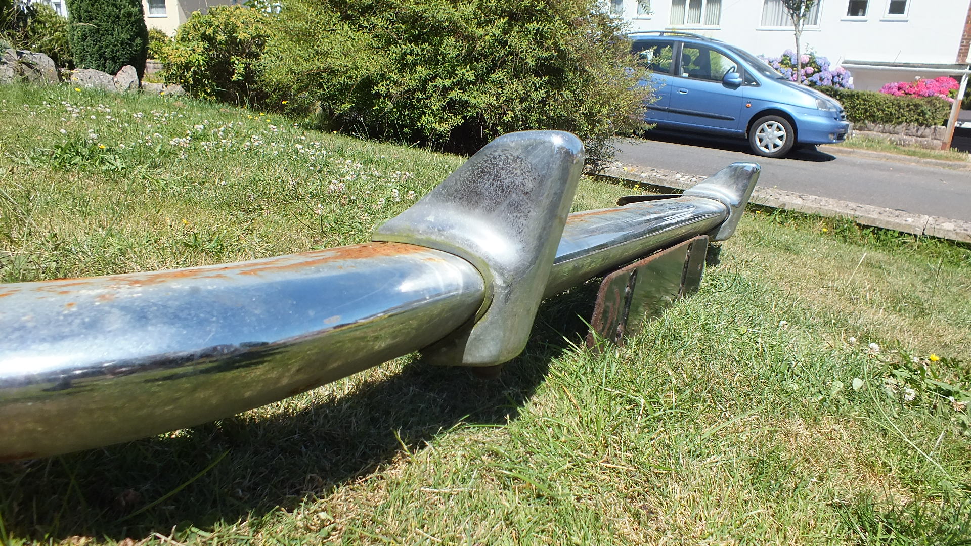

This post is interesting as, for some time, I have been concerned that my front bumper over riders are incorrect. I have never seen them on another S-type. Perhaps they are so wrong that they come from a completely different make of car, though somebody recently told me that the 420 had these "at one stage" (again, I can't find any pics of 420s with these sloped over riders).
Any thoughts?

Those front over riders are either XJ6 Mk1 or MkX/420G
Re: Rear Bumper over rider.

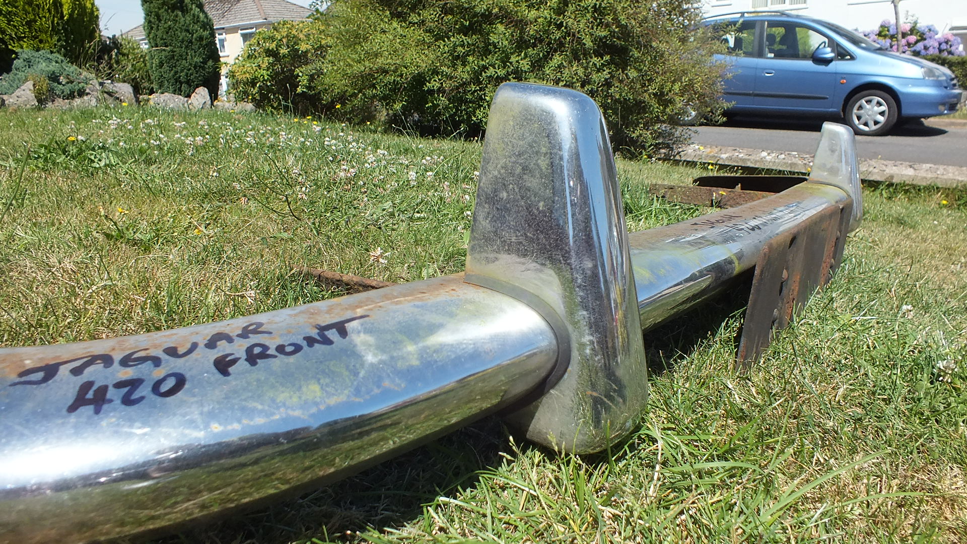

I think you will find that your over riders come from a Jaguar 420G or Mk10. The little 420 had the same over riders as the S Type although the bumper was straight unlike the S Type or 240/340 front bumper that had the scoop to go under the grill. I have attached some photos of the 420 front bumper and 420G. Your over rider is definitely like the 420G.These photos were taken of a set of bumpers that I sent the Harrington group to copy in stainless steel.
This is the little 420 front bumper. This is the larger 420G Mk10 front bumper.

Rob ~ we posted over one another. See above. When I see your pic I'm more inclined toward XJ6 Mk1

And we both came up with the same answer. Well done Glyn.
