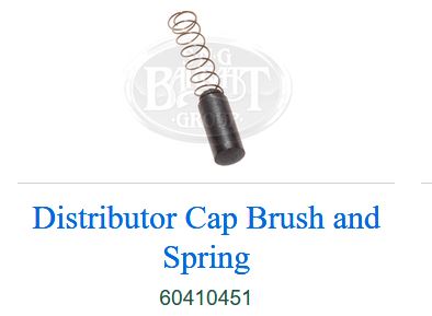

Is the centre brush in your distributor cap making contact with the rotor? Seems not. The spring behind it might also have given up or the "brush" is simply worn out. They cost about $11 because no one wants to make them any longer. I would just buy a new distributor cap. Cost between $15 & $50 depending on whose name you want on the thing. Most come out of the same plant. Comes with new brush & spring. You are losing spark between the coil/distributor cap centre & the rotor.

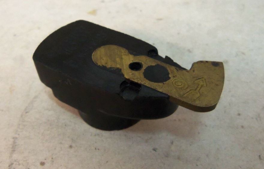

I hope you are using the uprated red distributor rotor available from Moss or the Distributor Doctor. The older after market black ones do short out suddenly from the contact arm rivet to the clip that holds it to the distributor cam and leave you stranded. I had two instances of failures of the black one before I learned of this common issue.
Re: Distributor issue ???
This is the correct rotor. No stud. Ultrasonic welded well away from the distributor shaft. Distributor Doctor red Rotors are also OK. Direct copy of the real thing. Excuse/ignore my decision to move away from points. I hate the damn things & setting dwell angle. Pertronix unit available both Positive & Negative earth.

New cap ordered and managed to source the red Bosch rotor for $2.00 (clearance sale), so ordered 2, must be the Scottish in me !!

Just make sure that it is the correct rotor for a Lucas distributor cap or it will either smash the cap or have too large a gap to jump to the cap contacts.
I always thought that this had been standardised in the industry until I learnt to my cost this was not so & destroyed a cap on one of my Alfa's as a kid.
This might now have been standardised in the intervening time & my comment outdated.

Good news. So it was the brush & spring in the center of the cap. Makes all the sense in the world.
