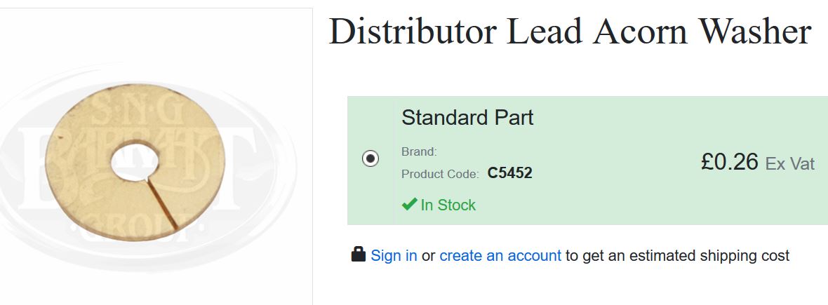

This is the genuine Jaguar HT lead set I have fitted to my car but fitted with Champion bowtie plug caps which screw into the leads. Supplied with the set.
This is the correct termination for the leads with Acorn nuts & split brass washers. I have no issues at all.

Ah! I see the washer with the strands. That seems much more secure as the nut would then have something to hold. Since mine do not, I have put a wrap of electrical tape around the end of the wire to increase its circumference. This only "sort of" works.
Re: distributor cap swap
Yes. The split washer acts as a slight spring washer & keeps everything tight.
